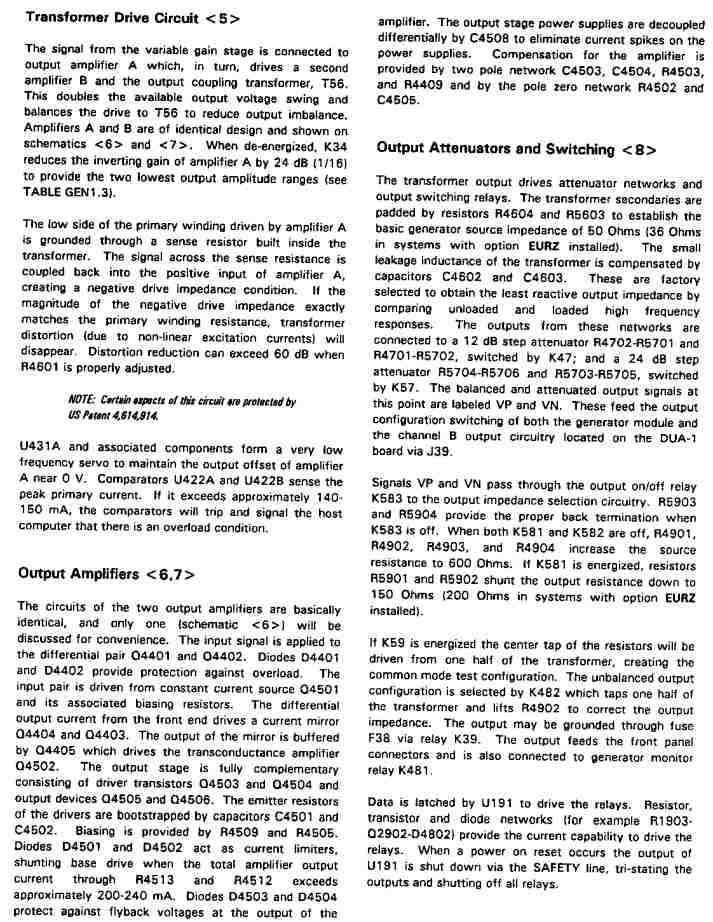

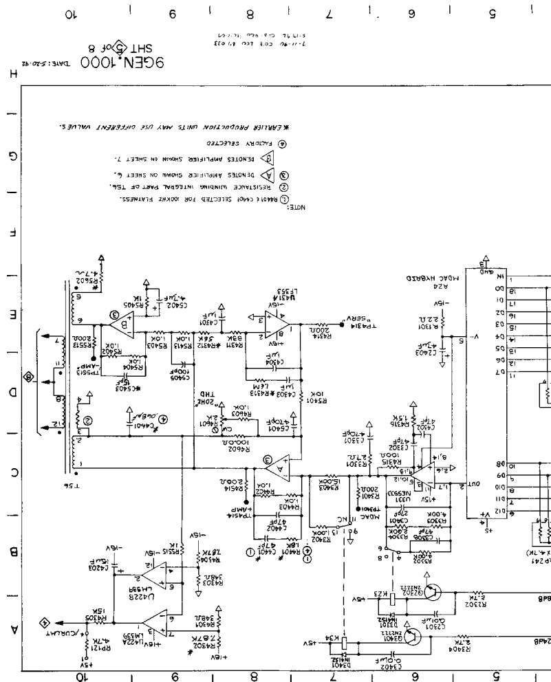

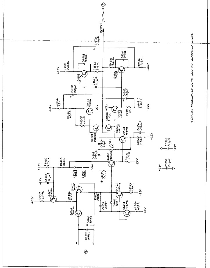

Anyway, Dimitri partly beat me to it, but here's what AP says: these are the amps A & B that drive the xformer.
Jan Didden

It would be interesting if the Jensen transformers suffer from this problem, what about other transformer manufacturers?
It's the nature of the core material itself, John. Not who makes the transformer.
Didn't you see the graph posted by dimitri showing the curves for M6, 49% nickel and 84% nickel? It's a result of the core material's hysteresis.
Here's the same graph of the CineMag CMMI-2C which is also a 1:2 microphone step-up transformer:
Does negative Z drive fix this problem?
Yes.
