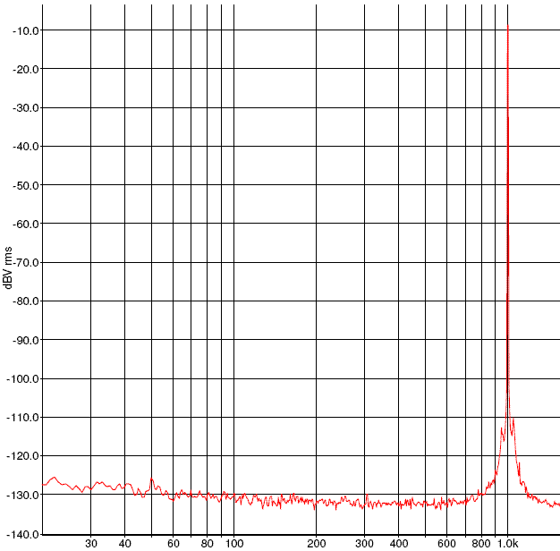

Steve, fizz, jlsem, do you guys remember the spectra I showed in my Heretical article? The thru-preamp (JT-11P1 input transformer) spectrum was noticeably cleaner than the loopback. Ground isolation, CMR, and maybe a bit of useful bandwidth-limiting (100kHz) can all be positives. The 1V level at these impedances is a sweet spot for transformers.
SY said:do you guys remember the spectra I showed in my Heretical article? The thru-preamp (JT-11P1 input transformer) spectrum was noticeably cleaner than the loopback. Ground isolation, CMR, and maybe a bit of useful bandwidth-limiting (100kHz) can all be positives.
This is no surprise when compared to SE loopback, and limited to 100kHz. Have you also tried exactly balanced input for loopback spectrum?
PMA said:There are signal transformers that perform well in RFI frequency range (like Mini-Circuits), but they do not transfer much in audio band.
Yes. But consider why that is the case.

Lumanauw, please read Jensen application notes. It is not possible to explain every trivial issue. Or chapter 6 of Walts lectures.
john curl said:For the record, transformers INCREASE in low frequency distortion at lower levels. EVEN JENSEN.
Yeah?
Here's a plot of THD+N versus frequency at fixed levels for the Jensen JT-11P-1:
Admittedly my eyes aren't what they used to be, but I see low frequency distortion decreasing at lower levels.
What do you see, John?
They saturate at high levels, and HAVE to be driven in a special way to remain low distortion in general. Did you know this, STEVE?
"Driven in a special way"? Just what "special way" is that, John?
