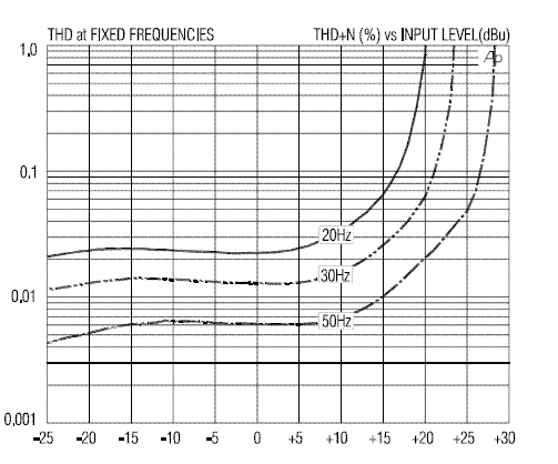

Steve seems to be silent. He has been shown low level distortion and special drive and its result.
Actually you have to look at .05-.1V to see the RISE in low frequency distortion with lower level. Can you do that? Also, if you go to the data sheet of the JT-11P1. On page two you will see what I mean in the graph of thd vs input level at 20Hz and -15dB, 0dB being +4dbu.

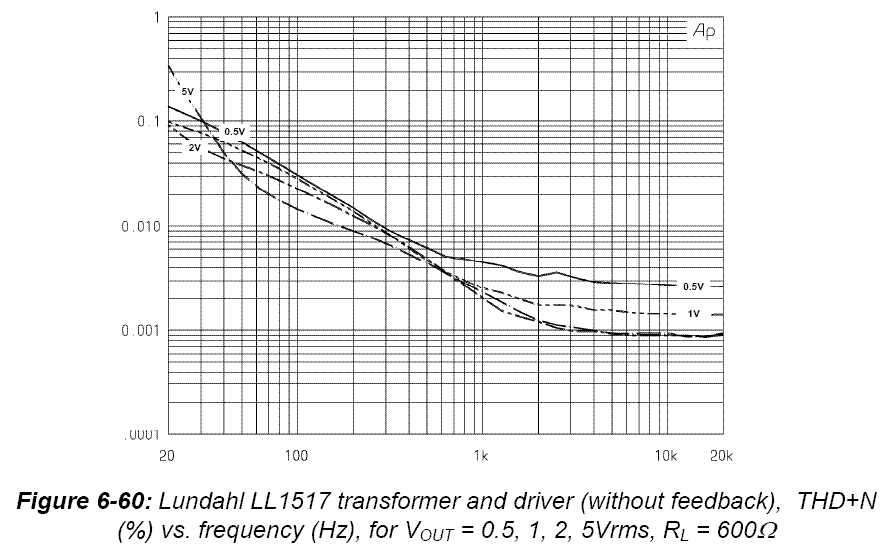

This is no surprise when compared to SE loopback, and limited to 100kHz. Have you also tried exactly balanced input for loopback spectrum?
Yes. The difference isn't as dramatic, for sure. But I don't have any balanced music sources nor do most other people. I don't find the difference at line level through reasonable interconnect lengths to be that important.
Steve, language difficulties. "At lower levels" is different than "with lower levels," but yeah, it can be taken both ways. The nice thing about the input transfomer for preamp use is that the LF distortion at (say) 6dBV is still something like 0.02% at 20 Hz, nearly all third harmonic. I wish my subwoofers were that good. And as PMA hints, with no fuss or bother, both balanced and unbalanced sources can be accommodated.

Good work, PMA. I have seen 'worse' from Jensen, but they don't appear to publish those results anymore. Deane, himself, was a pretty open and honest guy, in my opinion. These are uncomfortable disclosures for any manufacturer, and apparently they have gotten lost.

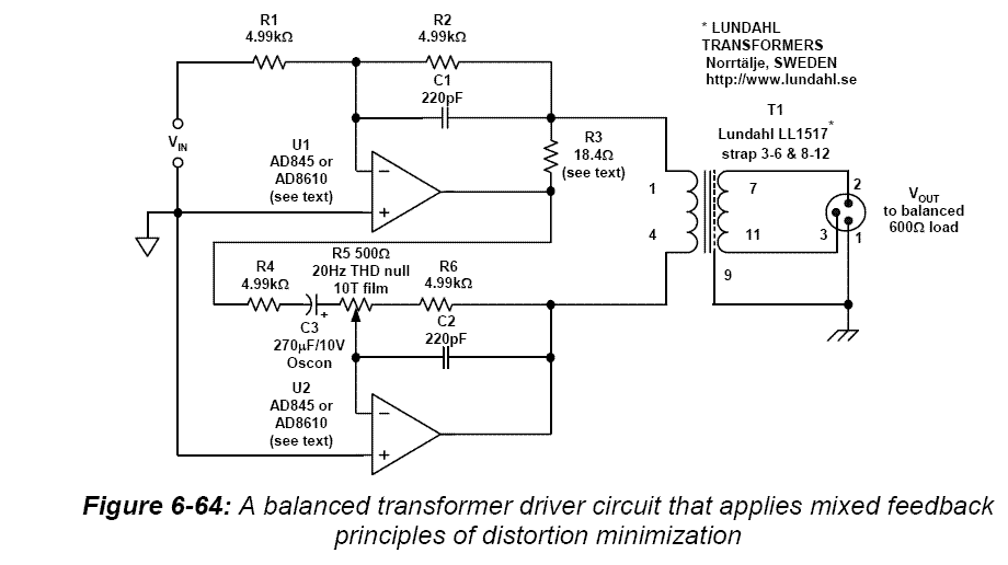

There's another approach however that's more elegant (in my opinion) and more effective.
This other approach doesn't just say "Hey, we've got some distortion. Let's throw some negative feedback at it and reduce it!" Instead, it recognizes what the source of the distortion is and deals with it more directly.
In this case, the source of the distortion is ultimately the DC resistance of the transformer's primary windings. The distortion is the voltage dropped across this resistance by way of non-linear current induced through it by way of the transformer's core.
This other approach deals with this by driving the transformer with a negative impedance equal to the DC resistance of the transformer's primary windings and effectively removes the winding resistance from the equation.
This other approach, somewhat ironically, is what is used in the Audio Precision rig that Walt used to make the measurements for his feedback approach.

The amazing thing about analog magnetic tape and class A electronics (whether tube, fet, or bipolar) is that is reduces predictably in level with lower amplitude. So when a magnetic tape is perhaps 10db below operating level, the distortion has reduced 10 times from 0 Vu (+4) level. 16 dB would be 40 times lower level, 20 dB 100 times lower level.
Now let us say that a magnetic tape gives .5% distortion at 0 Vu. The predicted distortion at 20 Hz would be .5/40 = 0.0125% distortion. A typical Jensen transformer gives 0.025% under the normal drive conditions, a factor of twice the magnetic tape.
Now what about a Blowtorch preamp.
Let us say that 0.1V out is 1W or 94 SPL from the loudspeaker. Let me guess that I 'might' have .5% distortion at 1V out, almost all 3'rd harmonic (just like tape). Then, at 0.1V, the distortion can be accurately predicted to be 100 times lower or .005% distortion. Yet, a tranformer in series with the output would add .025% at 20Hz, .015% at 30Hz, .005% at 50 Hz.
You see, the transformer adds double the distortion and MORE at low frequencies. Of course, negative impedance drive can be used, but it is tricky, and will oscillate if you are not careful.

john curl said:[snip] Of course, negative impedance drive can be used, but it is tricky, and will oscillate if you are not careful.
It is not tricky, completely predictable, and any half-witted designer knows how to make it stable. We are doing negative feedback successfully from before you were born, John. What a concept! 😉

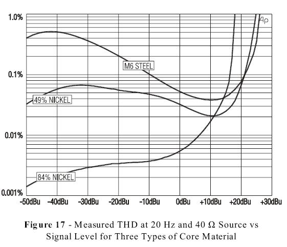

For the record, transformers INCREASE in low frequency distortion at lower levels. EVEN JENSEN.
Check your books, John
http://www.jensentransformers.com/an/Audio Transformers Chapter.pdf
john curl said:Jan, negative impedance drive, what is it, and what is dangerous about it?
It's in patent # 04614914. I don't know about dangerous. It seems to work very good in 1000's of pieces of equipment around the world.
