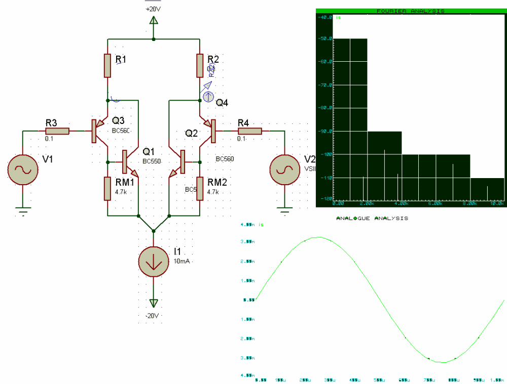

Hello
J' apporte ma pierre à l' édifice
or
I bring my stone to the building. ( I don't know the real translation )
I've simulated a complementary differiental use by Graham Maynard and Destroyer X ( and surely designed by Dr Self ) 😎
To respect the usage, I put the schematic, the spectral and time graph too.
On the simulation, they're harmonics around 1,9 kHz and 3,9 kHz. They're wrong ( S*** HAPPENS ).
Distortion calculated are :
H3 : 0,4 %
H5 : 0,3 %
H7 : 0,2 %
H9 : 0,063 %
D ~ 0,963 %
Input voltage is 0,1V / 1kHz.
I can do other measurement with other value if needed.
For the simulation, I use Isis v7.2 SP6 and its own model. I can provide all files.
