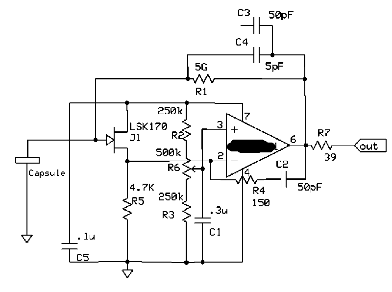

john curl said:The designer of the Calrec mike is dead, I am pretty sure. Are you talking to his associate, Peter Craven? If not, you are talking to an impostor.
In any case, 5532's are marginal and AD797's, or AD825's or some such would be better, for sure. Everyone knows that. People are just cheap and indifferent.
Yes the lead designers are passed on, this fellow did some changes later on even later they eliminated some tantalum electrolytics from the original. He has sent me the original drawings, there is no money involved and there is nothing to be gained by subtrifuge. I will correct that to someone responsible for making design changes at some point.
BTW I've built two of these with some 50pF capsules and one of our new fast op-amps 2nV on 1.5mA. The whole thing runs on 2.5mA so it's great for phantom power and it is 100mV/PA to boot. Sounds great too!

Scott, quality (hi end) capsules usually have 19pf such as the 1/2 inch B&K. Calrec is upper mid fi. Also, effective static capacitance is EVERYTHING in distortion generation from the capsule. Static vs dynamic capacitance. Check it out. Also, I first published my measurements of tantalum caps as coupling caps, 30 years ago, next month. It is about time that they removed a few. DUH!
john curl said:Scott, quality (hi end) capsules usually have 19pf such as the 1/2 inch B&K. Calrec is upper mid fi. Also, effective static capacitance is EVERYTHING in distortion generation from the capsule. Static vs dynamic capacitance. Check it out. Also, I first published my measurements of tantalum caps as coupling caps, 30 years ago, next month. It is about time that they removed a few. DUH!
High end bottle mikes are more like 50-100pF and B&K has several 50pF capsules. Neuman experimented with feedback to the capsule years ago but the FET op-amps they used didn't cut it. I don't know why they just didn't try the FET source follower in front of a low noise bi-polar. That circuit gets > 8.5 volts p-p of undistorted output on a 9V battery.

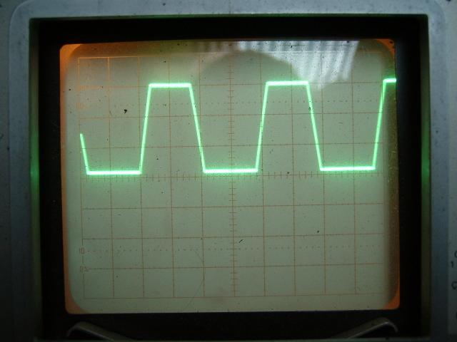

But anyway, all this nonsense argumentation over JFET or BJT input stages Everybody knows that any proper amp uses sweet vacuum tubes here
http://users.picknowl.com.au/~glenk/K10A.HTM
BTW, lots of feedback too, and clean 20kHz clipping also. Amazing, huh?
