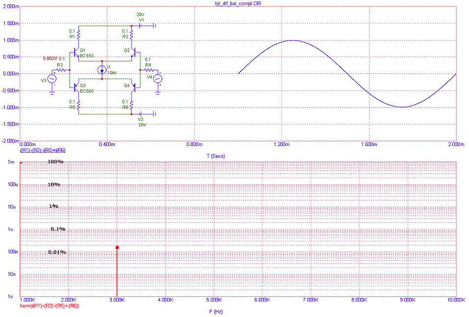

All else being equal, higher open loop bandwidth is better, BUT the oscillator driver I designed was made for instrumentation, NOT audio. I would not recommend that approach in general. This is because I had to make a more conventional design, rather than my traditional designs, and I think that my complementary differential designs sound better for audio.
At first shot, it is not as bad as might have been expected:

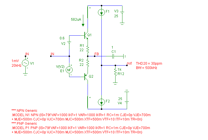

Hi Pavel,
But not a CFB input stage with BJTs. For minimal distortion RE = 0.5 * VT / Ie. (VT is the thermal voltage, ~26mV)
Edmond.
Hi Edmond
To beat jfet linearity with BJT's, we do not need to resort to a CFB input stage, we just need emitter degeneration 🙂
A good on-line reference:
http://www.dself.dsl.pipex.com/ampins/dipa/dipa.htm
5.1 DISTORTION 1. Input Pair Non-linearity

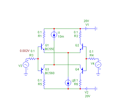

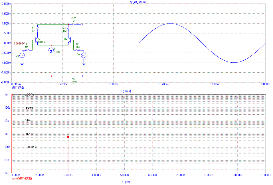

PMA, you changed the current sources to something more realistic, BUT if you add a 10 ohm resistor from the top emitter pair to the complementary emitter pair and adjust the current sources, to get the same current in the transistors, what happens? A big capacitor would do as well.
