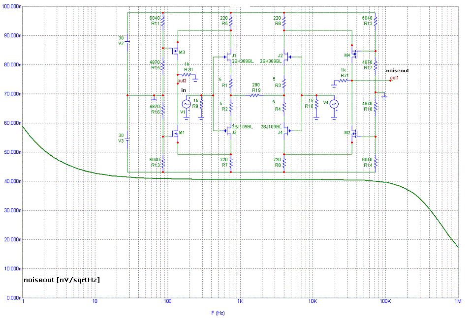

Noise Analysis

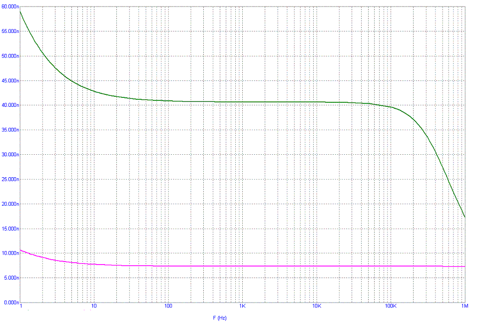

Let's kindly get back on topic. Here is my small contribution to noise analysis. The plot shows V(out1) SE output noise in nV/sqrtHz vs. frequency, input is V1.
P.S.: this is an output noise, so to get more common input noise one has to divide by gain.

This is not the quietest circuit in the world, because the mosfets on the output will contribute significant 1/f noise. This can be fixed, but the solution is worse than the problem, except for a slight noise improvement.
John, I am aware of what you are saying. IMHO the result is very very good, because even with MOSFET contribution noise seems to be 7nV/sqrtHz (input).
This is better than most of JFET opamps.

john curl said:This is not the quietest circuit in the world, because the mosfets on the output will contribute significant 1/f noise. This can be fixed, but the solution is worse than the problem, except for a slight noise improvement.
Thought question on noise, how would you make a gain of 6dB inverter (a real inverter with 100% GNF) with 1nV/rt-Hz input referred noise? |input impedance|>10k @ 20kHz also required.
