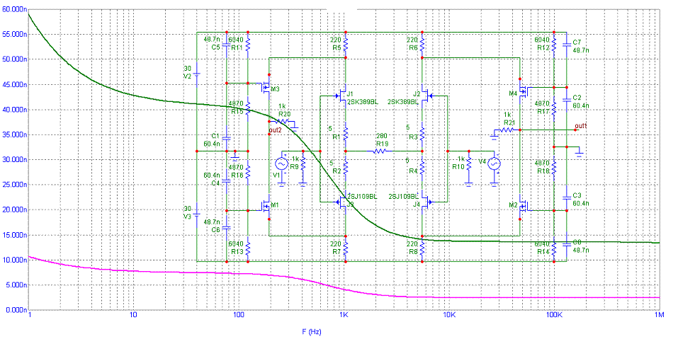

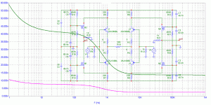

PMA said:How about compensated feedback divider
R1//C1 + R2//C2
Put in values that work and your getting close.
john curl said:This is not the quietest circuit in the world, because the mosfets on the output will contribute significant 1/f noise. This can be fixed, but the solution is worse than the problem, except for a slight noise improvement.
John/PMA,
In PMA's schematic in post #4315, do the resistors used to reference the Gates in the folded cascode influence the quantity/spectral distribution of the noise in any way? Same question for bipolars. Given the higher noise inherent in larger values of resistance, it seems that it might be worth choosing lower values of resistance, albeit at the cost of slightly greater current draw for the circuit overall. Alternatively you could bypass with a cap from Gate to ground to short some of the noise. I'm not suggesting a day and night difference...just one of those tweaks that would make an incremental improvement.
Grey
Small damping resistors in series with caps needed?

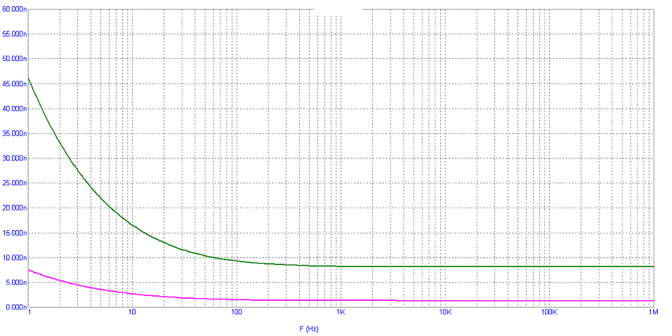

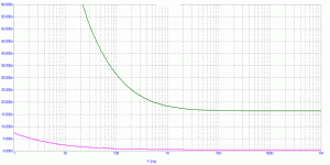

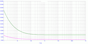

john curl said:I might suggest starting from the original and replacing the (4) 220 ohm resistors with noiseless current sources of the same current flow.
PMA said:It works:
Need he say more?
