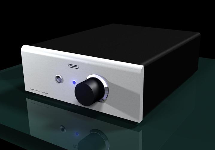

HighEnd is about design as well, and we have a Blowtorch case here.
Let me input with my 12 cents. A friend of mine, professional designer, has designed a case for my headphone amplifier PCB. There will be only one unique piece produced, see the photo.
