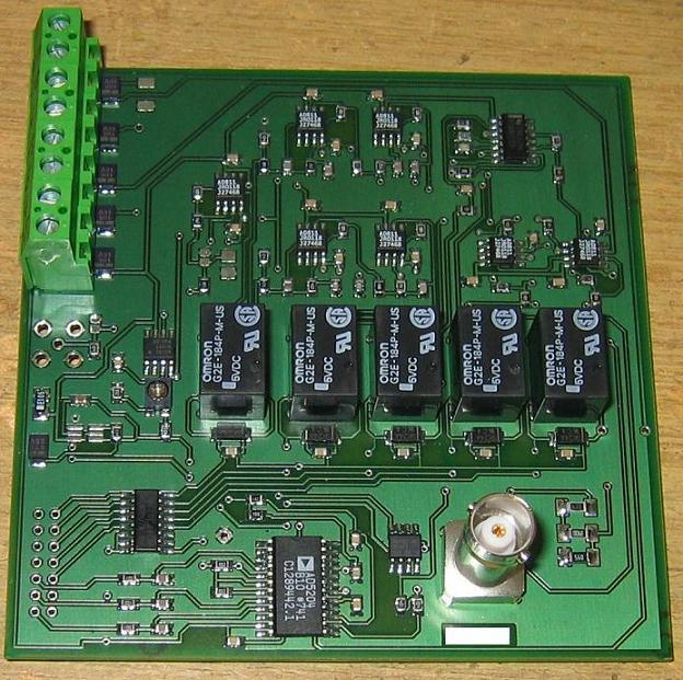

The similar is for breadboarding. I do not breadboard a simple thing like this, but start from PCB prototype.

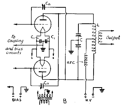

Charles Hansen said:
But for those who read the ARRL handbook (as I did as a teenager), look up the section on "neutralization". (I don't know if this information is still in the current editions. You may have to find an old one that still has information on tubes.)
Like everything else, if it were easy, everyone would be doing it. Instead, everyone does the easy thing and uses an output inductor. But doing things the same old way doesn't lead to any advances....
This really happened this afternoon. One of our guys contribs to the ARRL handbook, so I yelled over a few cubes and asked for the oldest article on neutralization that he had. He said "It's just feedback you know".
That's pretty funny!
But seriously, he must have had a different edition than I had. The article I remember talked about "neutralizing" interelectrode capacitances by injecting an equal and opposite signal. The circuit in question was a push-pull linear transmitter amplifier. With push-pull circuits, it's not too hard to find signals that are equal and opposite...
Again, I don't want to get into an argument on semantics, but this is not really a case of taking a signal from one part of the circuit and "feeding" it "back" to an earlier part of the circuit. In the example I recall in the ARRL handbook, it was taking signals from identical points in each half of the circuit and cross-feeding them to their mirror-image counterparts.
Re: Neutralization
KSTR said:
This circuit, from the 1941 ARRL handbook?
IHMO it would qualify as local voltage feedback.
- Klaus
I had the same argument at the AES conference in 1991 about equal amplitude subtractive neutralization really being feedback. It is semantic on some level. Inside the loop you have A-A = 0 and there is no term at all that contributes to the closed loop frequency response (in my case).
Re: Neutralization
Yes, that is the circuit I was thinking of. As Nelson correctly points out, if you want to think about it as feedback, it would be *positive* feedback.
In this particular case, they are trying to "neutralize" the Miller capacitance that would otherwise limit the bandwidth of the circuit.
This technique is *not* what I use to stabilize my amplifiers when driving a capacitive load. Rather it was a "jumping off" point that inspired a different circuit that worked quite well. (And if one were to see the schematic, *nobody* would claim it was a form of feedback, positive or negative.)
Given that you're talking about oscillation at very high frequencies, I would think that there would be enough phase shift to cancel (that's the point of the circuit, isn't it?) the opposing signal, hence the feedback would be negative at any frequency you'd care about. Somewhat the inverse of amplifier stability problems where feedback that ordinarily would be considered negative becomes positive at some arbitrarily high frequency...and no one bats an eye over the change in feedback nomenclature.
Grey
EDIT: Given that there's little to no audio signal in the high hundred-thousands to MHz range, I'm not sure that it matters if it is "feedback" or not. It's waaaaay beyond anything that even a wide bandwidth person like myself would consider a problem.
And if Charles has taken it in a different direction, then so much the better.
