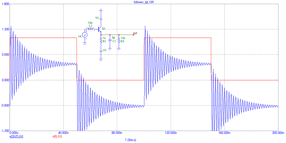

In an emitter follower there is degeneration, the active BJT actually increases or decreases current from the power supply into the load to reduce the error difference between the input signal and the output signal. From a mathematical perspective this fits a working definition of feedback, from language there is no external feedback network, all error canceling connections happen to be present intrinsic to the design. Is this feedback?
Take a more complex circuit; A D to A converts a bit stream to an analog signal. Use a digital inverter to run a second DAC so that the output is 180 degrees out of phase with the first circuit. Now using an analog stage, invert one DAC output and sum it to the other DAC. Some of the internal DAC errors are canceled. I think a mathmodel would show the cancellation as being the same as selective feedback. But there is no connection or network from an output stage to a previous stage, so is this feedback?
For my personal design process, any circuit that uses the difference between an output signal and an input signal to correct the output to more closely match the input signal is easiest to visualize as feedback.

KSTR said:
Syn08 has linked to the paper I also was referring to, the R//C circuit being on page 9. The problem is intrinsic base resistance which always seems to leave an inductive term in the output, and the driving stage has harder conditions. No free lunch...
This would be the non-feedback analysis approach.

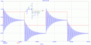

As much as some of the guys around are going to hate it, the emitter/source follower can be analyzed as a series-shunt feedback circuit, and stability can be evaluated using the Bode or Hurwitz criteria. The results are perfectly equivalent with the gyrator approach above.
This feedback analysis approach is sometimes a textbook example of series-shunt feedback circuit. If somebody is interested, I can dig for details in my library.
To paraphrase John: We need no stinkin' feedback 😀 Anything can ultimately analyzed and explained without the feedback theory, but wouldn't be a pity to give up such a wonderful instrument?
The emitter follower has almost 100% feedback.
Vin - Vout = Vbe
similar as
Vin - Vout = Vdif
for unity gain opamp.

Hi PMA, interesting simulation. The tendency to oscillation in followers is one reason that I developed transconductance amps back in the early '70's for the Grateful Dead.

Charles Hansen said:
That's a good question, but I don't know the answer.
When I first ran into the problem (BJT emitter followers being inherently unstable with a capacitive load), I looked in the books I had. Some of them mentioned the problem, but didn't have much useful information and certainly no solution. (My previous work with solid-state circuits had all been with FETs, which do not suffer from this problem.)
The next step was to go the local university library and see what they had. One textbook had a 2-page derivation of the math that I couldn't follow, but also had no practical solutions. None of the other books had anything useful either.
The next thing I did was call every solid-state designer I know to ask them what they knew. I started with John Curl, who knew about the problem and its cause (FDNR = Frequency Dependent Negative Resistance) and suggested putting a real and positive resistance in series with the base. I tried that, but without real success. By the time that the real resistance was large enough to have a beneficial effect, it was also increasing the output impedance of the circuit significantly. None of the other designers had much that was of any use, at least to me. (I was using an emitter-follower triple with no output inductor.) Most people told me that it couldn't be done and just use the inductor.
One book said that the most complete treatment was in Feucht's book. That was unavailable, so I got the CD-ROM version from his website. This contained enough information to get me thinking in a different direction. Then I remembered the neutralization trick from the old ARRL Handbook. I never actually built that circuit, but instead did a bunch of thought experiments and came up with a different idea that did the trick.
I don't know exactly how it works, partly because I still don't understand how an emitter follower (with a gain of less than one) can oscillate in the first place. But I suppose that you are probably right, that it somehow performs an "impedance transform" to cancel the FDNR. But I wouldn't swear to it.
And like everything else, to get the circuit to sound its best requires (guess what?) -- listening tests. But building an emitter-follower that is stable into capacitive loads without using an output inductor is definitely possible. Like I said, it took me over a month of full-time work. But maybe someone else out there is more clever and can come up with a solution more quickly.
