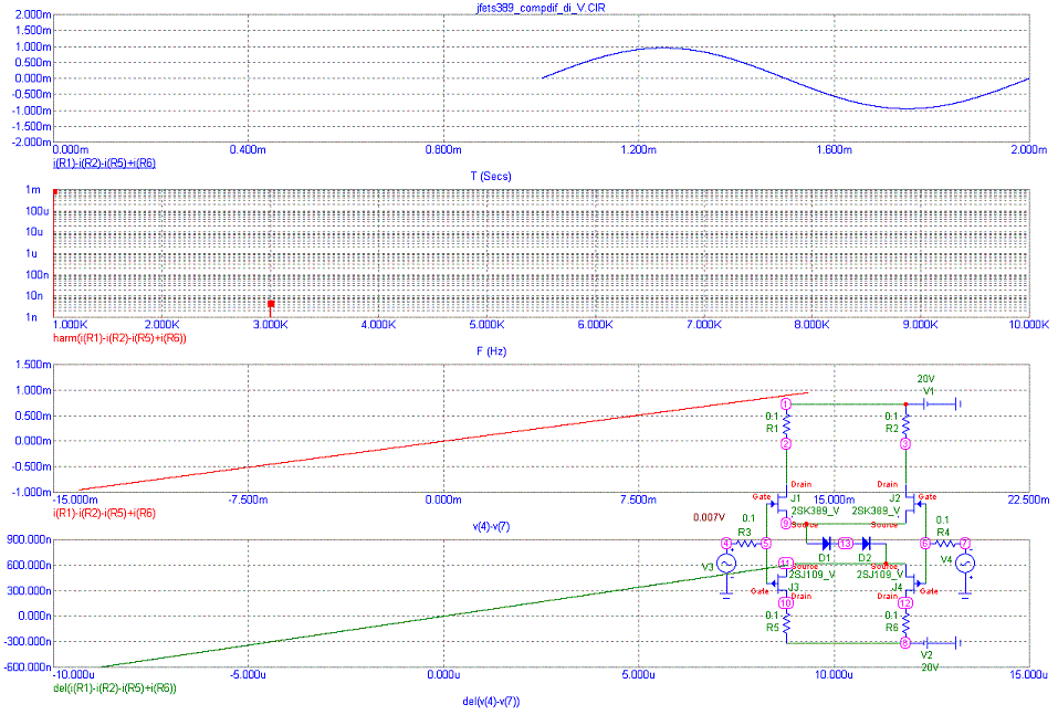

The diode, Schottky etc. would strongly depend on real Vthreshold voltage of jfets. We can put there voltage source + series res., current source + parallel res., diode, schottky, whatever is the best.

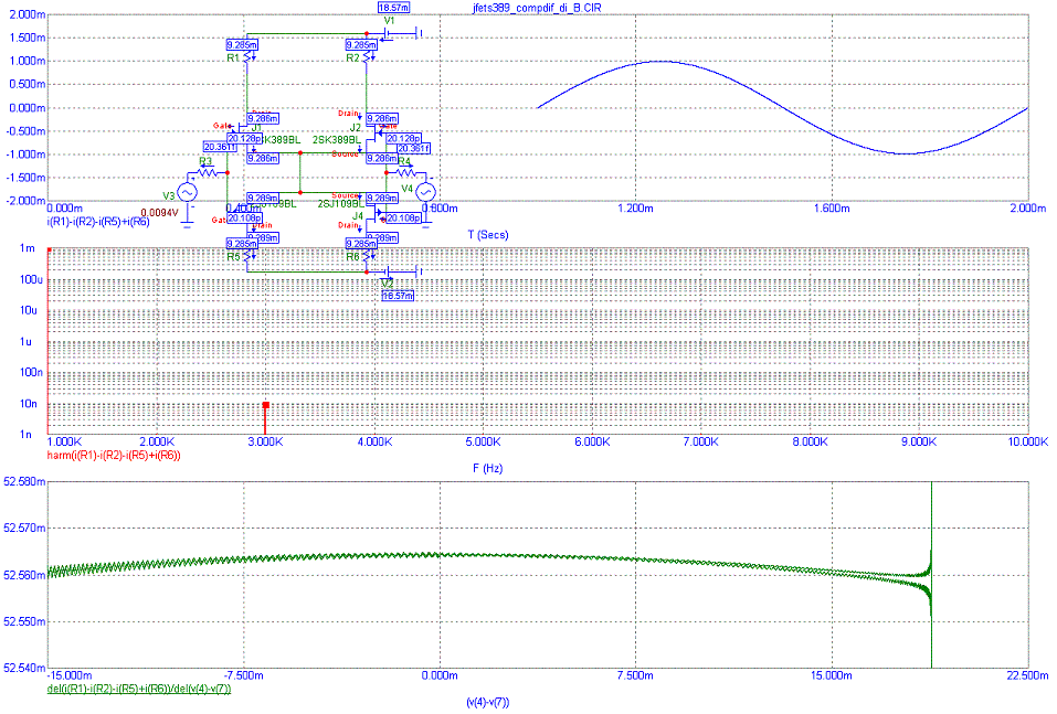

Another image, with transfer char. and its derivative (for connoisseurs 😉 )

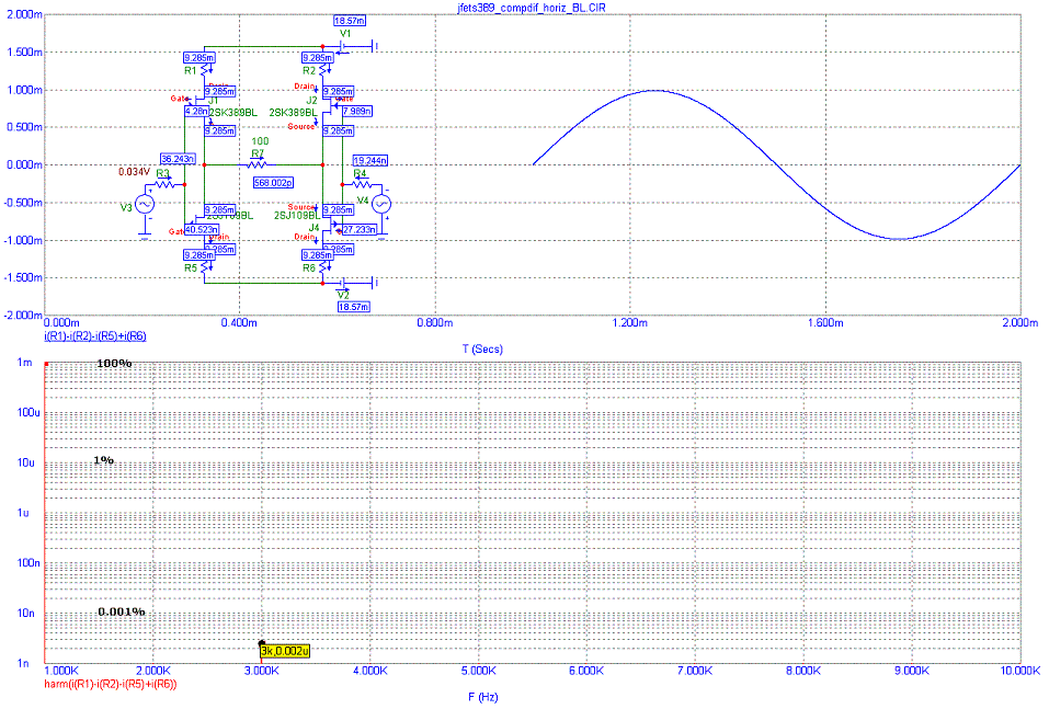

PMA, another interesting variation would be a 10-100 ohm resistor across the sources but horizontal rather than vertical. This will control the gain, but it might add distortion also. You already did something similar, but you used 51 ohm resistors. I would use 10 ohms or less. This should be both interesting and practical.
I am concerned that the jfets do not seem to behave like real world devices. We may have to align the parameters to be more self consistent. Still, very good work, even I am impressed with this simulation. This is an ideal where simulation is most useful, in my opinion, because you can try 'what ifs' without too much trouble, going so far as to use idealized devices at least at first, for clarity.

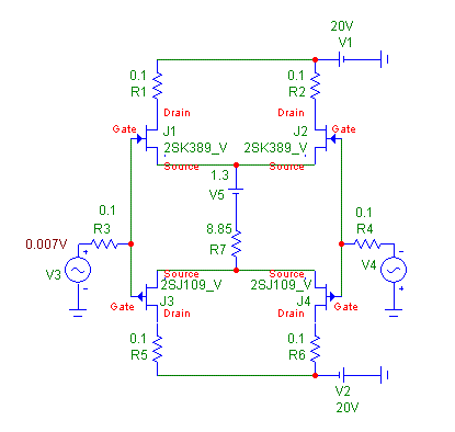

For the image attached:
1) 2SK389V/2SJ109V, Id=10mA, dId=1mA, dVss = +1.477V
V5 = +1.1V, R7 = 18.8R, D3 (3rd harm dist) = 0.007uA
V5 = +1.3V, R7 = 8.8R, D3 = 0.005uA
2) 2SK389BL/2SJ109BL, Id=10mA, dId=1mA, dVss = -60mV
V5 = -0.2V, R7=7R, D3 = 0.008uA
V5 = -0.1V, R7=2R, D3 = 0.008uA
V5 = -0.3V, R7=12R, D3 = 0.009uA

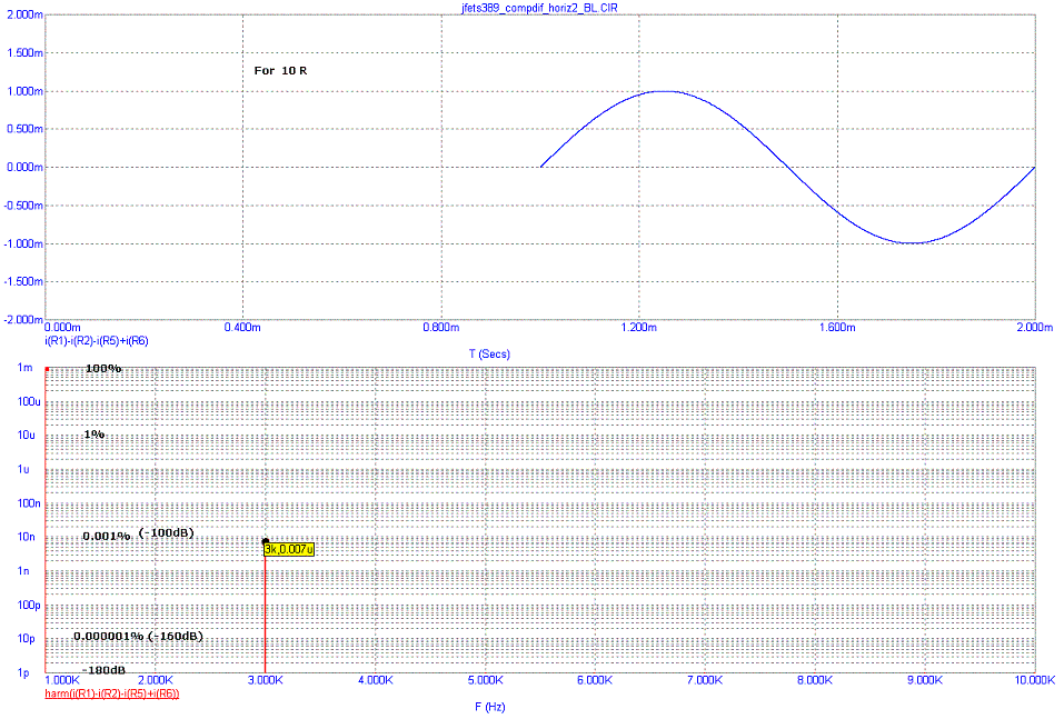

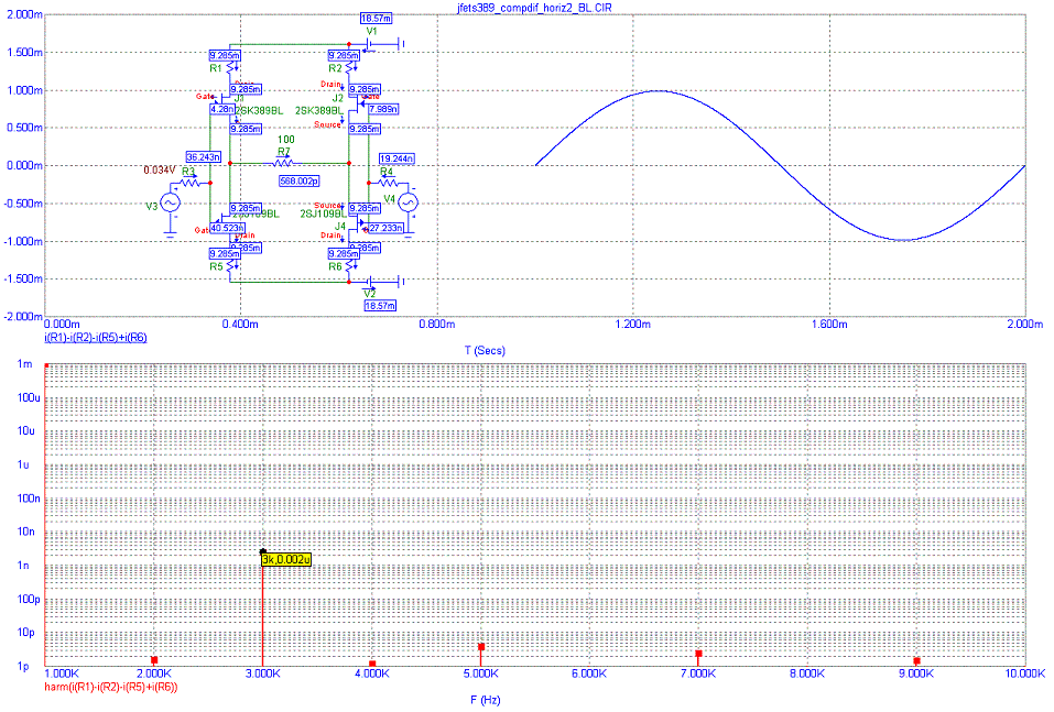

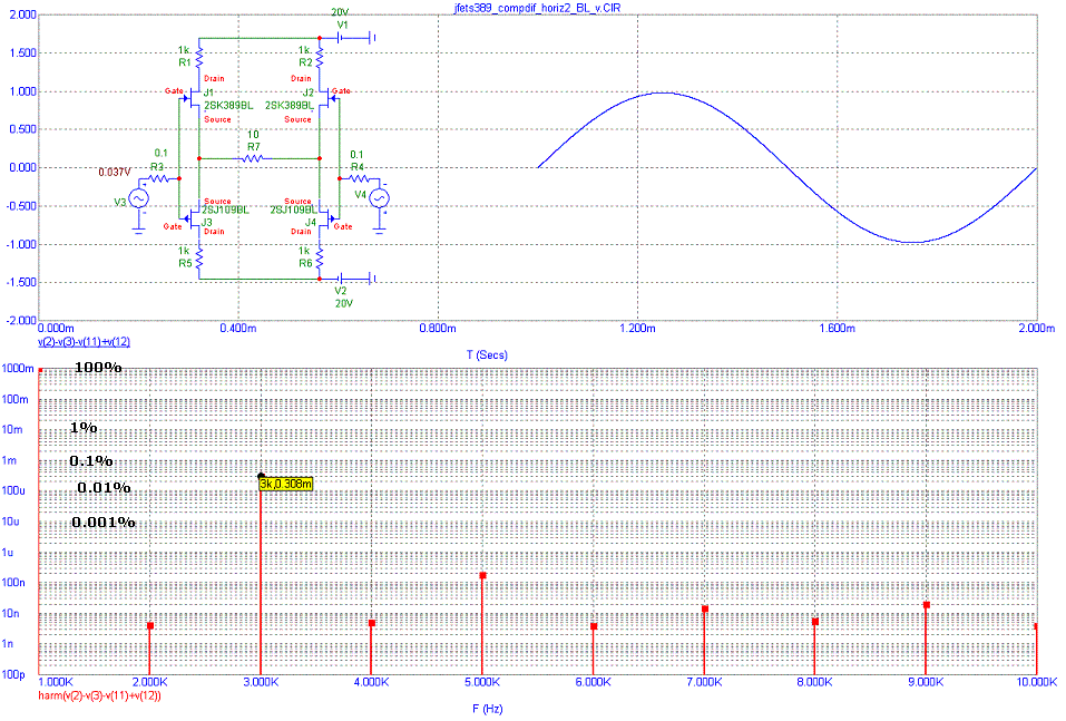

It reduces distortion, and for BL grade we have about 10mA Id without floating DC source. This is for 100R, I can try 10R and return in case of significant difference.
