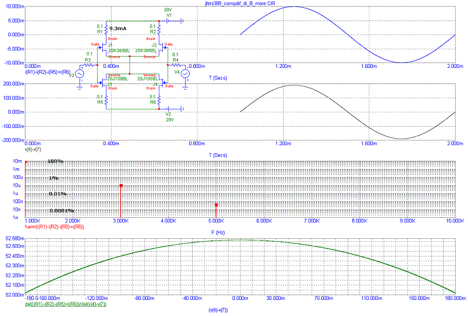

EUVL said:
I wonder if the distortion spectrum changes if you increase the input voltage swing by, say, 20dB ??
Patrick
These are input stages, and transfer function is voltage to current. The current is not supposed to change from saturation to saturation. In case you increase output current by 6dB, the distortion is still very low with nice spectrum.
The application is preamp. In case you drive normal power amps, i.e. you need voltage output up to some 2V, again, the distortion is very low and spectrum is nice.

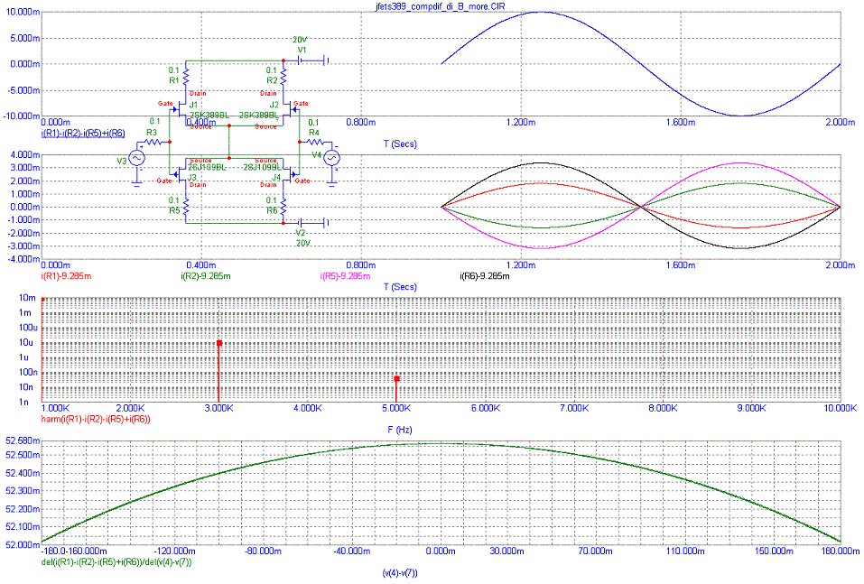

Patrick
Hereby the answer to your specific question. Please note my previous post.
This is only 1kHz, and capacitances do not have much chance to influence the plots.
The answer is difference in N-JFET and P-JFET halves, as you can see from models used:
*** N Channel JFET
.MODEL 2SK389BL NJF (VTO=-955.83m BETA=12.7099m LAMBDA=1m RS=10.3203
+ CGD=11.2066p CGS=19.1141p PB=3.80937 KF=1.217079E-019 AF=502.753m)
*** P Channel JFET
.MODEL 2SJ109BL PJF (VTO=-418.894m BETA=83.8035m LAMBDA=1m RS=11.0887
+ CGD=71.6975p CGS=61.6464p PB=1.85382 KF=7.879067E-018 AF=499.474m)
Look at VTO and BETA. I wonder if for completely equal devices the distortion would decrease to negligible level.

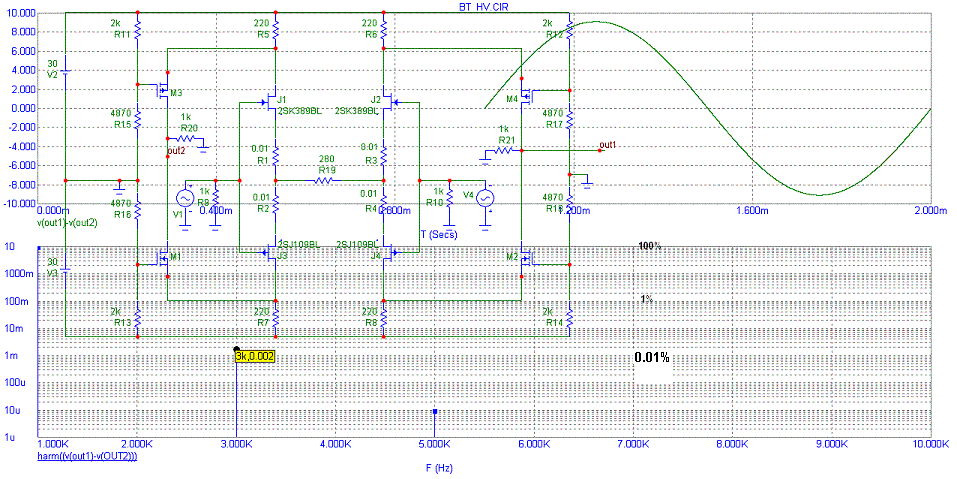

As you could see before:
http://www.diyaudio.com/forums/showthread.php?postid=1481196#post1481196
the N and P models differ in transconductance and threshold voltage. These models were used, only the last example was with BETA and VTO unified, to show the idealized status.
To get as much as shown, we need to keep constant Vds. The circuit example shown few pages earlier is a hint how to do it. In case we put 1k resistor into drains, distortion increase by order and new harmonic component would appear, as also shown by transfer function and distortion analysis on my webpage.
Change of JFET makes not much difference, as long as it has typical transfer function, of course higher transconductance is better.
The 1k resistor I was referring to was R20, R21 in the circuit you posted in post# 3859. However, as the cascode devices do not have infinite trnasconductance, as you swing the current in the diff pair, the drain voltage of the JFETs will move a bit, by an amount about the inverse of the transconductance of 2Sk2013 / 2SJ313 at bias. Therefore, I am of the opinion it would be more realistic to use a drain resistor of say 3 ohm in your later, much simplified simulations.
For a poweramp of say 100W class A, one would be looking at voltage swing of say +/- 20V. That would require each of the JFETs to swing +/-10mA into the output resistors (R20, R21). I would expect much higher distortion levels then. Correct ? And higher rail voltage probably won't help as the JFETs are limited by thermal dissipation, making it probably necessary for additional cascode devices to take the heat.
If one were to use something like Grey does in his GR-25, whereby the diff pair is driving both the gate and the source, you have the added non-linearity of the cascode devices coming into play. I have no idea how the distortion would look like, as I cannot find any spice model for the Toshiba 1A MOSFETs.
Patrick
