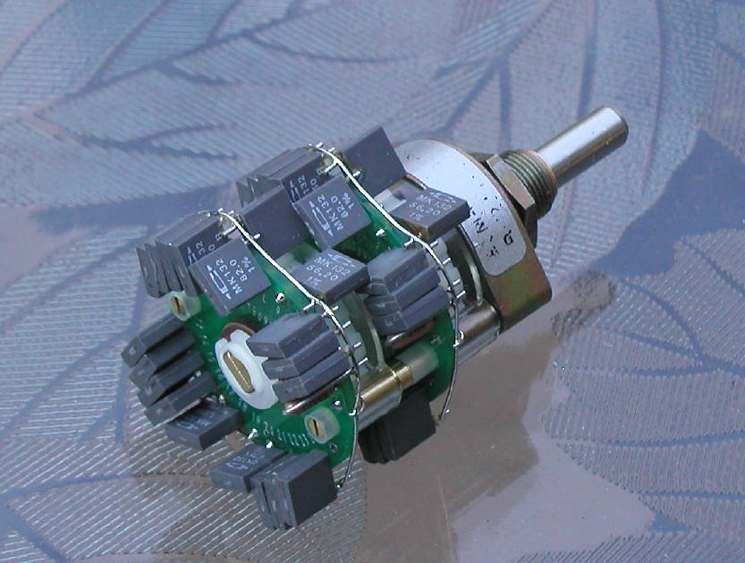

it is not DC voltage that causes the click sound, so it must be the ELMA rotary switches that is the cause. I can stand the clicks but they are annoying as it feels that the design is not finished. Personally, the clicks have to go.
You may still be able to get rid of the clicks by spraying the pads and viper with no residue contact cleaner. Elmas have tendency to click initially but after clean up they are usually quiet.
There are also two versions of those switches, from Percy's catalog:
"The 04-2130 features their standard premium grade construction
but does exhibit some slight contact bounce which may cause varying degrees of transient noise when switching between positions, usually insignificant
but this could be a problem in some applications so beware! The BV switches were specifically designed for attenuator applications and have no contact
bounce: they utilize PC boards for each deck with special trace material for the contacts."
Regarding the previous comments about fixed series/variable shunt attenuators; one has to look into it from a practical point of view as well. I don't know how much some of you like to play with volume control, but I ususally never go beyond 10dB variation range. For a 10k series resistor value, when changing volume from -10dB to -20dB (about all I use personally), the shunt element changes from 4k to 1k which gives approx 20% total input resistance change. Could that be regarded as negligable and small price to pay comparing to elaborate ladder circuits that beside using double the components number also create additonal contact points?
Of course, it is a different matter for a full featured commercial product, however in most diy applications it shouldn't be much of a problem or limitation.
Regarding TC TX2352 resistors, I like them as well, but in some parts of the circuit Caddocks just perform better; especially in an input shunt position and I always choose them over Vishays here.

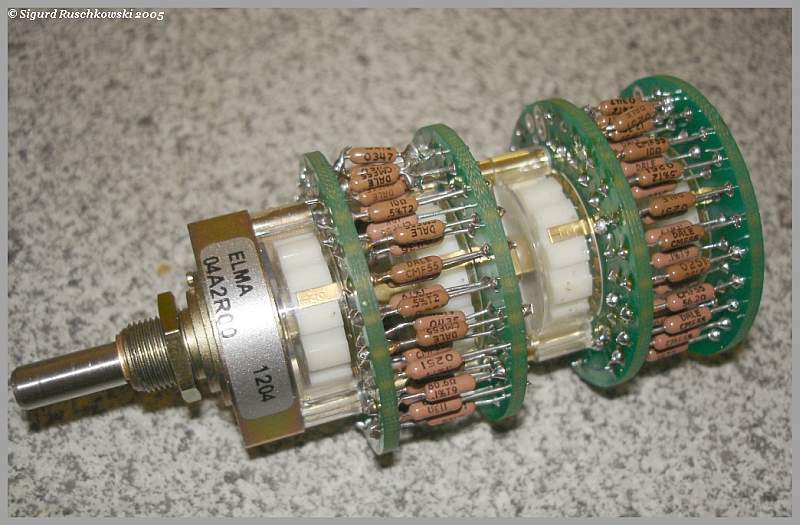

Hello Daniel,
that is one heck of a nice stepped attenuator you have made!
Mk132s in the shunt positions and then a TX2352 in the series position might be darn good combo. I might try that some day - then it will be with Shallcos.
As usual, personal preferences affects what one finds is the better combination 🙂
Thanks for the tip about the cleaner. That must be tested!
Yes, I know about the special versions for attenuators. I am only using those. Attached is my ladder attenuator which uses the ELMA rotary switch with four PCBs attached to it.
Depending on how large and heavy the knob is, the click sounds differ. I have tested knobs made outof solid brass from 10mm up to 70mm, and with the 70mm one I can do extremely slow turns of the rotary switch and notice how the make before brake action is working. With a 10mm know the rotary switch is more like tic-tic-tic.
Still, as Charles Hansen kindly pointed out, the make-before-brake action actually connects two resistors in parallel each step with a fixed series/variable shunt stepped attenuator. This wil change the gain in the middle of two volume settings and depending on where in the music wave one changes the volume setting, there will be a click sound.
Sigurd
It may be that the heavy knob affects mechanical alignement of the contact elements in the Elma switch, after all they are pretty fragile. In such cases I would recommend shaft extenders which should reduce any such behaviour.
The attenutaor in my picture above had some switching noise initially but after clean up it's completely quiet. That was also confirmed by a friend of mine who built similar attenuator.
I use Elma in my TVC based preamp and after 3 years it's still trouble free: http://www.diyaudio.com/forums/attachment.php?s=&postid=879147&stamp=1143477205
