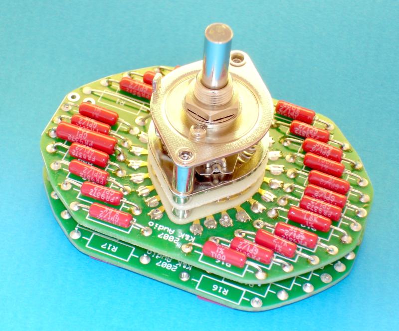

Attached is my latest stepped attenuator (K & K Audio's fixed series/variable shunt using a Seiden switch, I have used PRP reistors for it.)
Sigurd

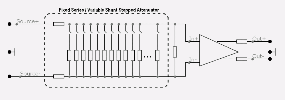

To avoid misunderstandings regarding what type of stepped attenuator is which,
I attach a schematics showing what I call a fixed series / variable stepped shunt attenuator for balanced use.

Bobken said:Yes, it is an old dodge to stretch these detent springs, but not one which I generally would use, especially if several need to be done when as you say, there is no going back! I replace them with some which are weaker, and always consistent.
Yes, that is a good approach. Since Shallco is in the US, it is easy for us to obtain extra springs, but your solution is better for most DIY'ers. Then they can try a variety of springs until they find the one they like best. One bad thing about the Shallco design is that the geometry of the detent mechanism is such that the force in one direction is different from the force in the other direction.
In our newest design, we have custom Shallco switches with no detent mechanism. The switches are only controlled via precision stepper motors and toothed timing belts and pulleys. So the worst thing about the Shallcos is completely avoided.
Bobken said:As to my "preference", this is not actually as you suggest here, but maybe my choice of wording wasn't as clear as it should have been. However, I did say that the true ladder switched *series and shunt* type was "the best alternative" and of course this can be made with a constant input impedance, which we both seem to prefer.
Sorry I didn't make myself clear. I understood your preference for a true ladder. When using switches as transparent as the Shallcos, this is an excellent approach, as the ladder design adds an additional switch contact to the signal path.
I was instead comparing a shunt attenuator to a divider attenuator. One would think that all of those resistors in series of a divider attenuator would degrade the sound. But I found that not to be the case, even with ordinary "good" resistor, such as the Roedersteins. I was a bit surprised by the result. On the other hand, the difference between 10 kohm and 100 kohm and 1 Mohm input impedance is quite significant sonically. Obviously the change of impedance of a shunt attenuator will vary depending on the design, but I am leery of such an approach.
