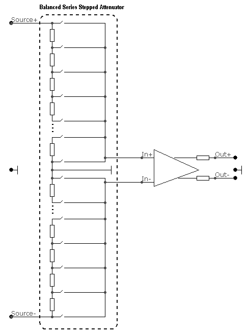

Sigurd Ruschkow said:To avoid misunderstandings regarding what type of stepped attenuator is which,
I attach a schematics showing what I call a fixed series / variable stepped shunt attenuator for balanced use.
The problem with this schematic is that it will attenuate differential signal perfectly, but common-mode signals not at all. So as you turn the volume down, the CMRR of the overall circuit is reduced by the factor of your attenuator. If you circuit has 50 dB CMRR and you are listening at -40 dB, then you only have 10 dB CMRR left.

Hello Charles,
it is not DC voltage that causes the click sound, so it must be the ELMA rotary switches that is the cause. I can stand the clicks but they are annoying as it feels that the design is not finished. Personally, the clicks have to go.
The fixed series/variable shunt attenuator is not the perfect solution as you point out with the common mode issue. It is a compromise.
Still, with it I can have two fixed resistors of the TX2352 nude Vishay type, and use PRP resistors for the rest,
and have at most two TX2352s in series and one PRP resistor parallel to the signal path instead of maybe 200 PRP resistors.
Spontaneously, I would think that my solution has the sonical advantage.
Resistor size is a problem when using hole mounted types, but with SMD resistors it should be able to fit them all. I wonder if there are any audiophiles out there that would pay the extra cost of having an all-BulkMetalFoil-resistor attenuator with 240 resistors?
It surely would be interesting to have Stereophile test your new preamp with both types of attenuators.
Attached is a balanced series attenuator schematics.

Sigurd Ruschkow said:it is not DC voltage that causes the click sound, so it must be the ELMA rotary switches that is the cause.
Generally speaking, there can be two causes:
a) If the switch is MBB, then there will momentarily be two shunt resistors in parellel. This will reduce the gain at least 6 dB (depending on the step sizes of your attenuator design) during the transition. This can be perceived as a "click", especially if it occurs when the waveform is far from the zero crossing.
b) If the switch is BBM, then there will momentarily be a time when the gain increases to full volume with your attenuator scheme. This will also be perceived as a "click".
Sigurd Ruschkow said:The fixed series/variable shunt attenuator is not the perfect solution as you point out with the common mode issue. It is a compromise.
All designs involve compromise. That is the art of design.
Sigurd Ruschkow said:Spontaneously, I would think that my solution has the sonical advantage.
Your conclusion seems logical. However, the only way to know for sure is with a listening test.
