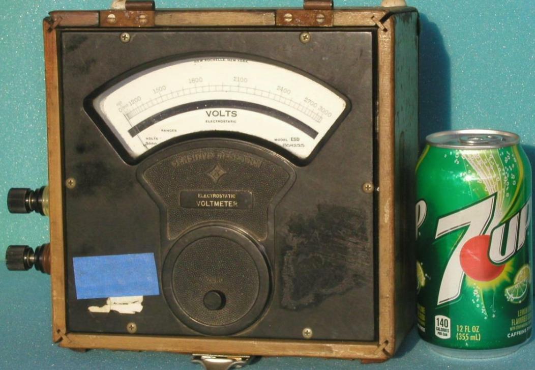

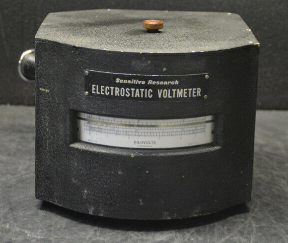

Electrostatic voltmeter. Usually look like the pictures below. They draw zero current at DC and very little at AC. Sensitive instrument (or whats left of it) may still make them but they are all quite vintage.
I spent many weekends at Richards and he never had one. He had a HV probe like the Fluke, which will load the supply and cannot be used at the panels. His speakers had 100 Meg build out resistors at each panel for the HV Bias. One of the last upgrades was a regulated modular HV bias supply. It seemed to make a difference, not that we ever did a blind test or measurement. I never installed them in my Quads.
