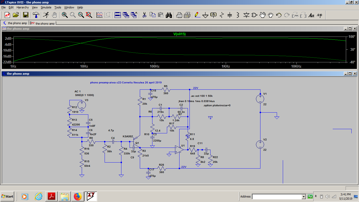

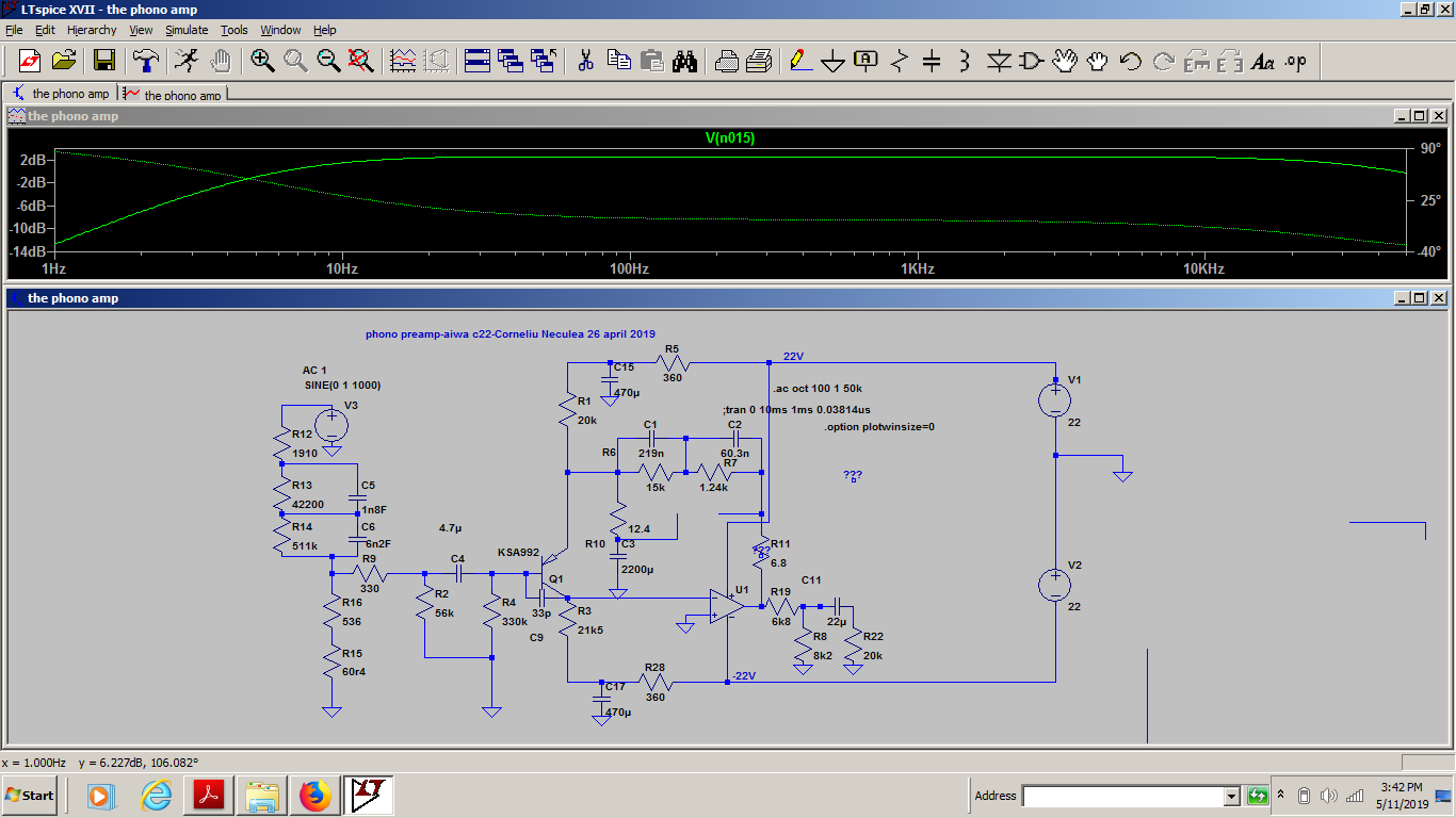

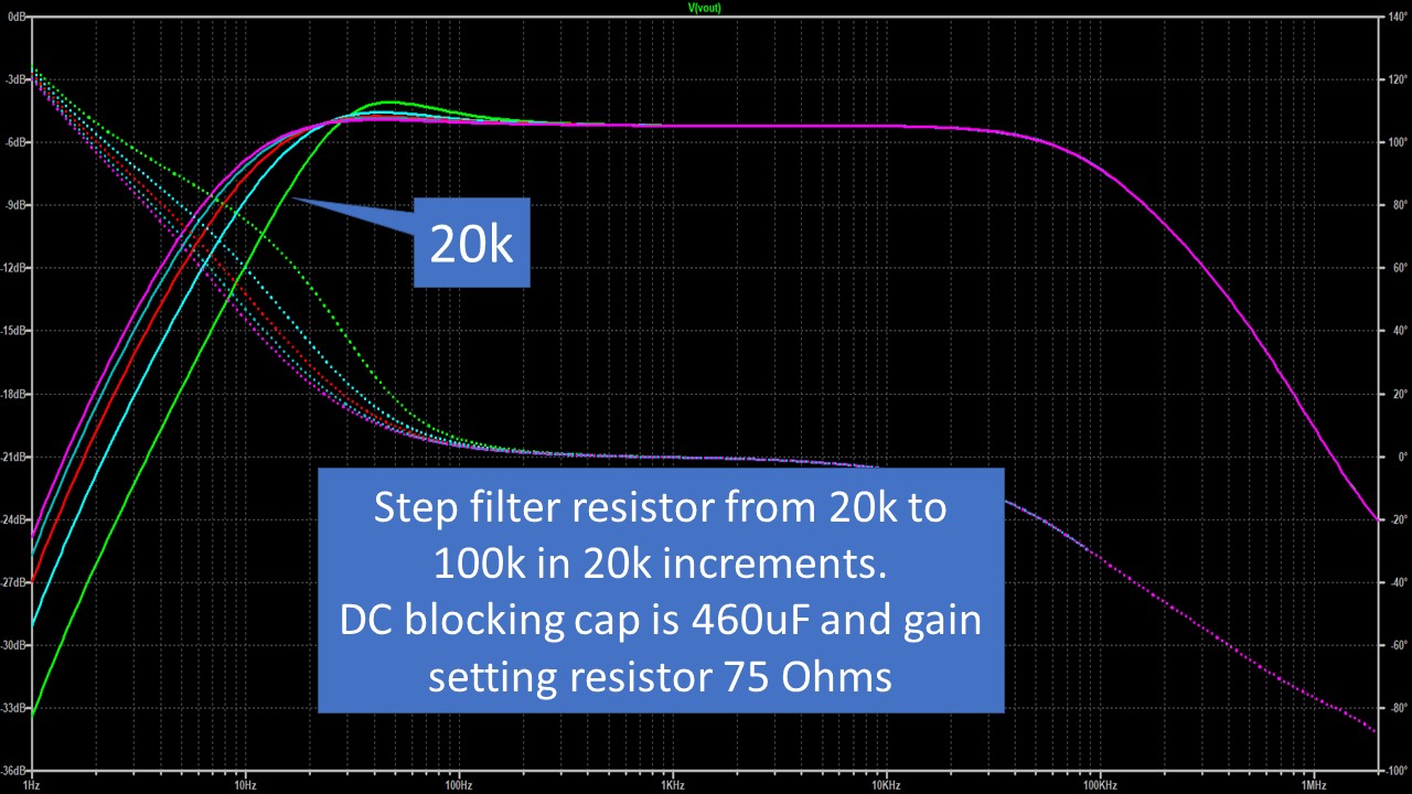

In all active equalizers, one trick is to run a resistor from the output of the opamp back to the top of the DC blocking capacitor where it connects with the lower arm of the gain setting resistor. If you select the resistor correctly, you get c 12 dB gain reduction vs 20 Hz at 6-8 Hz. The LT1115 data sheet RIAA has an example.

470uF gives a MC low frequency corner of about 15Hz (slightly lower due to the cartridge few ohms impedance). I wonder how you kept the 20Hz RIAA with this single LF pole, the error at 20Hz is about -2.5dB.
You don't try to - the subsonic filter lifts the response (i.e. peaks) between 100Hz and ~20 Hz by about 2 dB as you point out. My values are a bit different so I'm not down as much at 20Hz. The peaking makes for a slightly 'heavier' bass but this is vinyl . . . if some find it objectionable then head over to the 'Cartridge dynamic behaviour thread' and look at the typical cart responses to allay their fears.
On another phono amp, I don't have this but just a subsonic filer after the main RIAA EQ stage - the peaking is much less (about 0.5 dB IIRC) with it switched in.
And the rumble as well ?You don't try to - the subsonic filter lifts the response (i.e. peaks) between 100Hz and ~20 Hz by about 2 dB

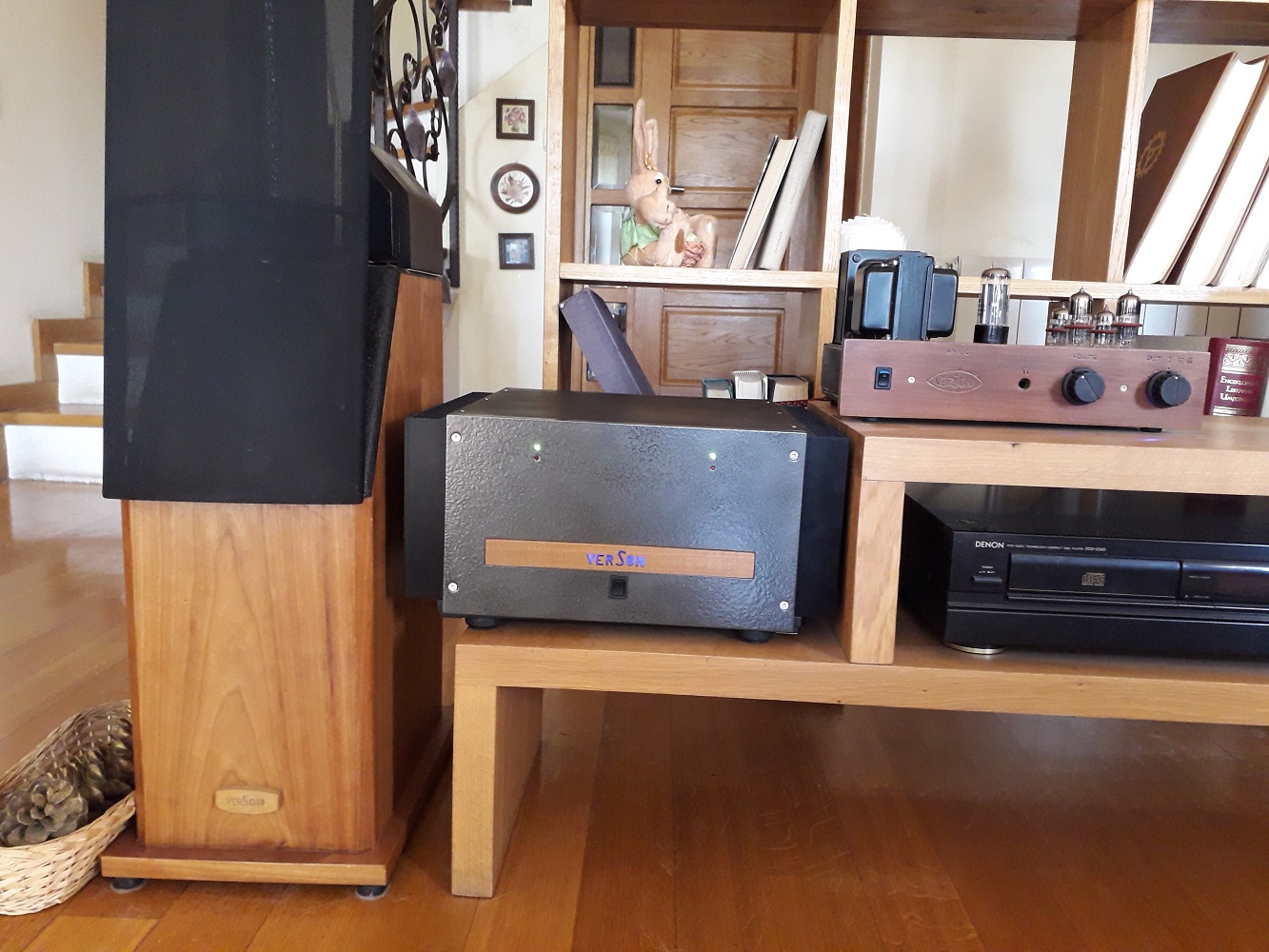

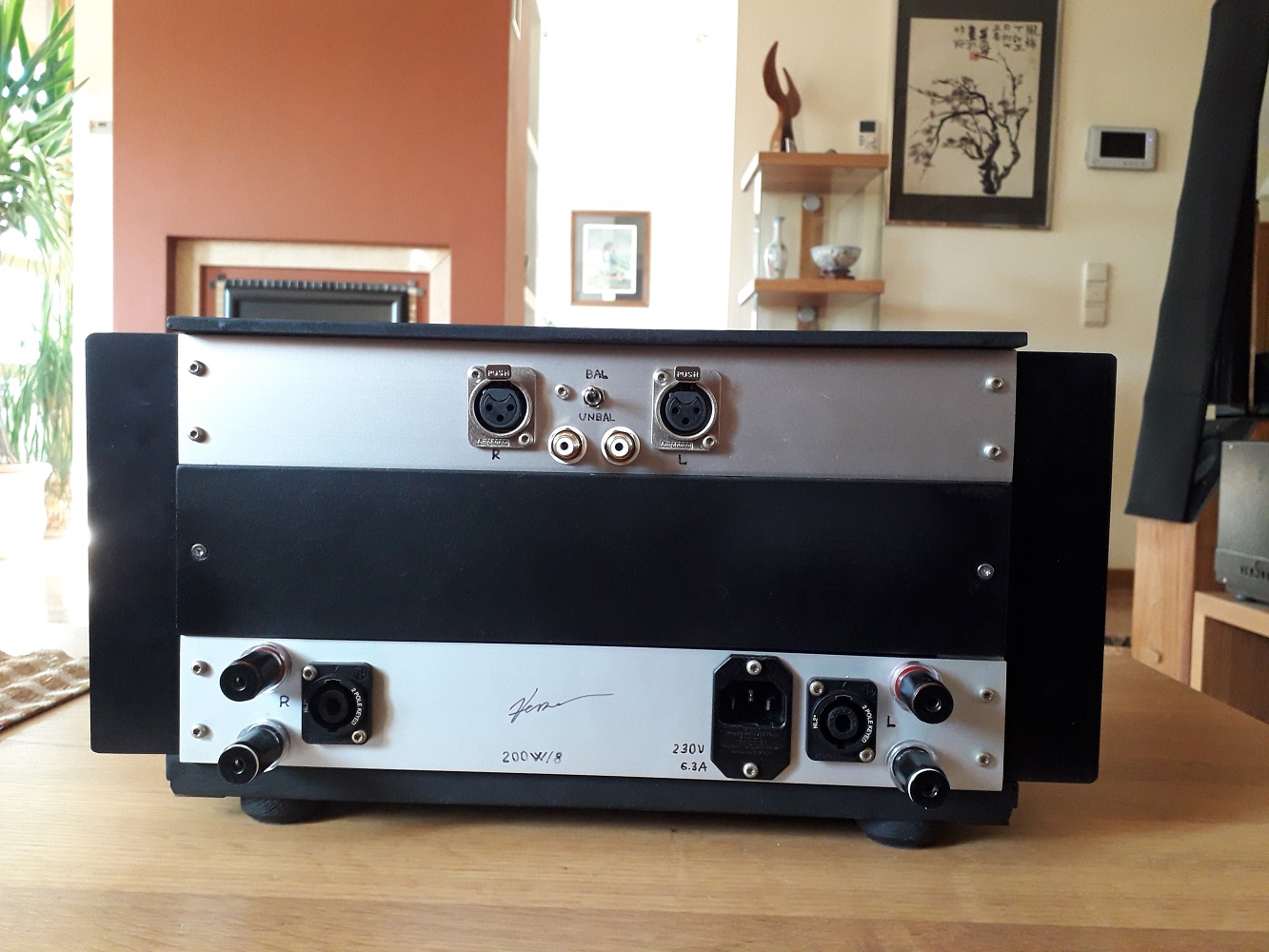

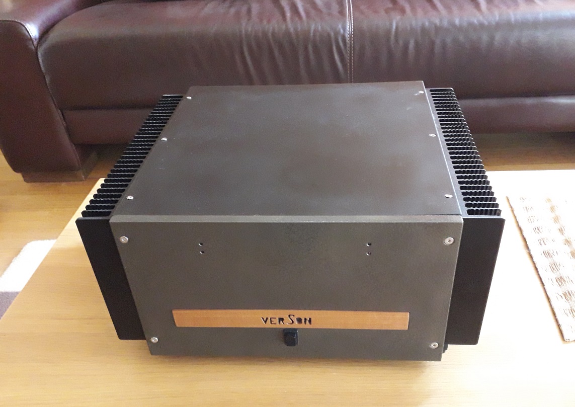

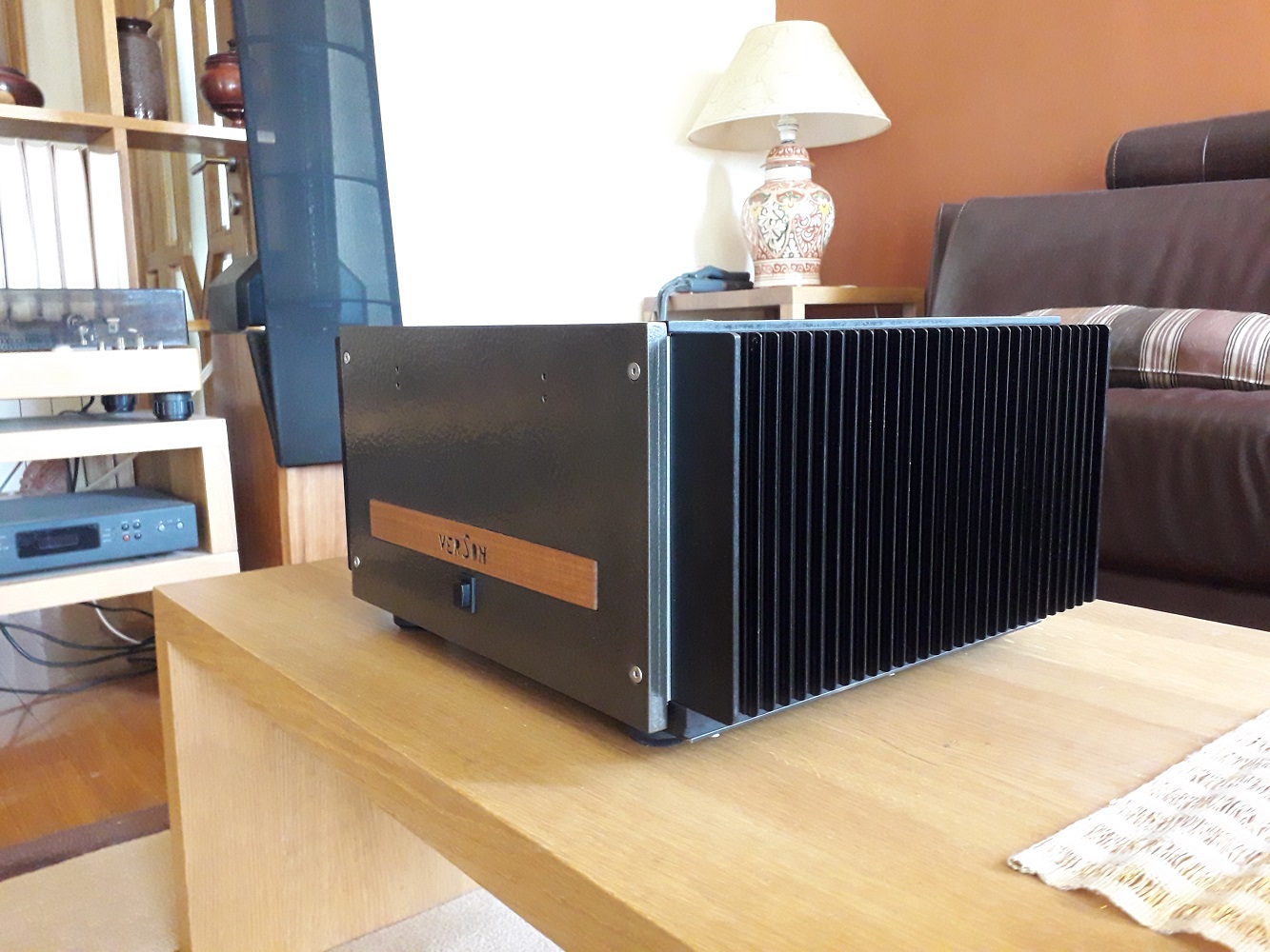

200W CFA now converted to VFA with balanced inputs with no eight legs inside (except DC servo).
This amp enclosure was built having in mind to get fabulous sound out of it. It is well known that ferrous metal is not good, even aluminium if used in big quantity will get harsh cold sound,so no big milled chunk is used, just aluminium frame. To get warm sound wood was used, like bottom plate(laminated wood), wooden feet (fir), top plate(HDF) all to get the best possible sound.
Richard, I hope you like my type of that amp case? Probably not possible to drive some loudspeakers with 2 ohm dip in impedance, heat sink not big enough for that, but big enough to drive 4 ohm to full power.
BR Damir
BR Damir
I don't understand why using a subsonic filter that peaks - any 3rd order Sallen-Key filter tuned to 10-11Hz will do the job with virtually zero impact on the RIAA 20Hz frequency response. Being of an odd order, only a dual op amp is required to implement, can't get better/simpler than this.
Using a low RC low pass constant, then a peaking high pass filter to compensate the LF frequency drop is IMO an as dumb as it gets idea. Measure your group delay (or calculate using Gd(w)=-Re[H'(s)/H(s)] for s=jw), you may have a pretty nasty surprise. Unless you care only about your customer satisfaction, which I'm sure it's high, disregarding the solution you would choose.
