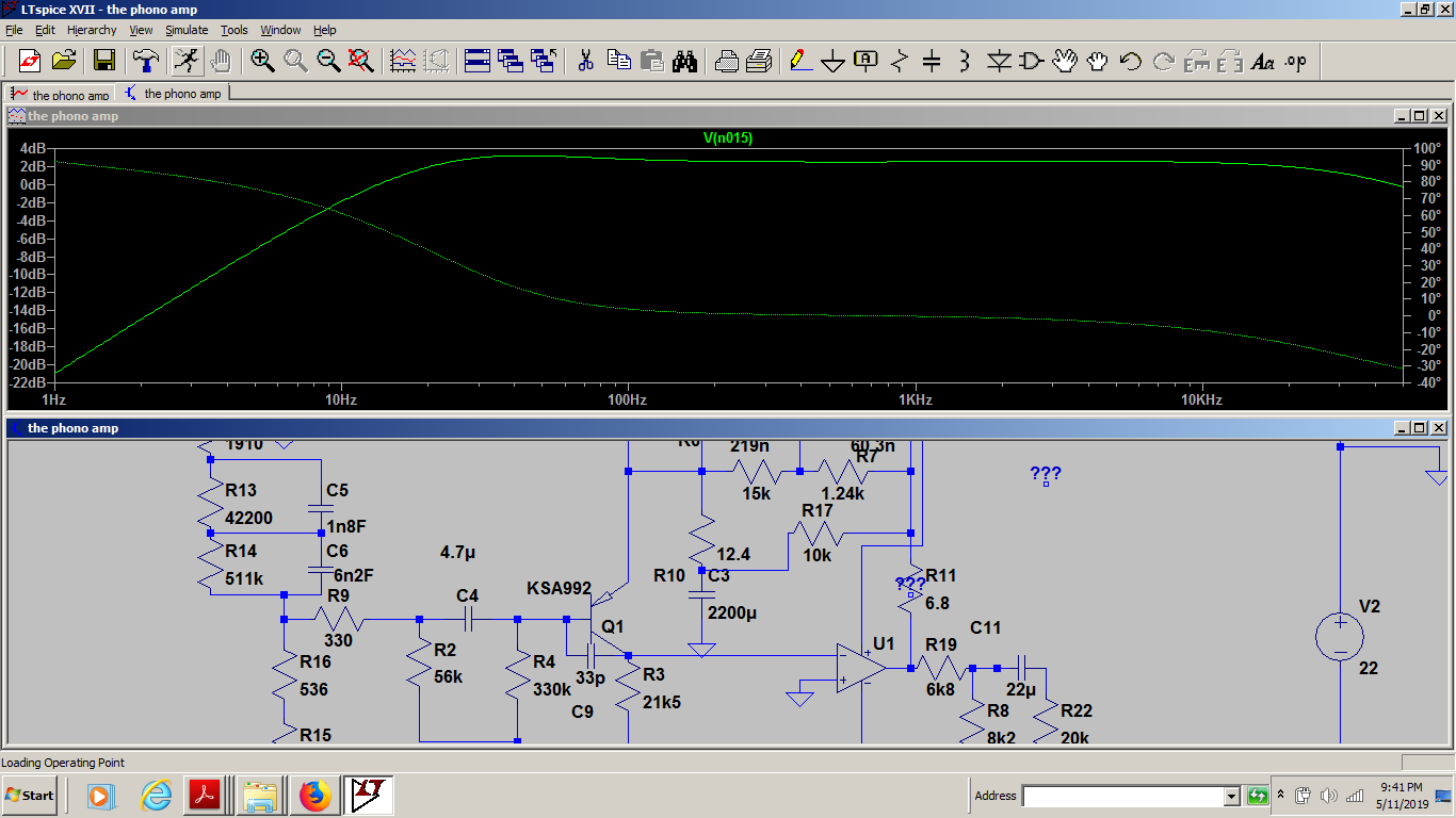

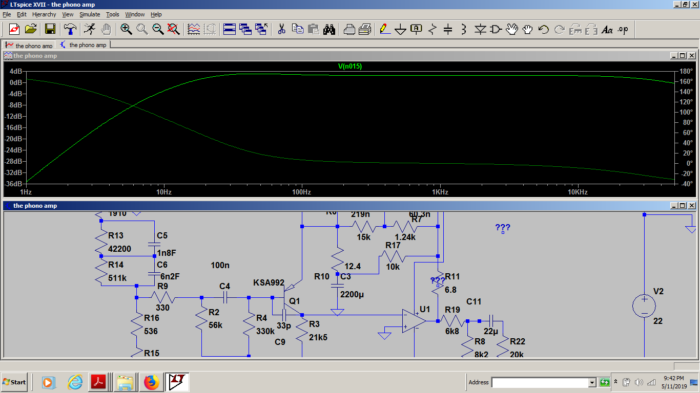

Lowering the input capacitor value also allow us to use higher quality film capacitors with infinitesimal dielectric absorption too just to keep JC around :)
You can be defiant , but i spent years checking most commercial models and high end audio claims and there is no best solution. You can do it by ear and still have a decent riaa preamp just because of the RIAA standard itself. I even modified a passive riaa filter to have a Presence-deesser tone control.That was done in the 1v2 preamp by having R23 and R25 forming one single 470 ohms wirewound potentiometer getting me +-5...+-8db between 5...7khz . You can tolerate large amounts of non linearities with vinyls as they are very nonlinear by default.

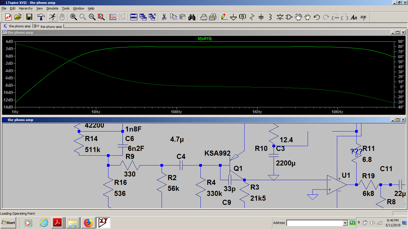

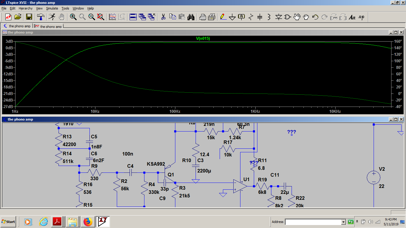

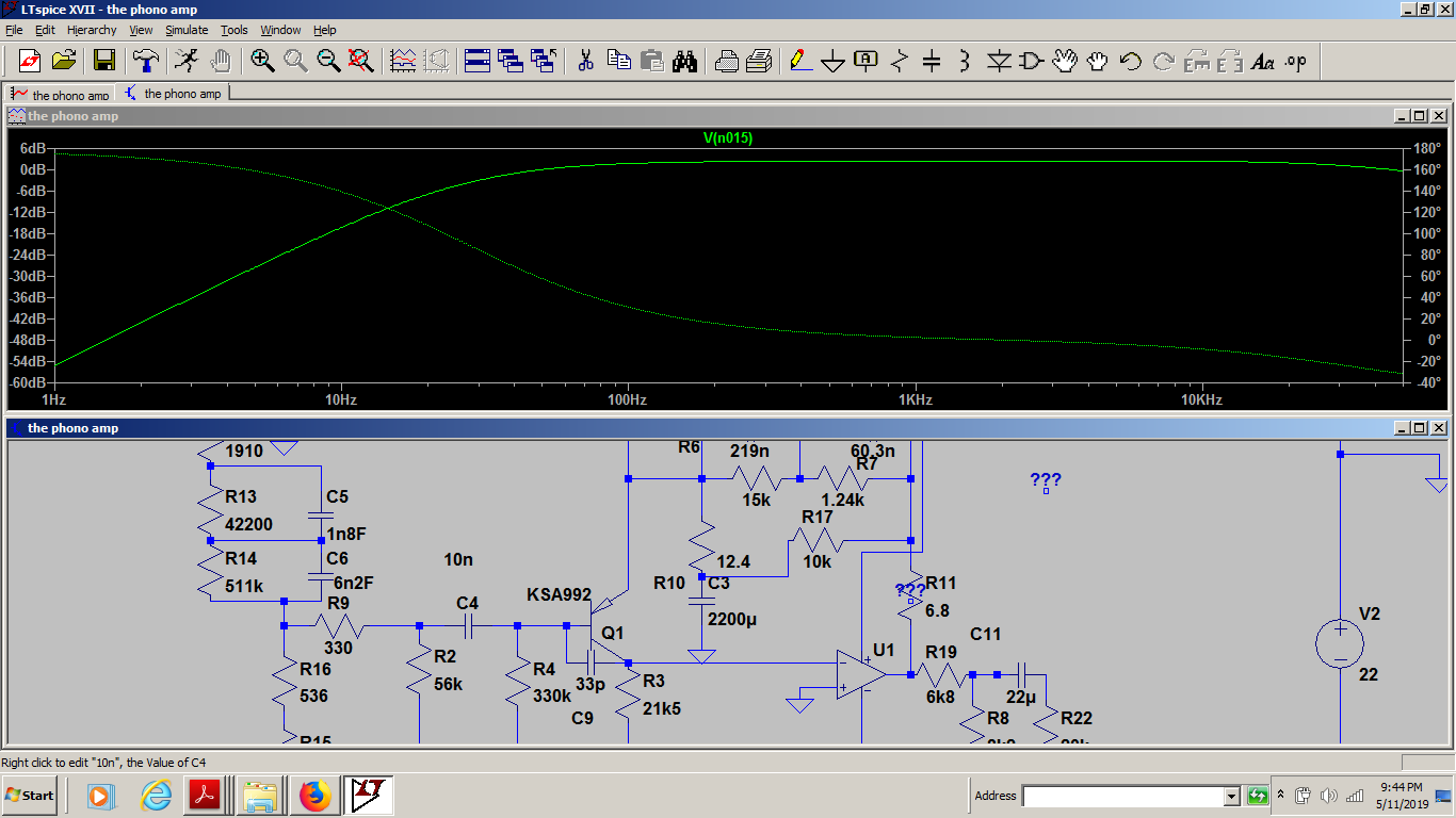

I told you exactly what I did to get the earlier plot. I ran a 20k resistor from the output of an all active RIAA phono EQ amp to the junction of the bottom of the gain setting resistor (75 Ohms) and the top of the DC blocking cap (470uF). That's all - nothing else. See the LT1115 phono amp schematic Mark Johnson posted if you want more detail on the technique.
re the GD, LTspice is your friend. Click on the right vertical axis and select 'display Group Delay' - that's how I got the numbers I mentioned re the above. Additionaly, See fig 7 in the Holman paper where hearing sensitivity to GD is shown.
If you are fixated on the +2.5dB peaking between 100 Hz and 20 Hz on a phono EQ and not worried about things like speaker-room interaction or cart response then you indeed have a problem of priorities. But if its such a concern, then just don't do it or switch the filter out.
And no, I don't believe cart response anomalies are an excuse for sloppy design - the EQ amp is flat to within 0.2 dB before I connect the 20k resistor as described above.
Duly noted, so you couldn't care less about the LF RIAA accuracy, don't care about the sensitivity of the bootstraping peaking and the interaction with the LF amplifier frequency response, simulated only without any GD measurements (highly dependent on the sensitivity), you say cartridges have worse than 2dB low frequency response, then take it back, then once again claim the speaker-room interaction is more important, have happy customers. Tell you what, in my book this is as close to "design by ear" as it gets. Case closed.
BTW, if not already obvious, the technique to boost the LF response is well known, called bootstraping, and can be implemented without peaking, if carefully designed (not in your case, unfortunately) to mix and match with the amplifier LF pole. It can extend the LF frequency response, but it implements a single pole, though, so the effect on rumble (about 7Hz) is virtually zero. Try an idler wheel turntable with it, you will lose some Garard lover customers.

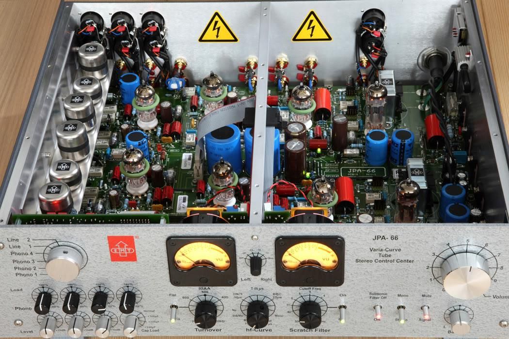

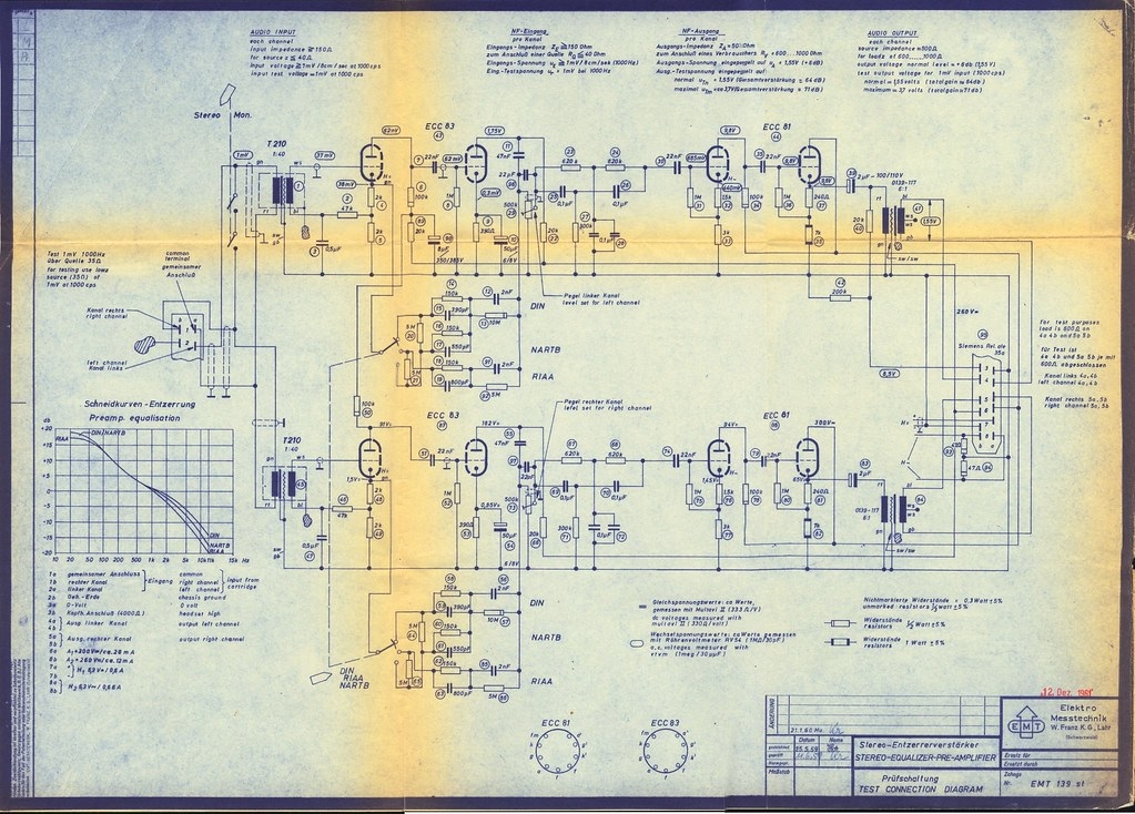

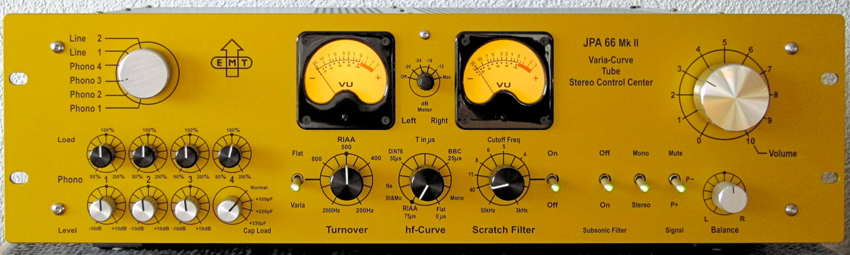

And by the way...if you really want to understand how a phono preamp-cartridge should behave you better find the EMT JPA-66 schematic!
I don't want to understand such a 50 years old monstrosity. Not being in the audio business (not even a wannabe), I can afford to. With all those transformers, I'm sure it sounds great :rofl:
That schematic is for emt-139 not jpa-66
http://www.audeus.it/wp-content/uploads/2015/07/JPA66_75.jpg
you don't need to ...there are others who can do it , but EMT set the standards for the rest of us...I don't have the jpa 66 either, but i don't need to...I found their small secrets already.
And be happy cause it's current feedback design with valves ;)))))

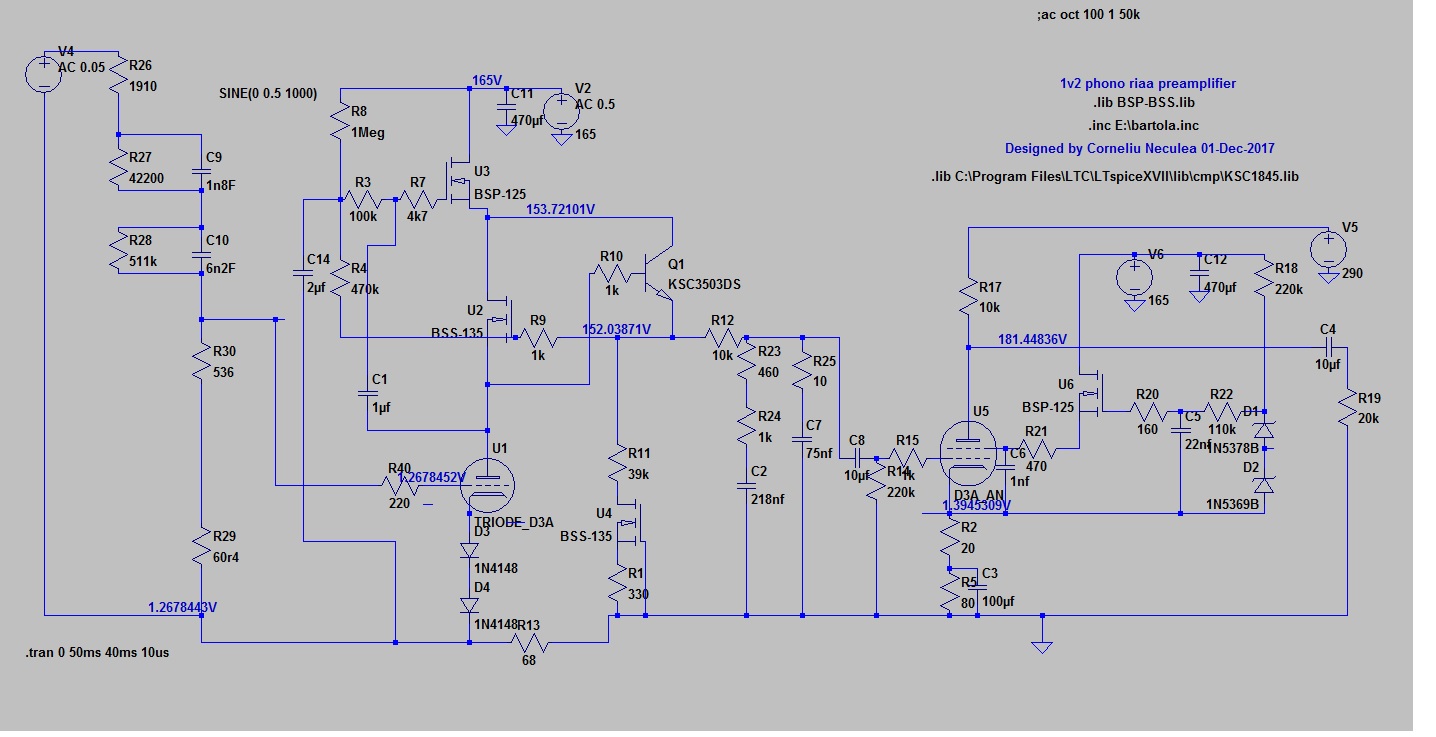

Contrary to that I would like to thank Dadod for posting it on this thread, I would have missed it otherwise. In addition, a statement was made that is pertinent to a discussion we had in this thread: CFA versus VFA. My own position in this is utterly utilitarian: whatever provides the best solution for a given design spec. For others it appears to be a more principled matter.
So, my question to Dadod would be: why did you convert from CFA to VFA?
In general I applaud all participants in this thread who show their work. All the more so those who produce at professional level without profit motive.
To convert this CFA to balanced inputs I added inverted input with H-bridge, and as consequence it became VFA. It still keeps all important CFA attributes.
