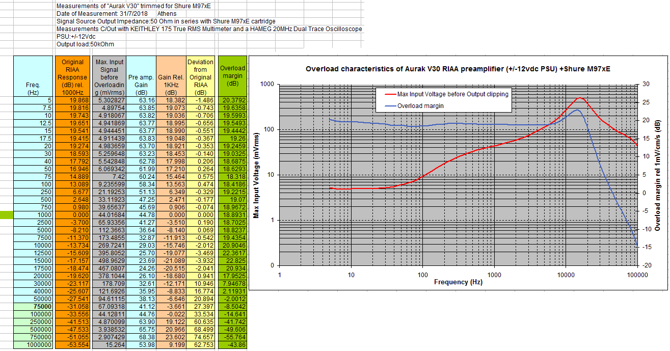

I am not educated in electronics and I don’t know what are the tradeoffs for designing with large overload margins. What I have experienced is that depending on the cartridge sensitivity (I have met MM cartridges ranging from 2.5 to 11 mV/5cm/sec) and the Vdc of the preamp PS plus elevated subsonic signal from the cart/arm/rumble, there is a real risk of preamp overloading.
A lot of hot MM cartridges have got a bad name as harsh, only due to overloading of the RIAA pre (music signal rides over subsonic signal).
I have got the habit to measure the RIAA preamps that I copy and build together with the cartridge I intend to use.

The subsonic overload is also discussed in the Holman paper - seems it is often a bigger issue than at first meets the eye. A subsonic filter can remove the problem from downstream electronics and prevent speaker cone flapping, but will not prevent the front end overloading in severe cases, and especially with a hot cart or recording.

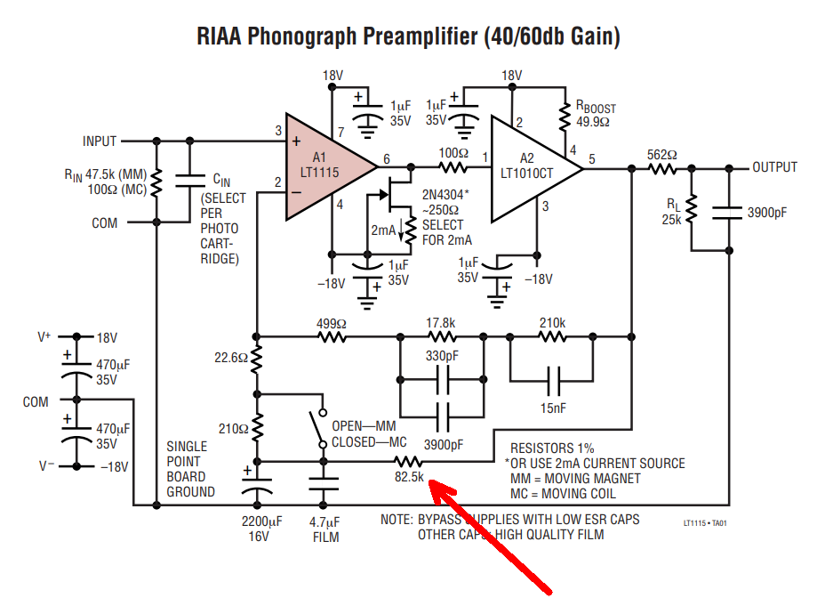

In all active equalizers, one trick is to run a resistor from the output of the opamp back to the top of the DC blocking capacitor where it connects with the lower arm of the gain setting resistor. If you select the resistor correctly, you get c 12 dB gain reduction vs 20 Hz at 6-8 Hz. The LT1115 data sheet RIAA has an example.

In all-active equalizers, one trick is to run a resistor from the output of the opamp back to the top of the DC blocking capacitor where it connects with the lower arm of the gain setting resistor. If you select the resistor correctly, you get c 12 dB gain reduction vs 20 Hz at 6-8 Hz. The LT1115 data sheet RIAA has an example.

That's the one. The spread in value on the DC blocking caps means you have to select them or adjust the resistor accordingly if you have concerns about LF response. My values are a bit different (my DC blocker cap is 470uF) and the resistor values were optimized on LTSpice. This solution works very well (measured).

470uF gives a MC low frequency corner of about 15Hz (slightly lower due to the cartridge few ohms impedance). I wonder how you kept the 20Hz RIAA with this single LF pole, the error at 20Hz is about -2.5dB.
