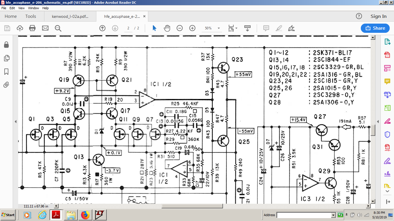

Holman claimed that a phono preamp should be capable of at least +22 db max output as i see on that plot of his. That doesn't mean that you can't listen to a preamp supplyed at +-15v with great results.Accuphase have proven this in E-206.But please be aware of the fact that the output of a phono preamp was designed to get into a subsonic filter, then a tone stack and after that a power amplifier , not a sound card ADC! Aiwa did a much simpler design with similar results for an mm setup at the same +-15v supply.... I just upgraded it at +-22v max power as i have the right op-amps to do it.

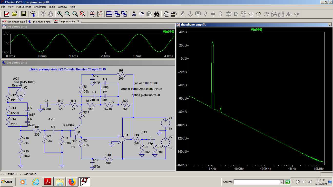

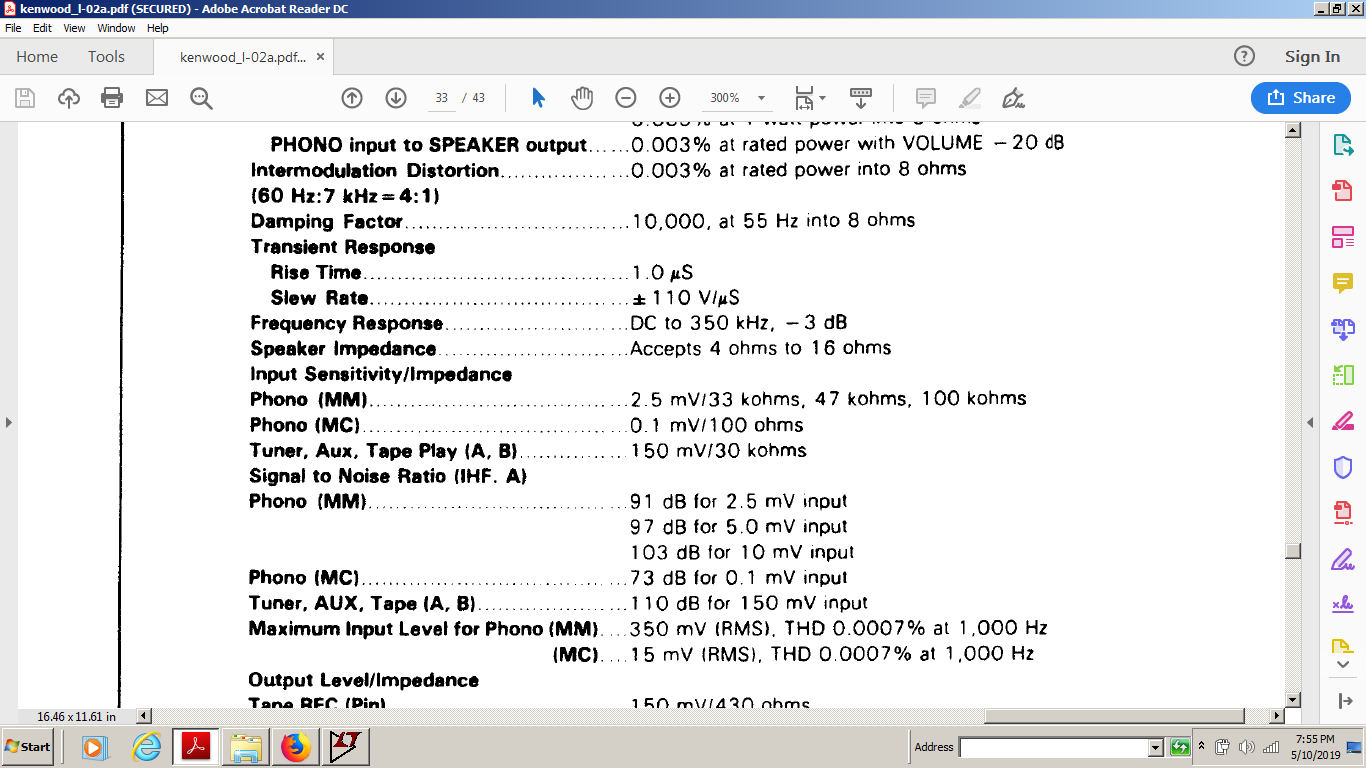

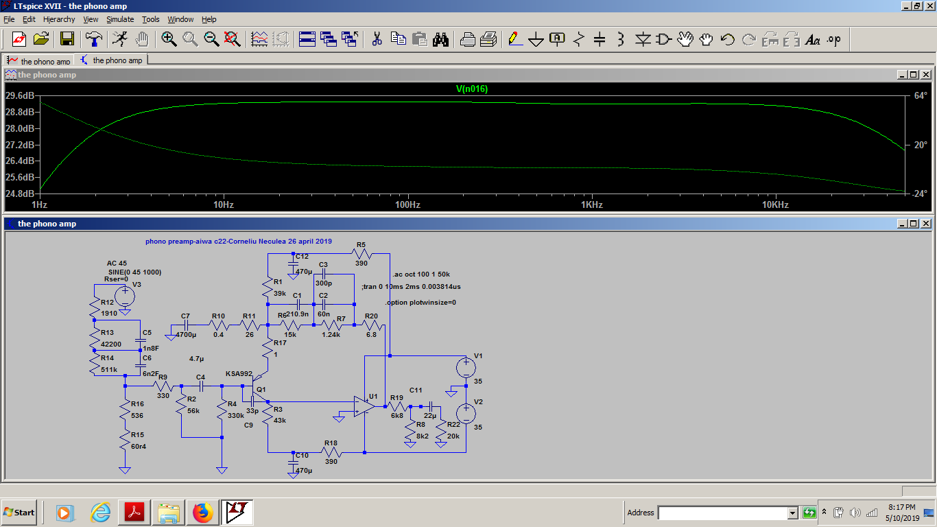

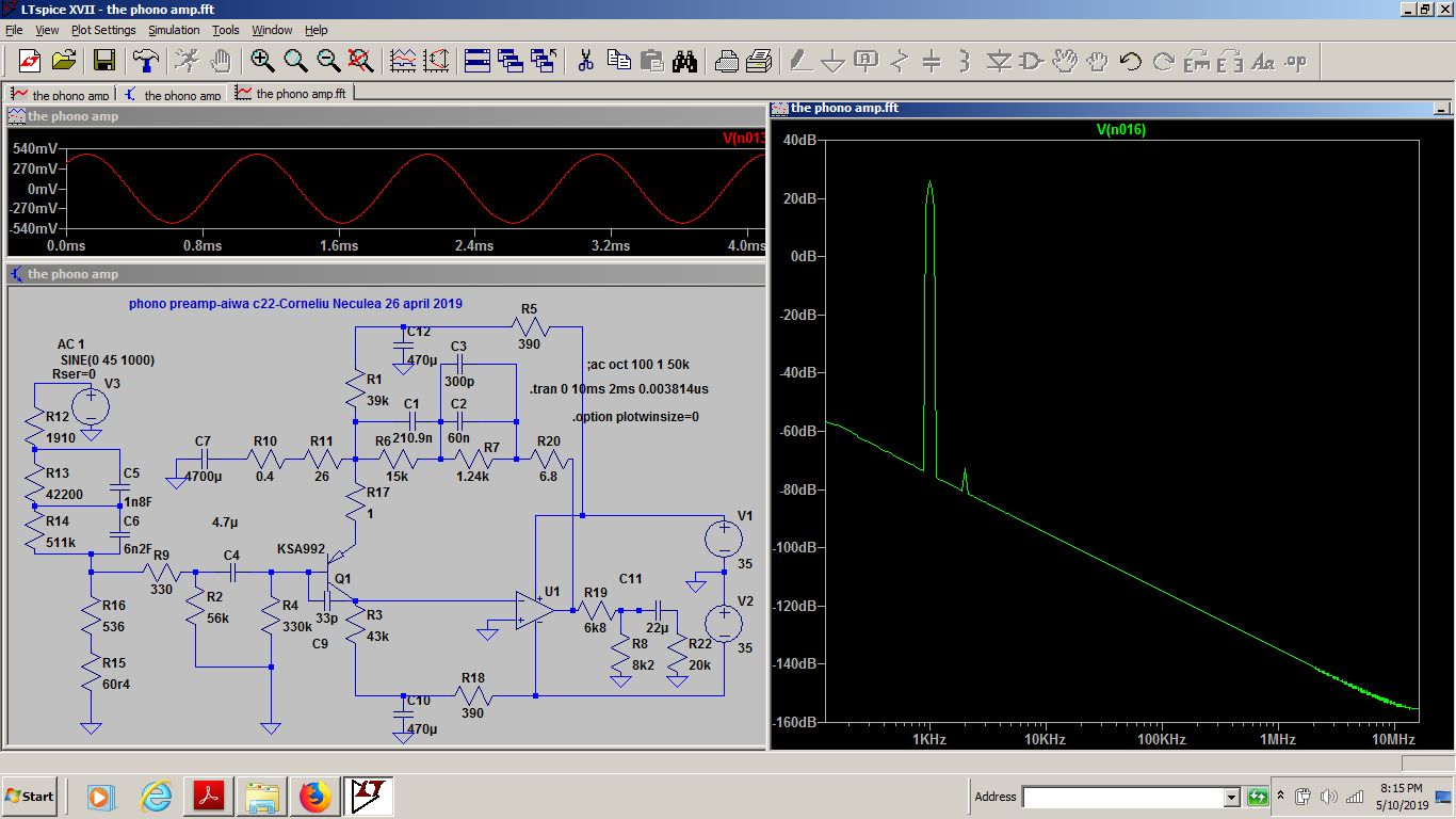

Just for the sake of confirming the data in the Kenwood -L02A service manual see some simulation i made with the input and outputs of a preamp using the universal op-amp model in the LTspice library and the K-L02 low impedance riaa network applied on a modified schematic version of aiwa c-22...yes the same aiwa c22 that i consider the best commercial preamp for the money ever made...
Only at a minimum supply voltage of +-35v i could get around -100db THD with the max input 950mv pk to pk or 350mv rms as specified in the kenwood service manual where they claim 0.0007thd, so their max input at 35.4 v supply for input and vas is correct... I'm not sure if you really need such performance, but if you can have it why not?The guys who listened that Kenwood said its a killer preamp, period.
The noise floor vs dynamics is always a problem with the usual gains , components and values used in phono preamps and cartridges.You can't get the dynamics ignoring the phono preamp noise itself so you need to take care of the feedback network impedance hence the power of the final stage in a phono preamp.
Do we need such overkill phono preamp? Not really, unless we need those 6db more than the max plot of HOLMAN... Yet i regret the fact that most of the good op-amps can't go higher than +-22v and just a few can accept +-25v supply, but then you have other problems due to noise level vs output and thermal regime imposed to an op-amp so you need a higher power amp too to get the extreme results imposed by a high end setup.

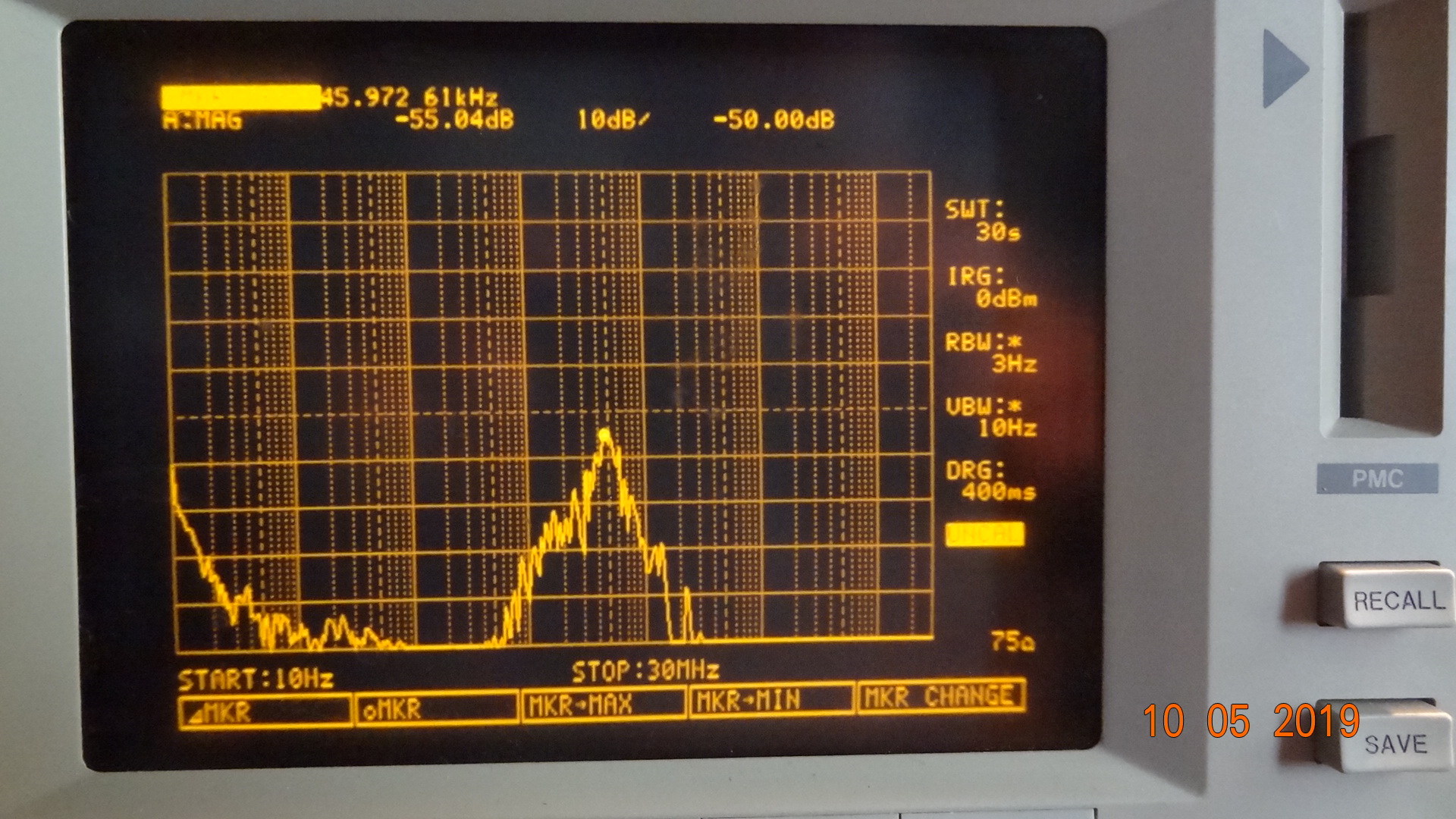

I just measured a DAC which uses AKM brand and its audio output also contains a lot of energy above 20-22Khz.
I had shown this from a Mastering Recorder last year. But other thingies which have DAC in them... over-sampling et al.... does this. But, not all, The BenchMark 3 DAC is free from any such output (<-100dbv).
This signal runs thru an output IC opamp and is there all the time.
