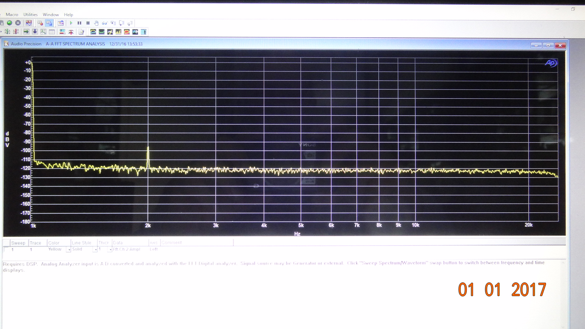

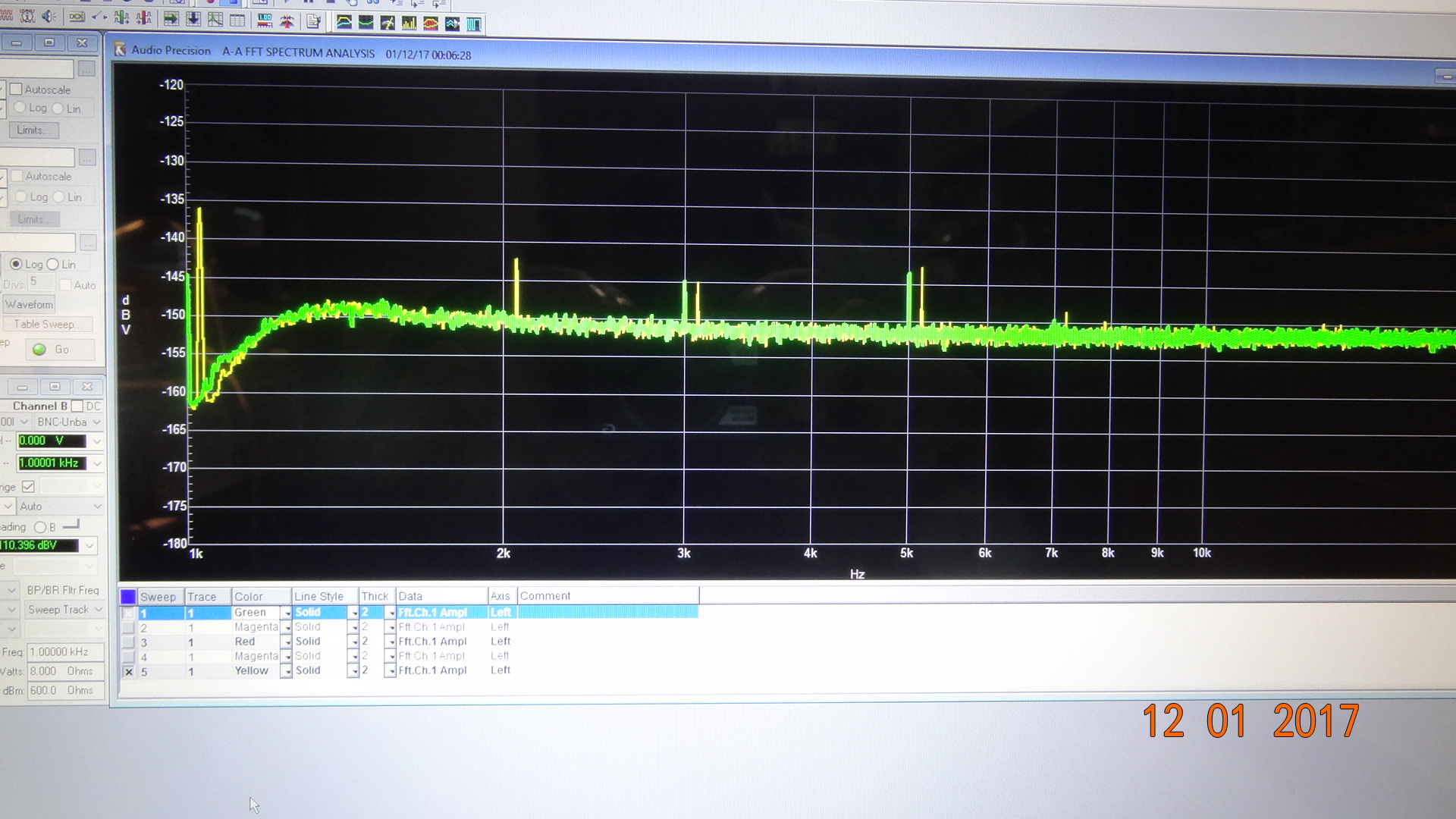

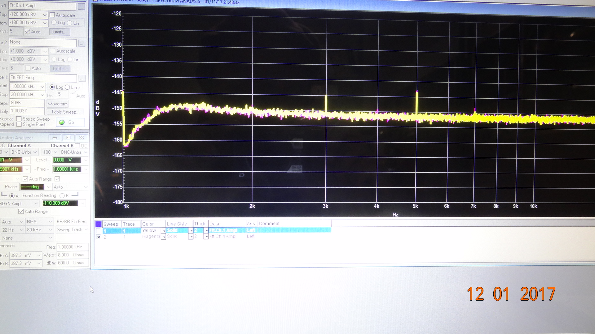

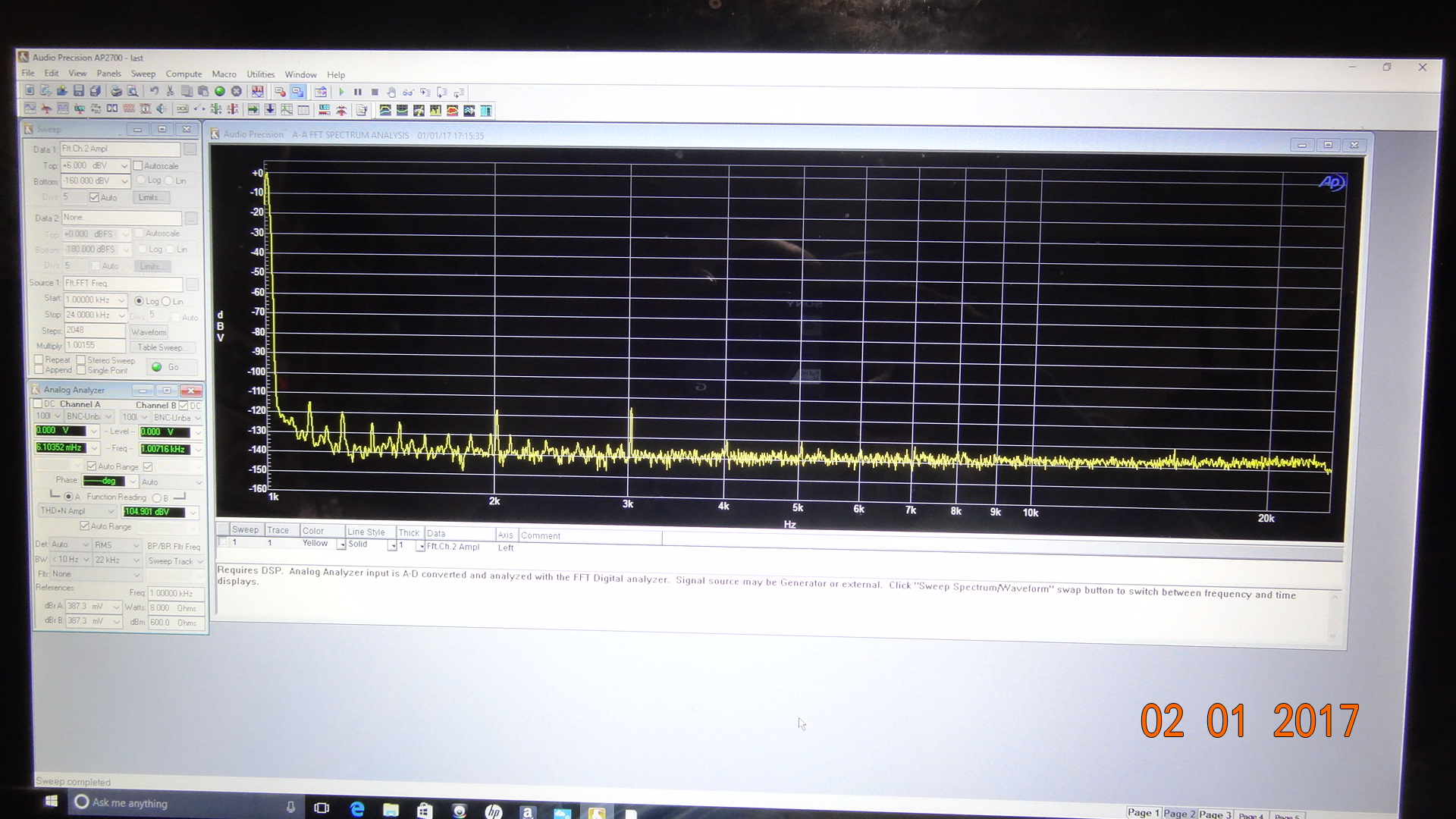

Richard, I don't think you tried hard enough to distinguish between fets and bipolar transistors. I used bipolars primarily for about 5 years before finally using jfets in the same topologies, both preamp, and power amp. I always had more higher order, primarily 5th harmonic show up with bipolars. It is in the inherent transfer function of each device. Of course tubes are even more linear, and if they had a complement I would use them exclusively.
Just saying with topologies I have used --- in practice, it either isnt there or extremely low. In which case it really doesnt matter.
THx-RNMarsh
Maybe. though I have never seen it happen with my stuff. Anyway, still does not produce miles of harmonics. Only 2H and 3H primarily in anything I see from SOTA amps.
With FET so hard to match closely and their compl..... if the noise and distortion can be designed as low and doesnt show this high order harmonic structure, then, there is NO good reason to use them exclusively.
Just saying I never see anything above 3rd.

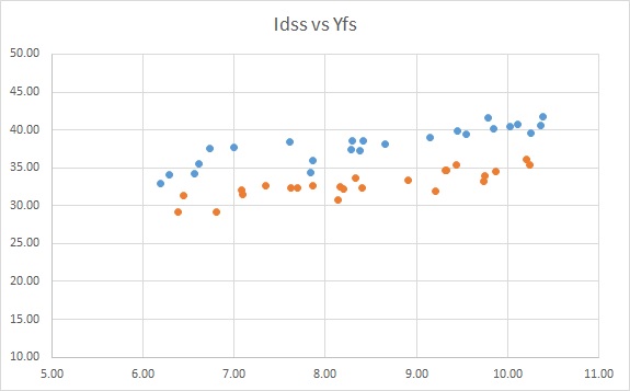

A few years back, I bought a random batch of 2 x 24 pcs. 2SJ74/2SK170 BL from eBay; no idea if they're real or fake, but the numbers look fairly decent, per sex.
However, if I wanted to make complementary pairs on both Idss and Yfs, it gets tricky. From the attached chart, it appears that the "natural" spread of Yfs is about 20%, with the "J" always having higher Yfs. I manage to find 3 pairs with <10% Yfs, or 8 pairs with <15% Yfs, the Idss being within <5% in all cases.
I guess it depends on the quantification of "close".
The Beta parameters are not the same so Yfs at the same drain current can not be the same if you simply try to match only Idss. So some folks pad one flavor with a small resistor as windage or degenerate with a small pot to tune up the result. This can not happen with bi-polars gm vs Ic is fixed in the physics.
