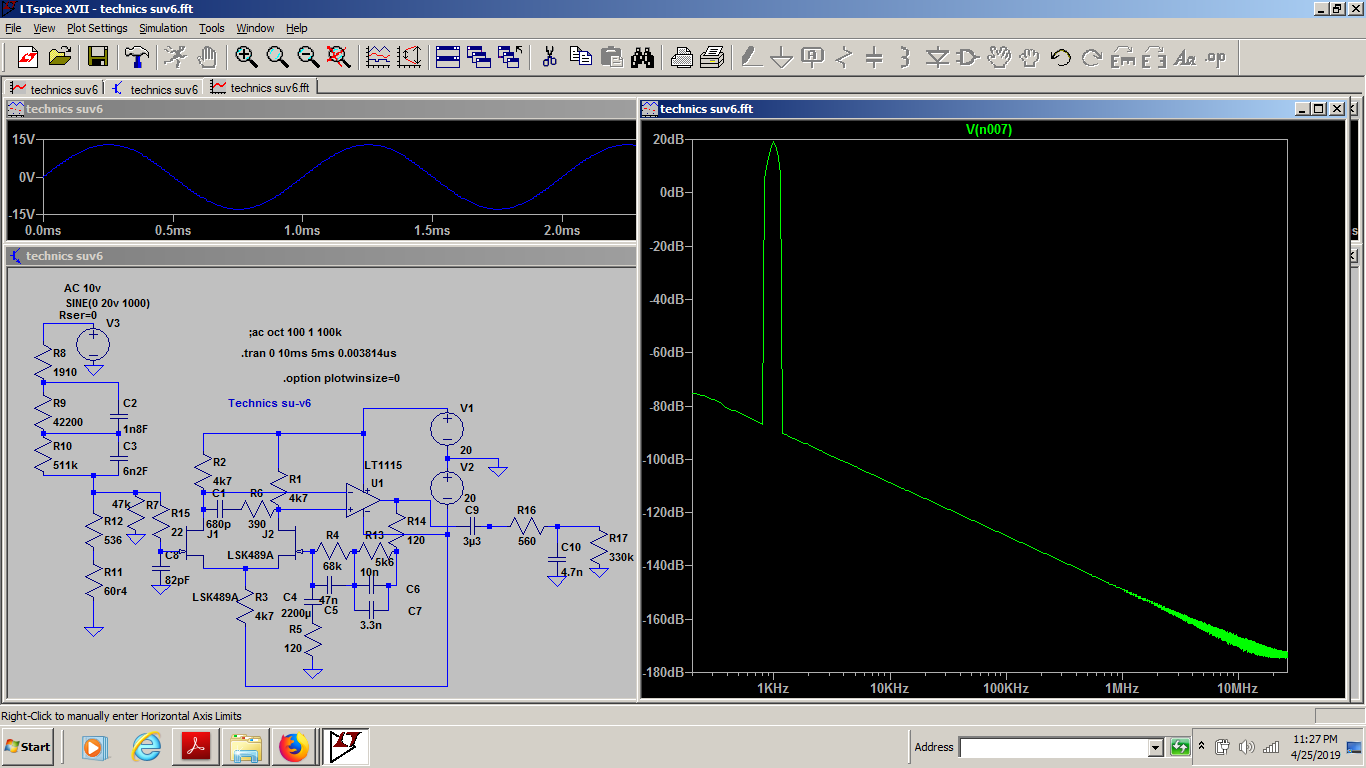

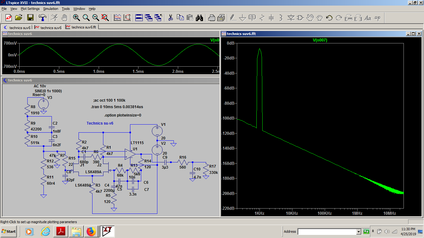

So i just spent some minutes to sim the classical Technics su-v6 phono preamp, which should give monstruous h3 and very low h2...You have the asc file too if you can get better resolution than i could.
