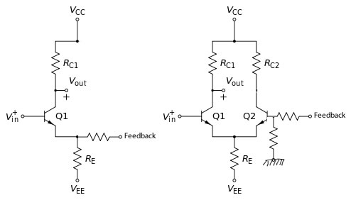

From your link:
VFA: Two gain stages (LTP+TIS) = higher OLG
CFA: One gain stage – 2nd stage TIS/TAS = lower OLG

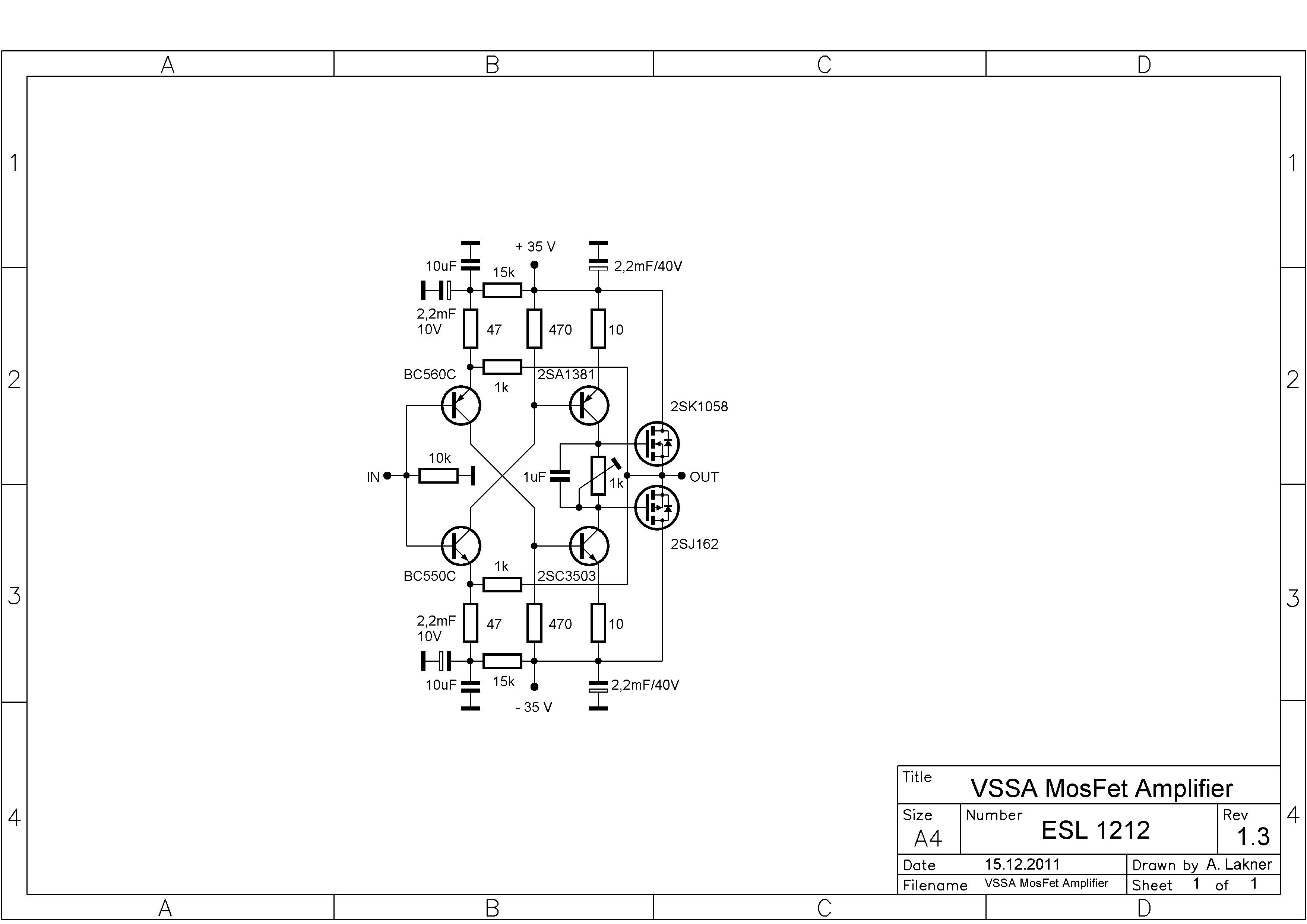

I don't agree neither. You can give some gain to the first transistor in the loop (that subtract feedback from input signal), or not, it is always (IMHO) a CFA because it don't change the way it works.
ex, from this forum:
https://www.diyaudio.com/forums/att...al-mosfet-amplifier-vssa-mosfet-amplifier-jpg
No I do not agree with you. But remember I was at the time talking about mainstream CFA and VFA to try to capture the essence of what the differences were which was a large part of the original discussion here in DIY audio.

No this wrong, and easily shown by simulation as he says. The H-bridge amplifier has a fixed gm set by the bridge resistor and input transistors gm and hence constant GBW.
The H bridge input stage would test out using the postulates in Table 1 as a CFA – the peak TIS
current is set by the buffer coupling resistor, and it is not constant gain bandwidth limited like a
VFA – a fact easily confirmed in simulation.
I think we misunderstand what each is referring to.
But, without even trying to untangle it.... I generally agree with Bonsai on his description of how a CFA works which is different from VFA.
-RNM
Give example, swapping the bridging resistor for each gain is not on the table. The comment was the IC industry insists on calling them VFA's but that's how they are sold. The same holds for bringing out internal pins for custom compensation of a VFA. Once the designer has all the options the distinctions seriously blur.
I'm only talking about H-bridge here, both input are high impedance there is no current in the feedback network entering the inputs. This topology adds slew enhancement a large signal property, GBW and stability are small signal properties.
