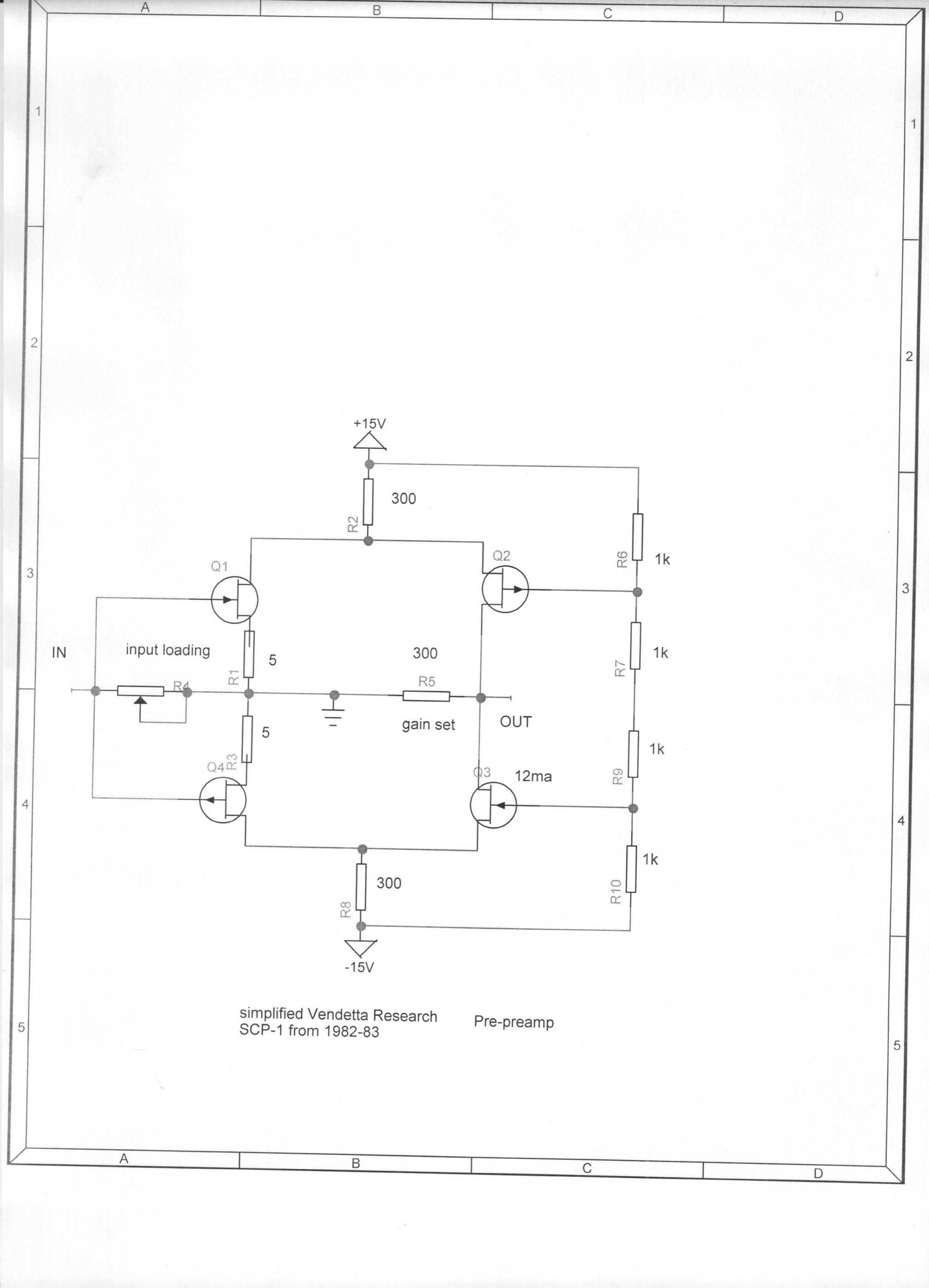

Just to make my statement clear: Of course there is a 3dB penalty for using differential. This is taught in university classrooms, etc and in many textbooks. This is obviously because you have to put 2 active devices in SERIES and their noise adds in the usual way.
So if you remain single ended, you gain that 3dB, but there is more with the Vendetta!
By putting a COMPLEMENTARY jfet also on the input, you have effectively put an active device in PARALLEL, which reduces the noise by 3dB. The Vendetta then DOUBLES the number of both types of input device to get another 3dB. So the total improvement is 9dB over a single differential pair.

6dB over a single differential pair. With 4x more unobtanium. Great deal!

I don't know the schematic but -3(dif)+3(compl)+3(parallel)=+3db...Would you , please indicate a link with the schematic?Sorry if i got it completely wrong!Just to make my statement clear: Of course there is a 3dB penalty for using differential. This is taught in university classrooms, etc and in many textbooks. This is obviously because you have to put 2 active devices in SERIES and their noise adds in the usual way.

Sorry John, we get to double up the diff pair too so 6dB for the same $$. This is all beside the point several designs have been presented over the last few years with ordinary parts that are between 0.28 and 0.4nV. In fact there are several 0.9nV op-amps out there and paralleling 5 yields 0.4nV and I'm not sure adding $10 or so to the BOM on these absurd $30,000 + pre-amps would make any difference.

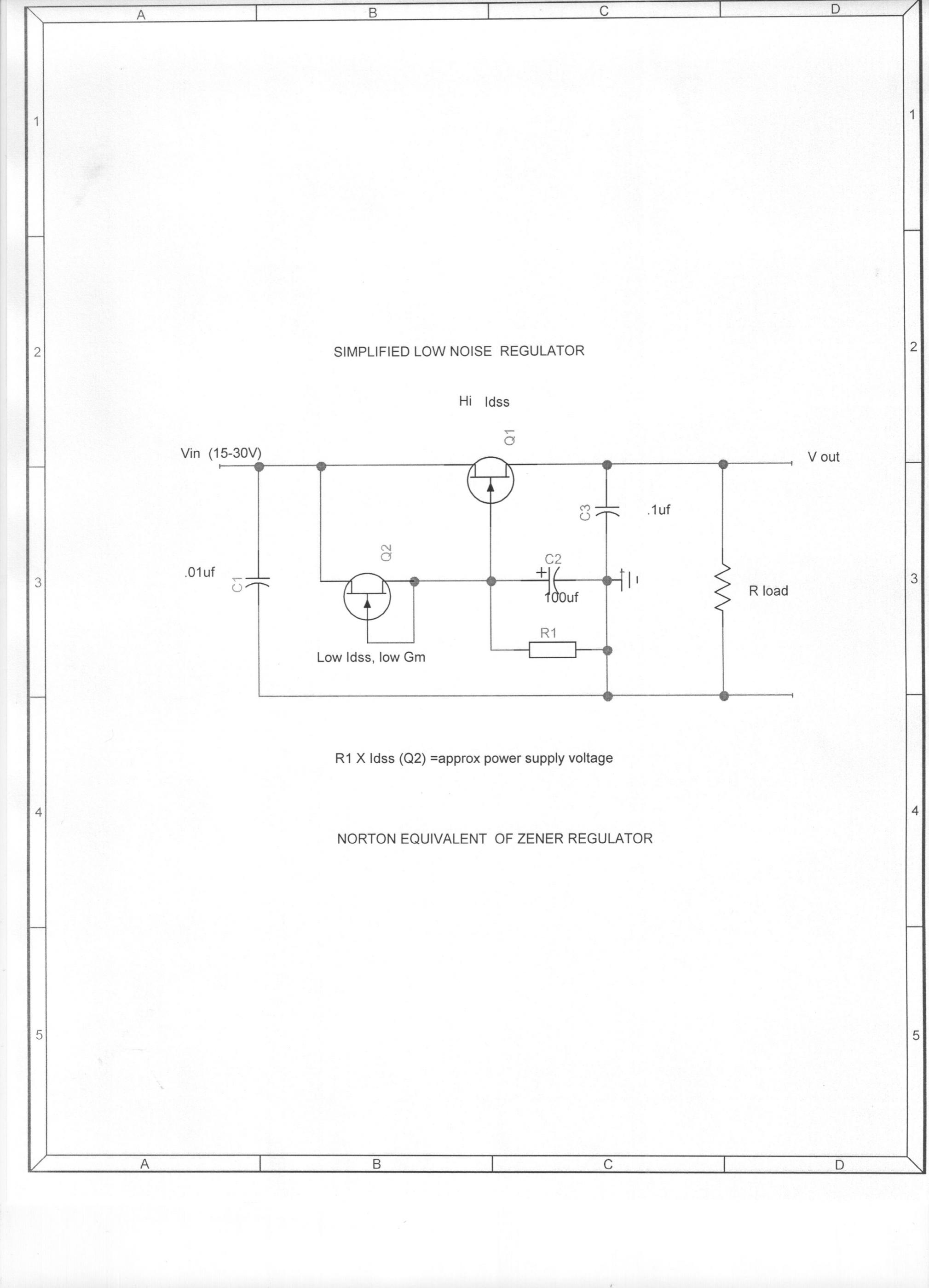

I am going to put up a few simplified schematics that show why the Vendetta is so quiet. Remember, this was 35+ years ago when it was designed. Any improvements since then?

pos: LT3042, LT3045
neg: LT3094
TPS7A47xx positive
TPS7A33 negative
Thank you. If you need fixed 5V there is cheap AKM AK1110 (dual LDO, one is 6nV/sqrtHz, second is 3nV/sqrtHz)
