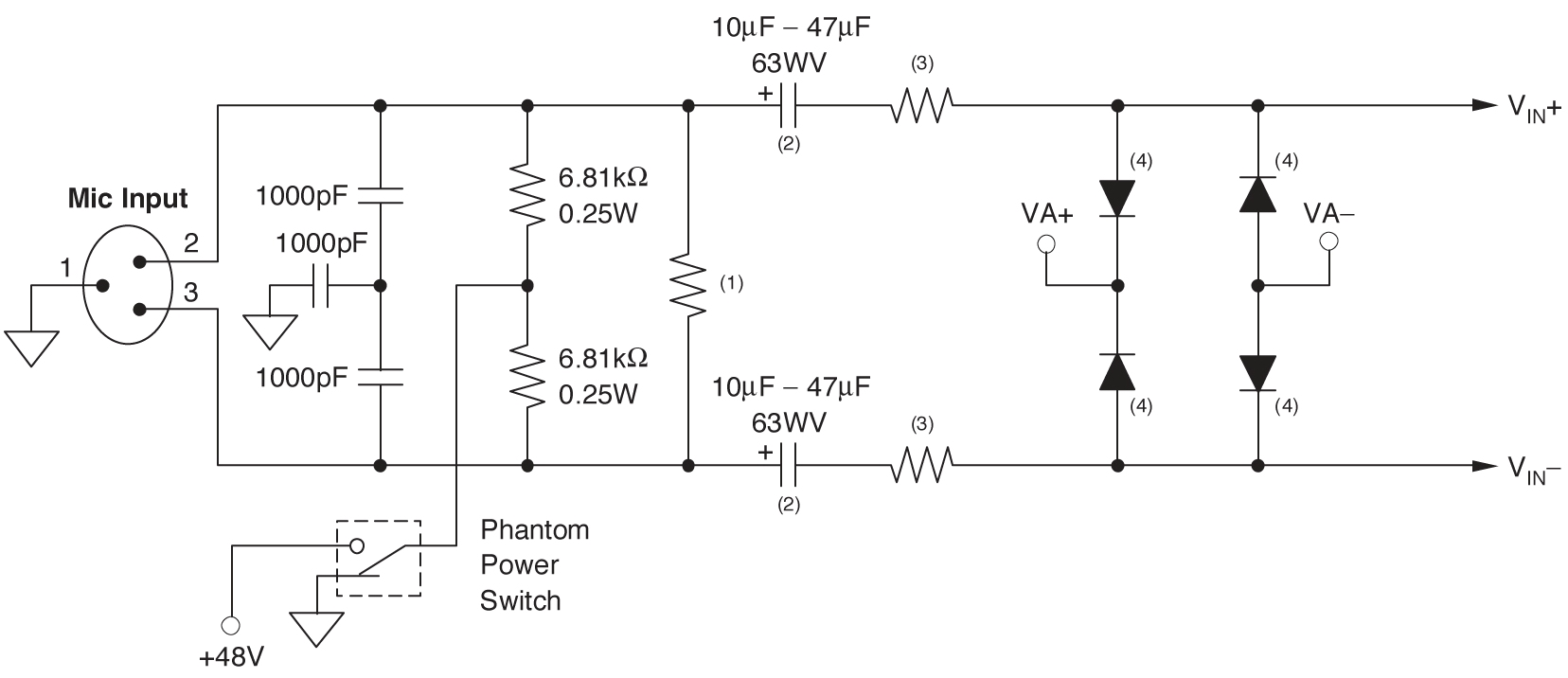

... BTW a large number of mics go through two large electrolytics used for phantom power at very low to moderate levels also with lots of low frequency noise due to wind, etc.
I don't advocate them and in fact like to avoid them by using high impedance circuitry.

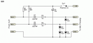

Someone should model/test these common mic circuits:
https://www.eetimes.com/document.asp?doc_id=1272487
Or Rod's
48V Phantom Feed Supply for Microphones
Small, delicate signals fresh from the real world (no dozens of opamps, no dozens of electro coupling caps), perfect for testing what yer talking about. 😉

PS An eager someone with the proper gear could post some hi res clips through the common circuit vs an optimized one for Foobar ABX comparison/signal analysis ...

Also note before it comes up the caps are there with or without the phantom power turned on.
