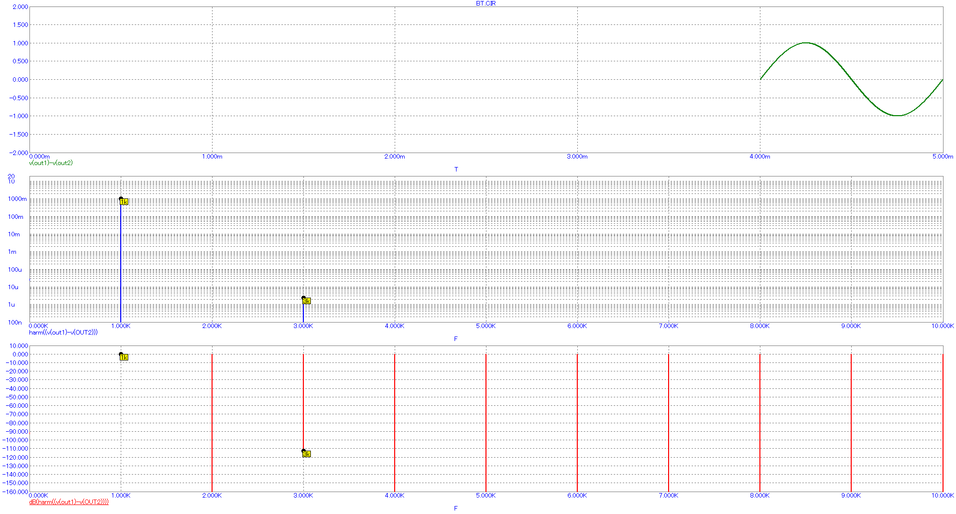

Same test rig I have used now for years and shown many times. AP System 2 XLR out and in. Generates 700 & 750 hertz equal parts combined to 10 VRMS. 10 Devices under test in a 4/1 and 1/4 bridge. I have almost a dozen different types to test.
Any signal applied to the devices should not appear at the output. However the limit to the null is the match of the devices. I use my GR bridge to sort the values and then assemble the best matched bridge I can from the values. Worst leakage of the test signal so far is - 60 dB from the test source. Unlike the resistor test shown there are no nulling pieces. Just selected capacitors. (Also note the triangle symbol at the bottom of the schematic is a balanced return not a ground.
As can be seen from the electrolytics used in this test they get noisier from the small DC offset of the AP's oscillator. Not surprising as there is no control on if they are forward or reverse biased. Inserting the COG capacitors in series with the source signal drops the base noise level. Adding a bias voltage also changes the result. Next test is with a bias voltage higher than the peak signal voltage.

OK Jan, here is both for 1Vp output, quite realistic value. You can see that in case of "appropriate JFET hand matching selection" the distortion is vanishing low and only H3 for these smaller signals.

There should be no voltage out from the bridge of the devices under test. Any voltage should be due to mismatch between arms of the bridge. There is a certain maximum suppression that can be obtained due to the mismatch. With the COG capacitors this is a bit better than -80 dB. With the electrolytic capacitors shown this is a bit less than -60 dB.
Looking at the COG data the IM products are a bit better than -60 dB. From past use this is more than I would expect from the AP's internal generator, but a double check is certainly in order.
Now if you look at the electrolytic's harmonic distortions they are more than 90 dB down from the test signal and clearly not from the internal signal source. Fine for many measurement uses.
However they would still produce seriously bad artifacts that would clearly be perceptible listening to music. If you took musical tones of 75 and 125 hertz-ish and allowed them to produce a similar pattern of distortion and then did an audio weighting on the source and result you would have a signal to noise ratio of less than 45 dB.
It is not the DC component that makes the distortion. It makes the noise I suspect. Further testing is needed to confirm that. The DC component does change the distortion, but so far no large changes.
