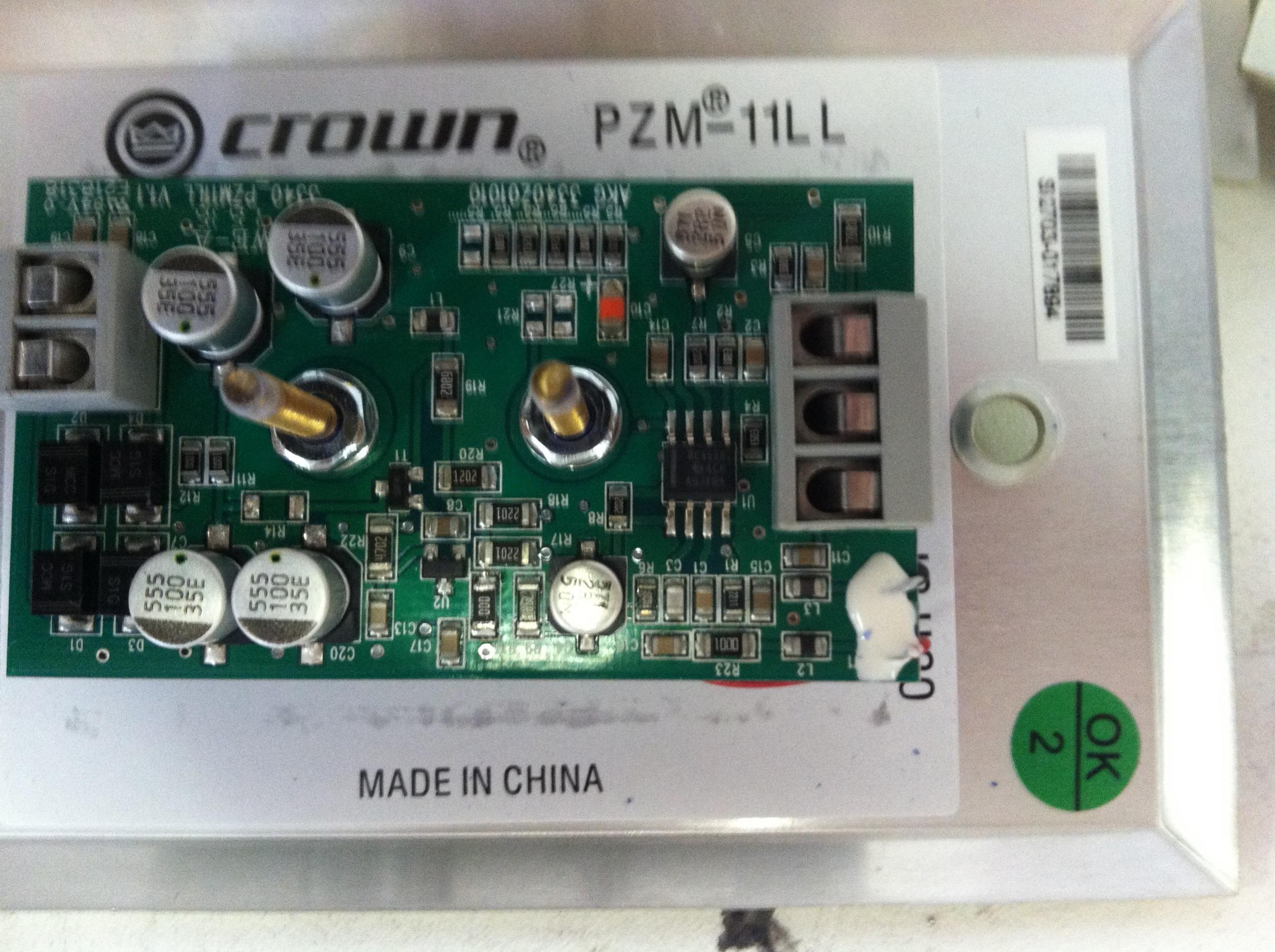

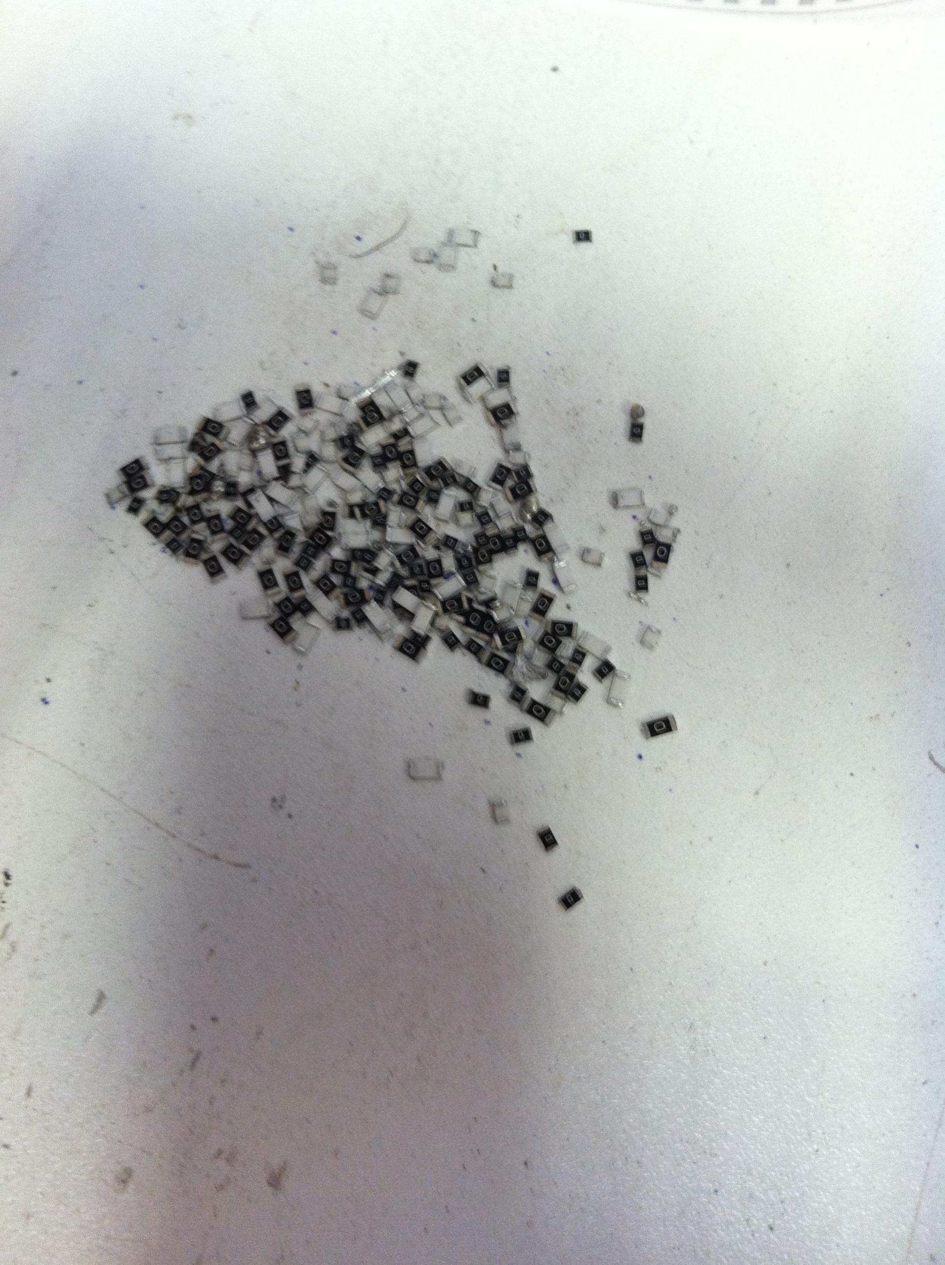

Well I have been busy modifying 150 microphones to change from external power supply to accepting phantom power. The manufacturer not only no longer offers the option, but has no one left to do it and does not even show a correct schematic.
So I splurged on a hot air rework tool and spent a bit of time removing 300 resistors and then adding 150 more. Each unit was tested after modification. Found one bad one. It was a cold solder joint on the output connector. As these microphones go into a very high security facility seemed worthwhile to check everything out.

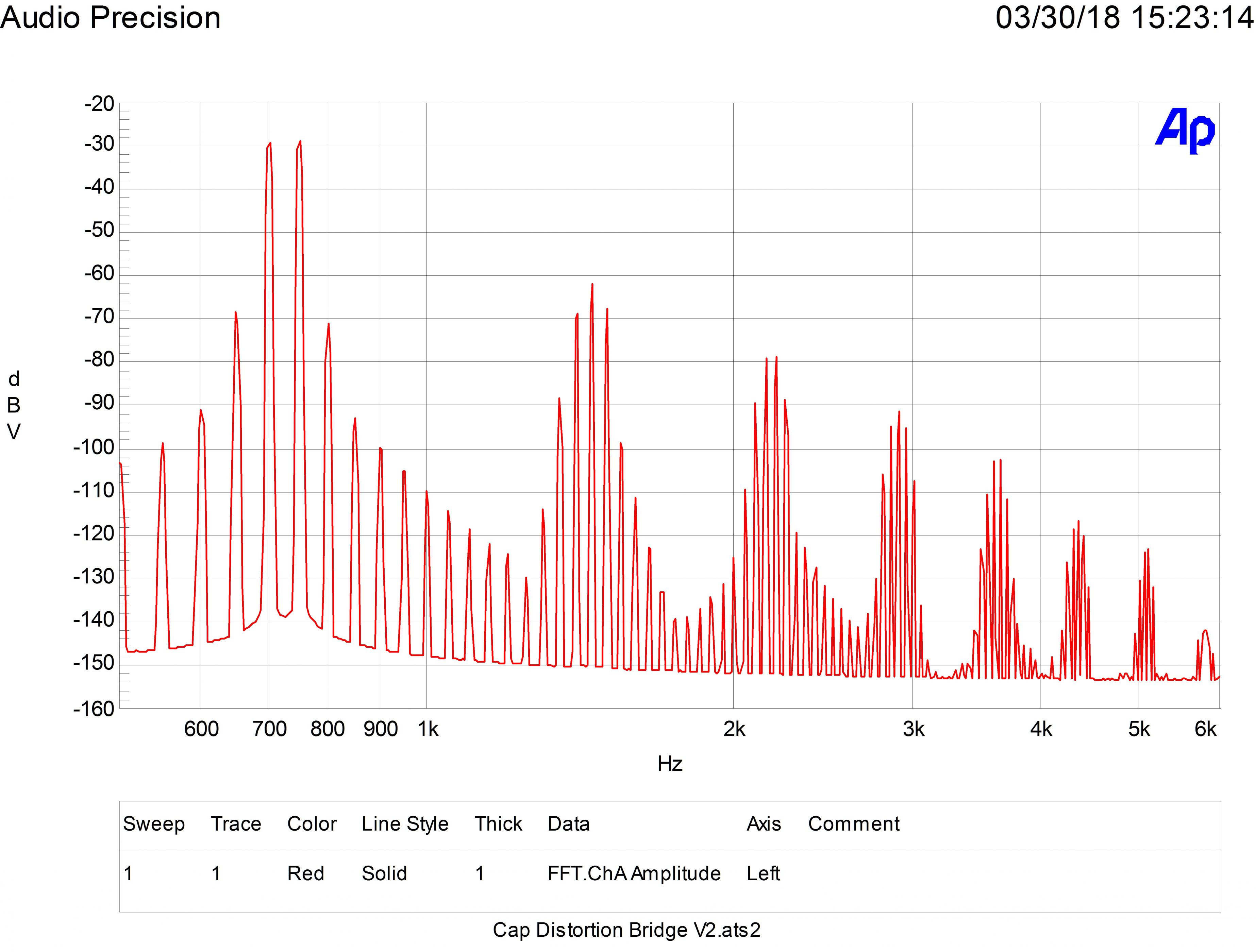

So been delayed in more capacitor play. First a couple of issues. Distortion does drop V^2 or V^3 as Scott mentioned and ruining one of my quiz questions for Derfy. Not surprisingly when the voltage across the capacitor drops so does the distortion contribution. Also I was able to verify that reverse bias on polarized capacitors does increase the noise floor.
In today's example not that the AP shows a bit of it's dynamic range limit of around 110 dB.
Nice. caps? size, value, type and load Z etc?

Actually I did check with a meter. Absolutely not uniform. For forward bias I wanted to be sure each capacitor had DC on it greater than the AC peak to peak.
For reverse bias I didn't really worry the effect was so large!

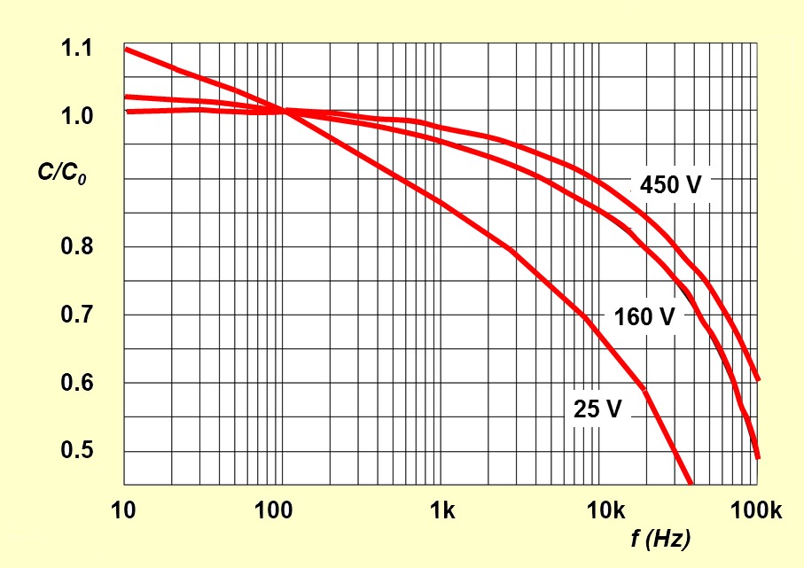

as I pointed out many times..... electrolytic leakage might or might not be a problem in your design. C change with frequency may also be an issue for you. All by themselves, they have no affect on thd. As would not high esr or esl.... no affect on thd.
end results all depends on your circuit parameters and what you need.
In high current apps (like speaker xover) the met film will have its esr modulated and increased esr (heating). You should then use film and foil if high current is to pass thru cap.

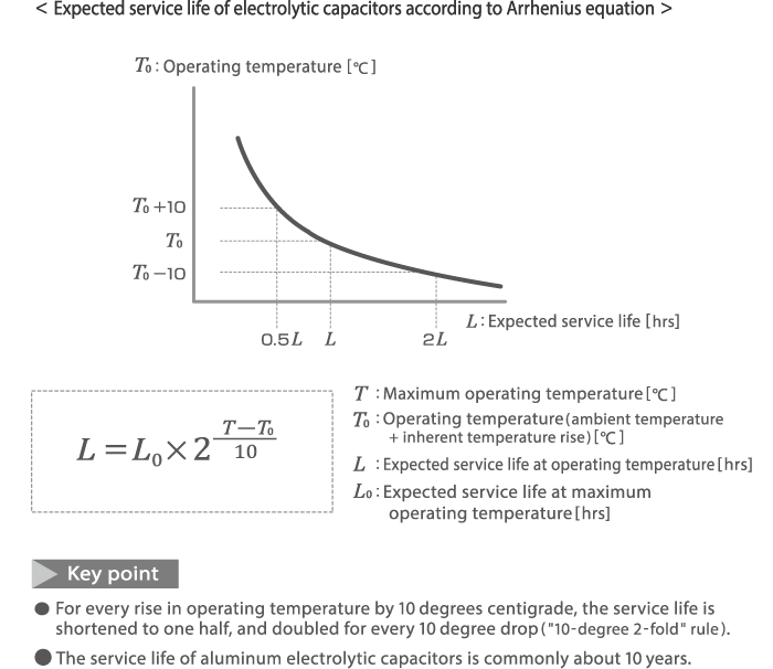

At the time of WJ and RM cap article there were a lot of tube products still in use and in the SS designs which mimicked their topology, poor quality electrolytics were used. Today, the electro is a lot better (lower thd). but they deteriorate all over the place. C changes might be important in a specific place. Like greater and greater LF roll off over time.
For the record, I did a lot of thd tests of caps also... Just didnt write anything about them. espec of back to back polar and paralllel polar and biased polar. Its just easier to go to film cap.
i had other reason for MY app to get ride of as many caps as possible on the system's accumulated LF end... (HPF ).each product rolling off, added up in a system and group delay was also an issue to me. But I never mentioned that about caps, per se.
THx-RNMarsh
(30-50% change may Not be your idea of good service life)
