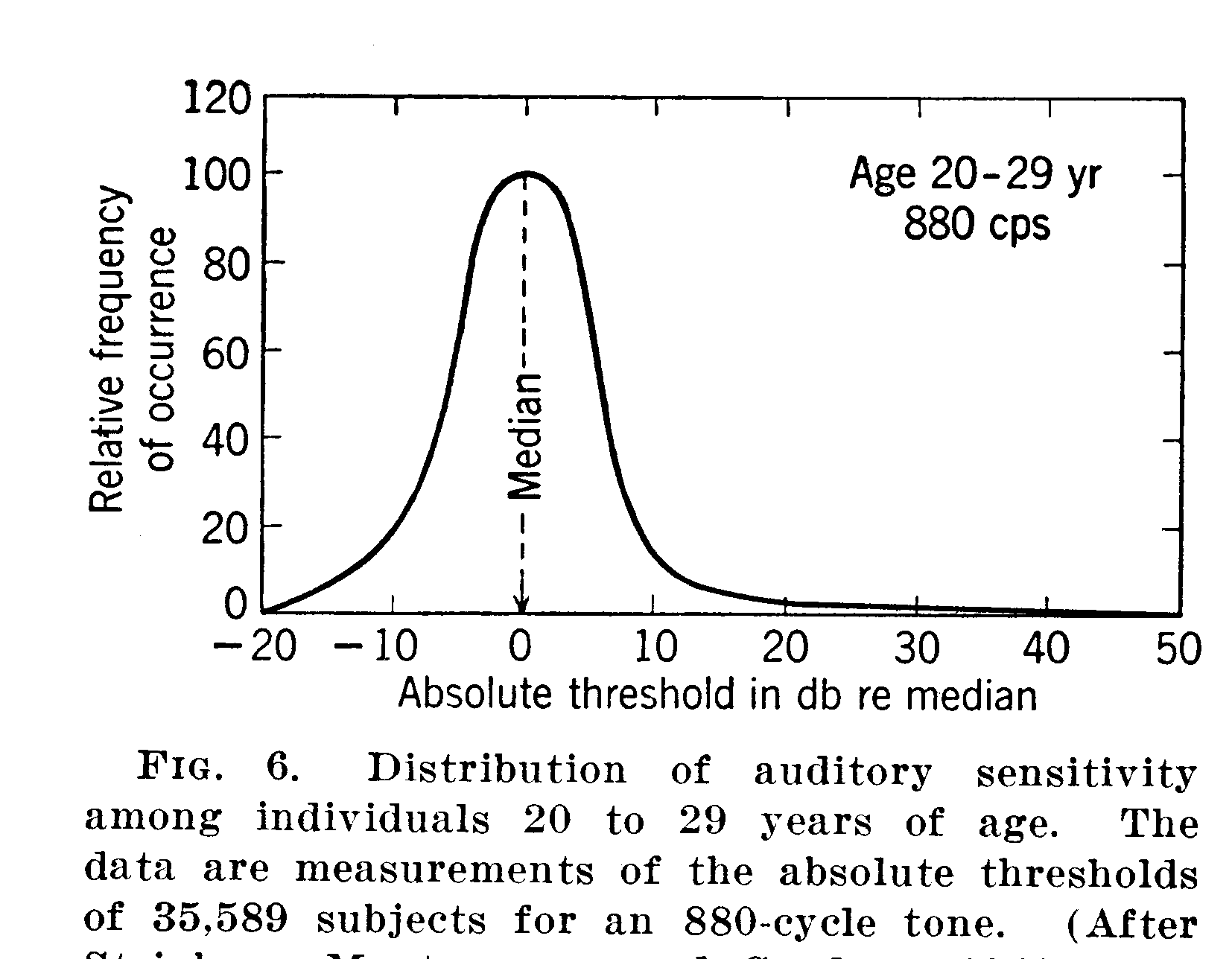

Can´t agree on that so easily; actually overall wrt multidimensional evaluation it is quite hard to say, but for single threshold parameters that were in fact examined in large scale experiments, it was common to find a distribution where 1% did better than 20 dB below the mean (of course 20 dB worse as well).
Based on the numbers from experiments done in the USA during the 1940s, for example single tone at ~880 Hz absolute hearing threshold; number of participants 35,589.
Licklider printed the graph in his contribution to the Stevenson Handbook of Psychology in 1951, page 997.
Obviously there are a lot more doing worse than doing better as a lower bound must exist due to physiological reasons.
Hard to swallow, not impossible, which means our perspective is probably closer than expressed. I give a decent berth not only to physiological, but training and natural talent to get them most out of our nature. That said, exceptional cases need careful examination.

Finally i could extract the graph, see the attachment.
(S.S.Stevens editor; Handbook of Experimental Psychology; John Wiley & sons,1951, 997)
That´s why i wrote, quantification for multidimensional perception is much harder to do, as hard evidence is rare despite the numerous experiments done wrt various formats (compression or DSD vs. PCM ). Having noticed a surprisingly (or maybe not that surprising after all) large spread in our experiments -and astonishing perception abilities on other occasions, i wouldn´t rule thing out without special care too.
