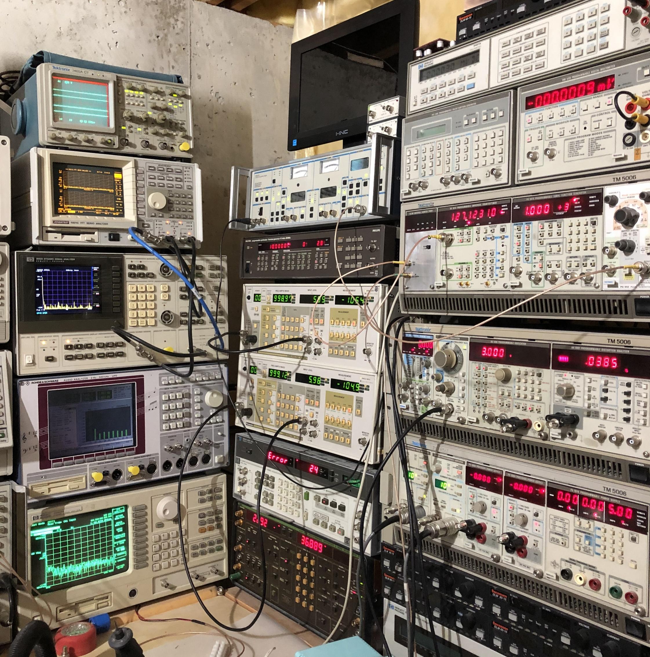

I hardly expect anyone to have good hard measurements on diyaudio.
Really?
Here's my audio corner. Left-right, top down
- Tektronix 2465A 350MHz analog scope
- Advantest R9211C LF analyzer
- HP 3562A LF analyzer
- Rohde & Schwarz UPD dual domain audio analyzer
- HP 35665A spectrum analyzer
- Stanford Research SR-530 Lock In Amplifier
- PM5193 function generator
- Panasonic 7722A distortion analyzer
- HP 8903B distortion analyzer
- Amber 5500 distortion analyzer
- Sorensen DLM60-10 power supply
- HP 3457A 7 1/2 multimeter
- Tektronix PFG5105 function generator
- Tektronix DM5120 6 1/2 multimeter
- Tektronix DC5010 frequency counter
- Tektronix FG5010 function generator
- Tektronix PS502 pulse generator
- Tektronix DC5009 frequency counter
- Tektronix SG505 low distortion generator
- Tektronix SG5010 low distortion generator
- Tektronix AA501 distortion analyzer
- Tektronix AM5030 current probe
- Tektronix PS5004 precision power supply
- Tektronix PS5010 power supply
- 4x Sorensen DLM60-10 power supplies
- HP 6627A power supply
Now show me something worth measuring. Bybees do not qualify.
