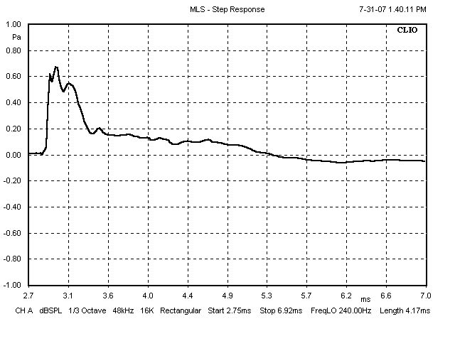

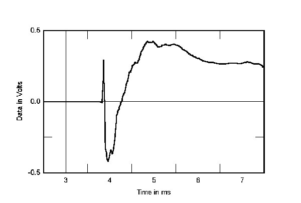

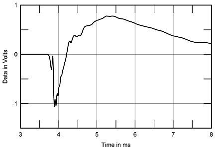

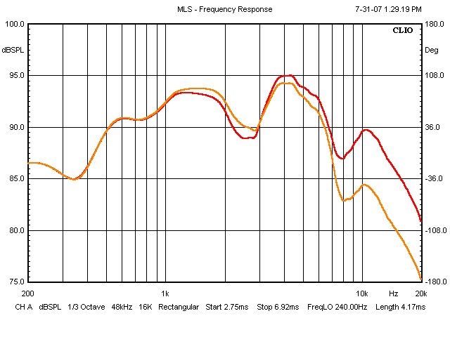

PMA, this is a good point for discussion: What about 'time response' and how much can we hear, and accept as high fidelity. Here are 2 time responses coupled with frequency response measurements for the speakers I am now listening to in my living room. One costs retail, 40 times the other. Yet I generally prefer to listen to the cheap one on REGULAR PROGRAM MATERIAL transmitted over Comcast, that is TV, FM, and music channels. My recent favorite is actually a 24hr blues channel that I listen to at about 70spl. It love it! Now, what is wrong with the $28,000 speakers? Please note the time response, and the abrupt tweeter cut-off. Yes, I can hear them.

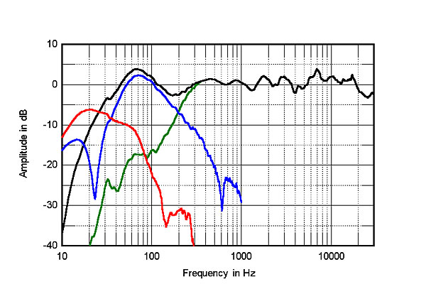

Here is an 'improved' speaker at twice the price, but better sounding than the standard Sasha:
It seems that, maybe, Sasha's tweeter to midrange transition is not optimal, not perfectly time-aligned. Also look at dips and ridges above 5kHz.
This would be Watt/Puppy, or Alexia. Better time alignment. You complain about all-pass response. This is an interesting point, however not sure (no evidence) about audibility, when, under what conditions exactly.

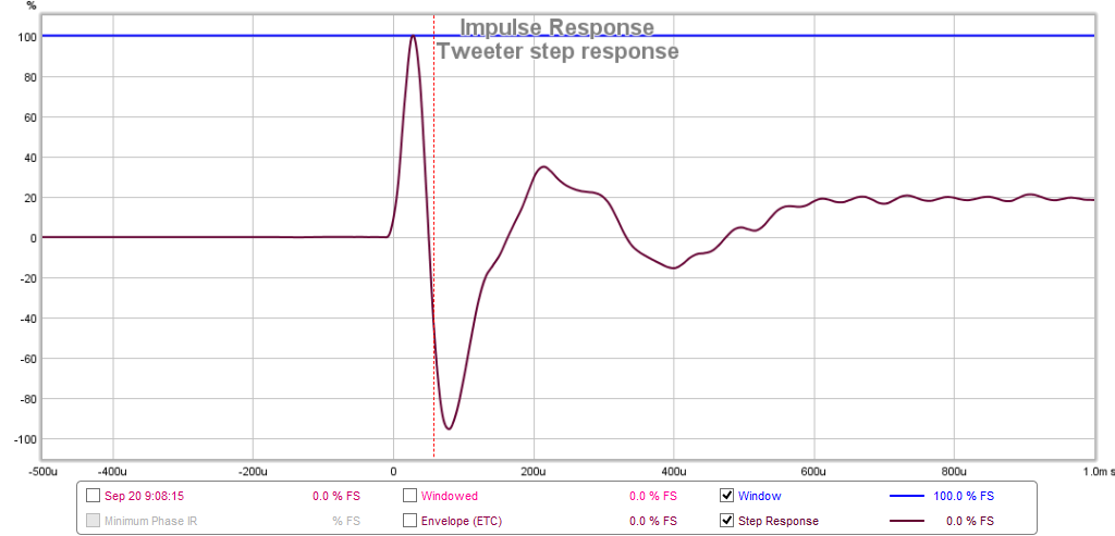

I would appreciate if JA posted step response measurement at higher Fs and also in more detailed time resolution. I would also appreciate if he not only posted a step response, but also an impulse response.
ENIGMAcoustics Sopranino electrostatic supertweeter Measurements | Stereophile.com
Oh well, JA can't do everything. I am personally too lazy to make the detailed measurements myself. Yet there is enough to discuss if you wanted serious comparison between the different speaker designs.
I mean a resolution (measurement) at least like this, when speaking about tweeters.
