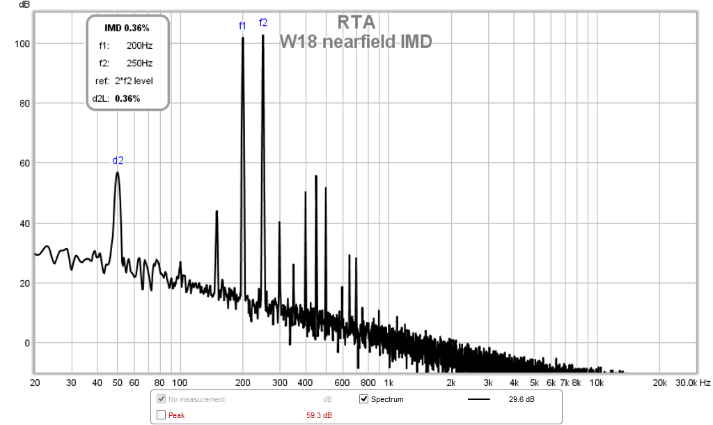

It would probably be better to do this test above Fs as eddies are better at higher frequencies, and so that the suspension nonlinearities aren't as much of a factor. So maybe 100Hz and 300Hz, but I don't know what frequencies you get useful coupling between two drivers. A 10x difference in frequencies would be ideal.
As an example, this is a 200+250Hz IM test applied to Seas W18NX001 driver. I can make more measurements, on demand.

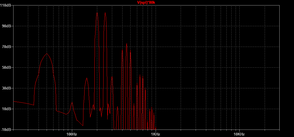

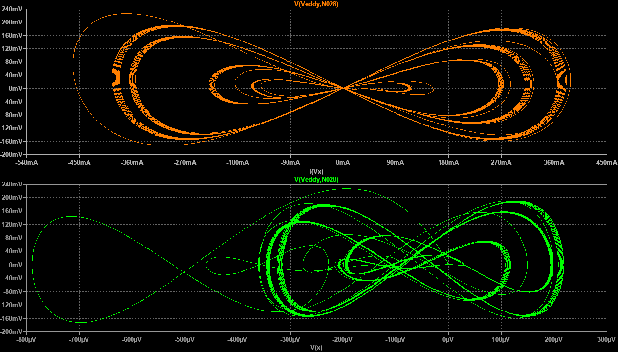

I opened my nonlinear speaker model and without changing anything, did the same test. 2 2.83V input sources at 200 and 250Hz. The scale is adjusted to match your graph as I don't yet have the constants to convert output to SPL.
That doesn't look anything like PMA's test results. Red lines on a black background, he has black lines on a white background.
Back to the drawing board, eh??
That is a seriously close result. Interesting.
Are both voltage drive?

I believe that is correct.PMA is measured?
keantoken is simm'd?

I flipped different distortions on and off and the only distortion that mattered in my simulation was the reluctance force, BL(i) for making the distortions seen in PMA's measurement. That one distortion explains pretty much all of it, anything else is hidden within that.
PMA, what drive level was that taken at? The specsheet is explicit enough I could make another model specifically for this speaker.

This is all reluctance force. At 200/250Hz the cone mass controls excursion so the suspension doesn't play much of a role unless you have an additional frequency near Fs to stress it. I have nonlinear suspension modeling but it mainly affects the 50Hz difference tone IIRC.
I'm curious if asymmetry in the sidebands or similar esoterica could be used to determine asymmetric reluctance from the magnetized steel?

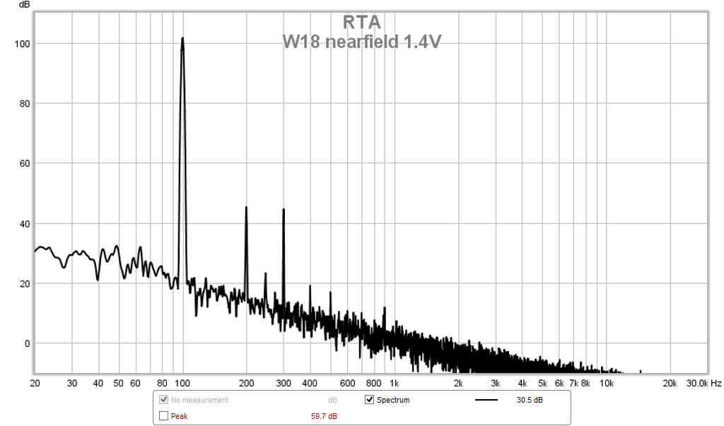

Keantoken, according to my records it was measured at 1.4Vrms. It was a voltage drive. I think your sim is quite close to the measurement.

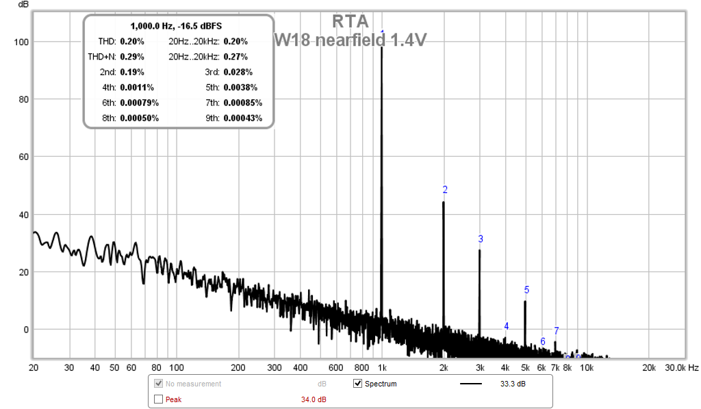

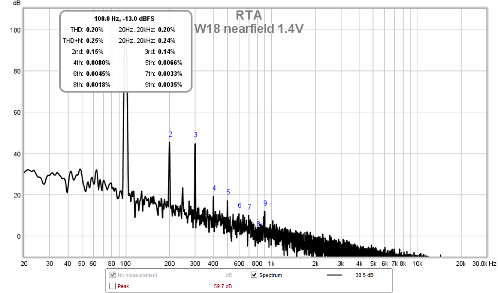

I also have a single tone measurement at 100Hz, 1.4V, voltage drive, and 1kHz. I think they correspond to the 200+250 test, almost only 2nd and 3rd (for 100Hz).
