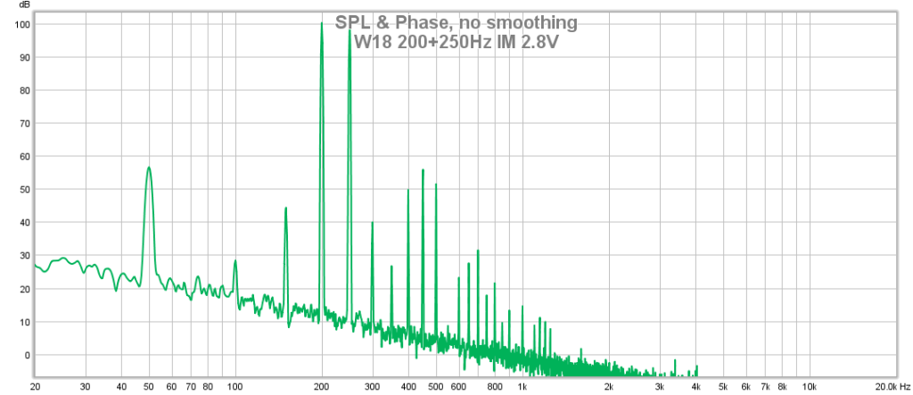

If I get the 50Hz and 150Hz+300Hz sidebands right, then the 200/250Hz harmonics are 15db too high. If I ignore the sidebands I can add distortions to get the harmonics right, but the 4th harmonic ends up being too high. It could be a crossover is modifying the speaker response and/or a vented motor structure is adding it's own distortion into the mix. It will be something I neglected to model, obviously.
I haven't decided on a way to model the ninja eddies. Do these eddies cause 3rd harmonics?

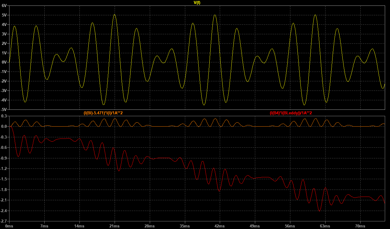

Some further thoughts on the ninja eddies.
Unlike eddy currents generated by a stationary coil, the eddy currents of a moving dipole magnet start in one direction and then reverse. It would seem the resistance of the currents to reversing would impose a limit on the maximum braking field. Inductance would be the principle limitation. Of course with eddy currents and variable current distribution, L and R could be anywhere depending on frequency.
I think a tube with no inductance (superconductor) would oppose a change in acceleration (keeping a magnet locked to one location), whereas a tube with inductance but no resistance would act like a spring, and a tube with just resistance would provide resistance. In videos, superconductive levitation always seems to behave somewhere between a spring and mechanical fixation.
Here's a question, do the current bands above and blow the magnet get closer together if the magnet accelerates? I think it would happen if it accelerates because that is like compressing the inductive spring. But then this brings the question of when the current distribution changes, what are the new L/R characteristics? It would always be somewhere between an inductor and a resistor. But if the current distribution has 2 dimensions of freedom at once, axial and radial, then maybe the resistance will dominate, explaining why the magnet in tube experiment doesn't seem to have any springiness.

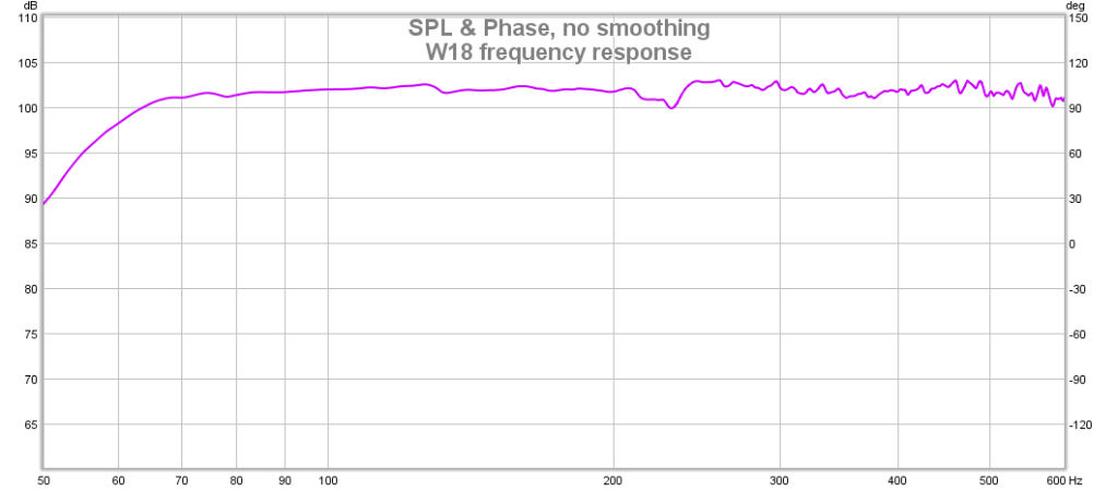

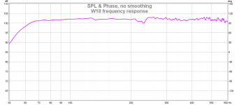

Yes there is a crossover, it was measured on a completed 2-way box, 10cm from woofer cone. The crossover flattens woofer response, see the plot (if you look at the W18 datasheet you will see it is necessary). However, point of crossover is at 2700Hz. I do not think that 200+250Hz sidebands and H2, H3 are affected much by the crossover circuit. And, it is an operating status.
Ok, but if anyone is serious about speakers, the crossover is the first thing to go, has to be bi- or tri- amped surely!
If one is serious about speaker FR measurement presentation, one use a 50dB scale range on the y-axis 😉

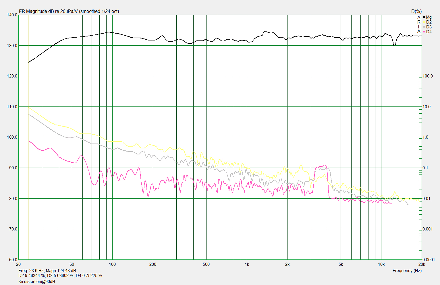

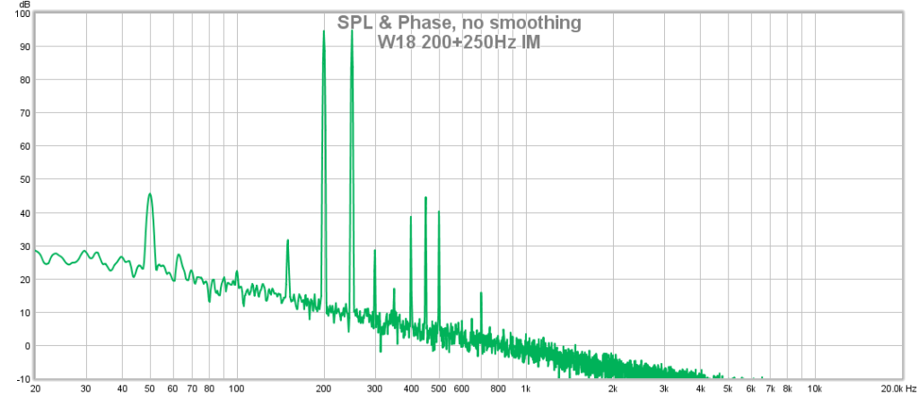

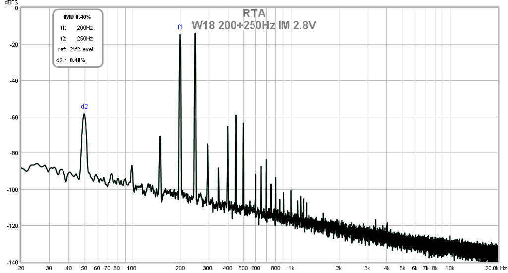

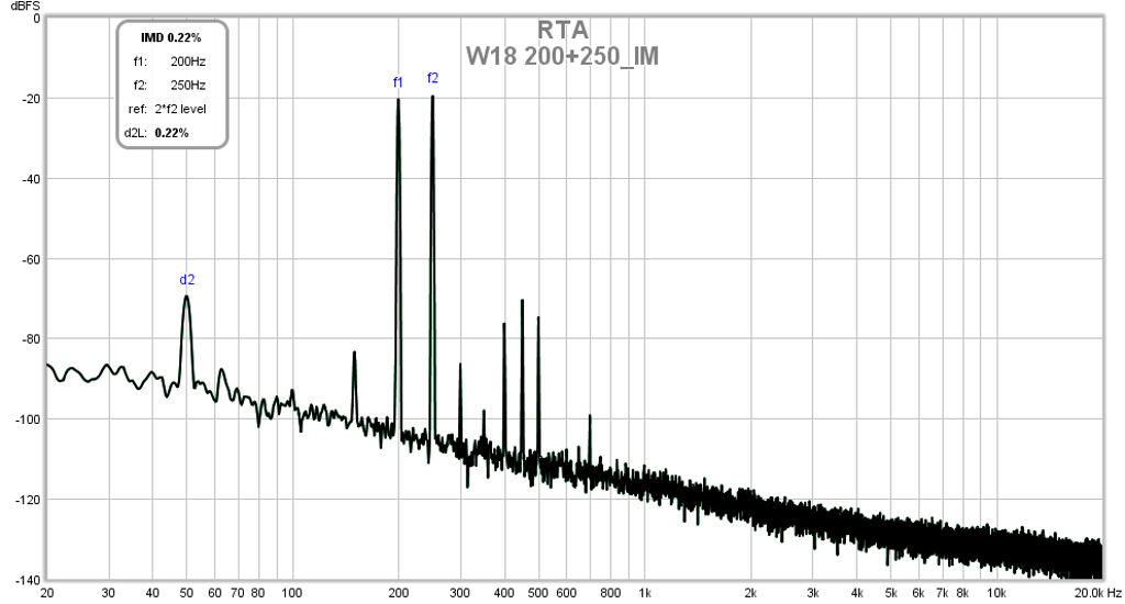

Keantoken, here is the repeated 250+250Hz IM measurement, voltage drive, 1.4Vrms. I am attaching not only plots, but also a zip file that contains a txt export from REW of the spectrum plot.

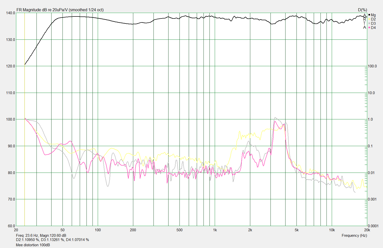

Since the point was brought up, here is a measurement of a speaker with two 5.25 " wooferettes.
100 dB anaechoic is seriously loud when boundaries are present. In stereo this combines on the low end to 106dB, plus room gain, it is enough for large rooms. Tweeter begins to fall apart, but on the low end distortion remains < .1 %.

Attached pictures are informational. Top trace is the force on the cone. Orange is the reluctance force. Red is the force due to eddies in either the shorting ring or the pole piece. Note that it has a rising DC component as the eddy voltage is polarizing the eddy inductance.
The distortions are similar, but out of phase. I thought about trying to use a laminated shorting ring to bring them more into phase hoping they will cancel, but the eddy force leads the reluctance force, what is actually needed is a zero resistance shorting ring (EDIT: Nevermind, the phase still isn't correct to cancel, and even if it was it would only be at one frequency). The closest thing to that is a driven coil as discussed previously.
Note the reluctance force should be pulling the cone in and the eddy force should push it away. The magnetics equations treat attraction as a positive force and repulsion as negative, but in a speaker repulsion is positive and attraction is negative. So I need to flip the polarity in the output.
