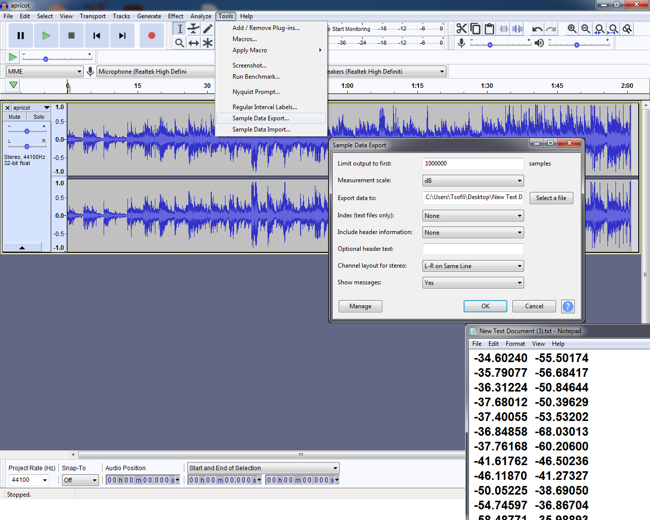

I can set it up again and collect data as a wave file I think. Not sure how to pass that to Excel and then do the postprocessing
In Audacity, open the wav file. From the "Tools" menu use "Sample data export...".
Maximum number of samples is 1000000 (22 seconds for 44100 sample rate recording). Sampled value scale linear or dB.
You save the data in a .txt file
In Excel from “Data” menu use “Get External Data”, select that .txt file
George

On the excel import, dont forget to select the column and make it "text" or it will convert the numbers to floating point and or think some are dates and scramble tose numbers.
