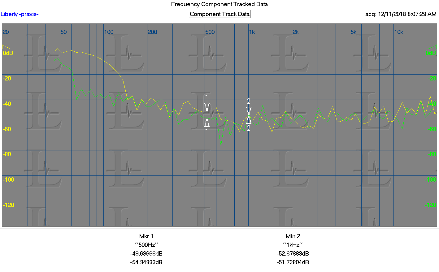

Here is a plot of H2 and H3 on the difference between the coils. I don't do this often so it well may be incorrect or just a plot of noise. The drive is 100 mV. More would be annoying at this hour.
Later I'll confirm what this is showing. . .
At only 100mV this looks prone to sink into a sea of noise. You are effectively measuring the distortion that the current is subject to under voltage drive. Indirect measurement, but very close. At low levels there isn't much to see.
Once the driver's limits are reached this distortion will sky-rocket. And it should be extremely similar to the measured distortion of the current itself, identical to first order at least.

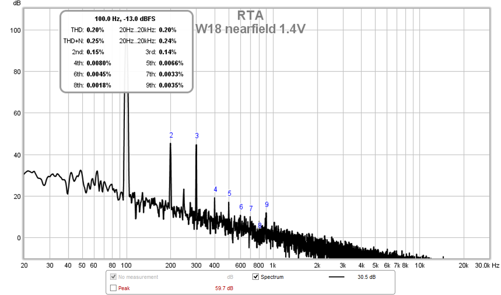

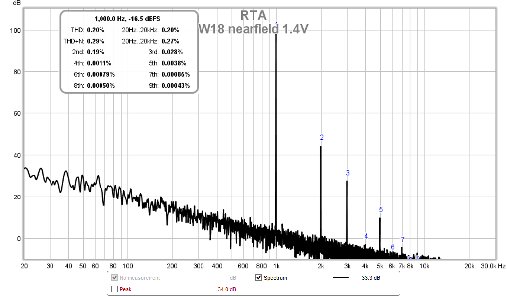

And I have shown a $205 driver. Cheap Chinese ones measure different.
On the other hand, W18's distortion also rises below 50Hz. But it is in percents then, not 60%.
