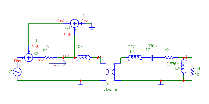

Or this way? This 2nd compensation makes the transfer function in fact equivalent to a current drive.
Are you suggesting a compensation like this?
On second thought, you are using the voltage across the .4 mh inductance as feedback.
My circuit cancels that out.. I assume the voltage across the gyrator is the real part of the terminal voltage?

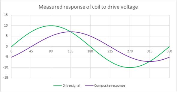

Here are the waveforms. The first is the composite voltage across the Ls and Rs. Ls is 90 degrees out of phase, Rs is in phase, so the composite or total, is somewhere in between.
The second is the individual components. The circuit intent is to subtract the out of phase content, as that is all reactance. Leaving just the resistive in phase component, which does all the work.

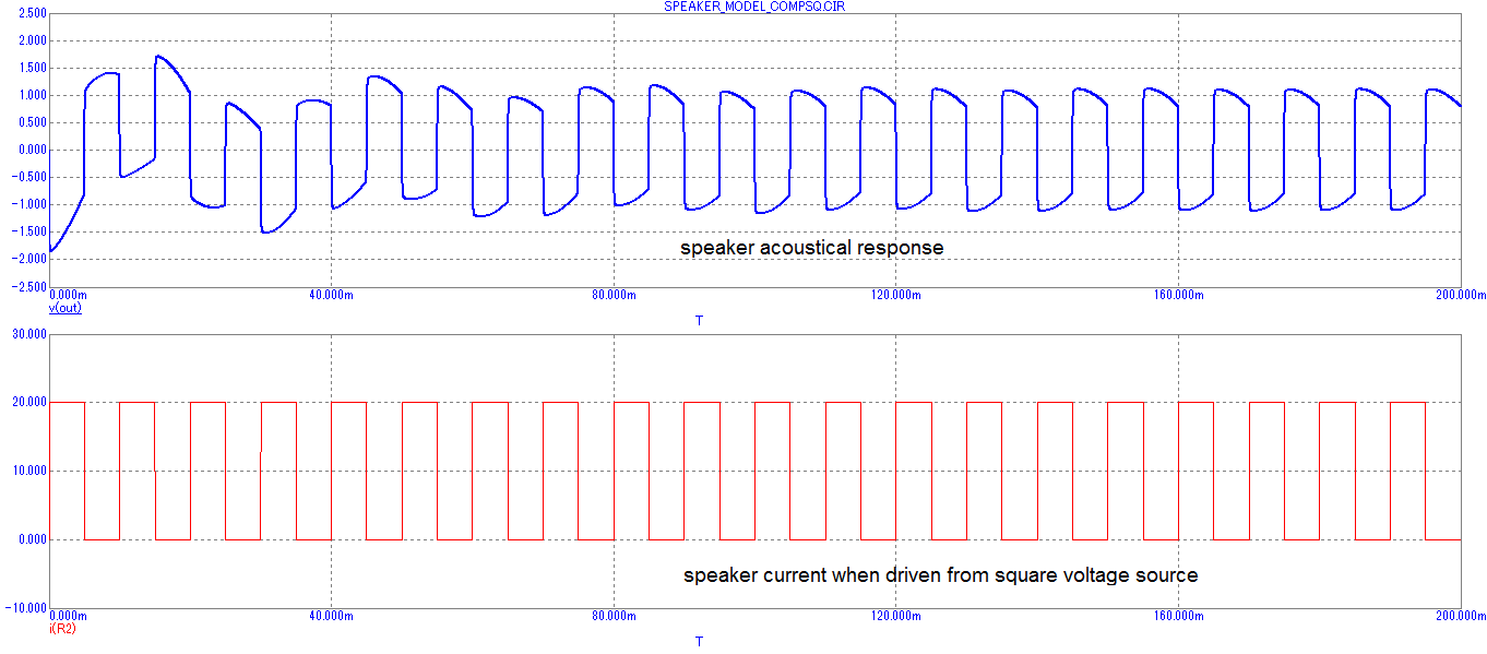

OK, thanks for the clarification, jn. However, please take into account what the voice coil in a real world is. The 1st scheme compensates just for Le value and non-linearity of Le. The 2nd scheme compensates for mechanical impedance as well and then you get in case is square voltage drive exactly square speaker current. Frequency response is then like that of the current drive.

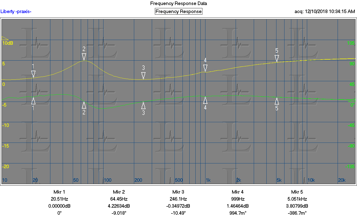

I think this is what you asked for. Plus terminals connected, amp connected to one coil. looking at the difference between low side of undriven coil and amp return.
I won't be able to strap this to a feedback network for a while. The amp is a venerable HP467A.

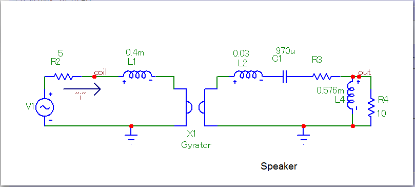

Thanks Pavel.In electric-mechanical lumped speaker circuit, the gyrator is used, as a standard, to allow electric-mechanical transformation, force = voltage, velocity = current, mass = inductance, compliance = capacitance, resistance = resistance. Serial = parallel. Bl is the gyrator constant.
Now in your electric-mechanical sim model
V1=Voltage source
R2=Voice coil DC resistance (Re)
L1=Voice coil self inductance (Le)
Gyrator=Bl (what value is your constant?)
L2=Total moving mass (Mm)
C1-suspension compliance (Cm)
R3=Total mechanical losses (Rm)
R4=Acoustic resistance (Ra) ?
L4= Air load mass (Ma) ?

1audio, can you do a freq sweep using the coil diff setup looking for distortion?
Jn
Demian, could you pls. also measure the way I outlined in #11250?
The point is whether the JN-scheme actually results in a current-drive characteristic as it is expected from the theory, especially wrt damping and frequency response.
Of course, even more important is whether it renders less overall distortion than current drive because it's not at all clear which scheme is the winner. That would require acoustical measurement (after establishing identical SPL transfer curves, if required, which should be easy as they are expected to be close to identical anyway).

Hi George,
Yes. Some remarks to R4//L4, they are a substitute scheme for mechanical radiating impedance transformed through membrane area (1/S^2) to mechanical side. R4 and L4 can be calculated from air density, membrane radius and area, and sound velocity. Bl = 0.2 in my simulation.
The point is whether the JN-scheme actually results in a current-drive characteristic.
I am not sure about JN scheme, but my simulation (No.2) resulted in a pure current drive from a pure voltage source. And there is an issue with transient response (resonance on acoustical side) as expected.
