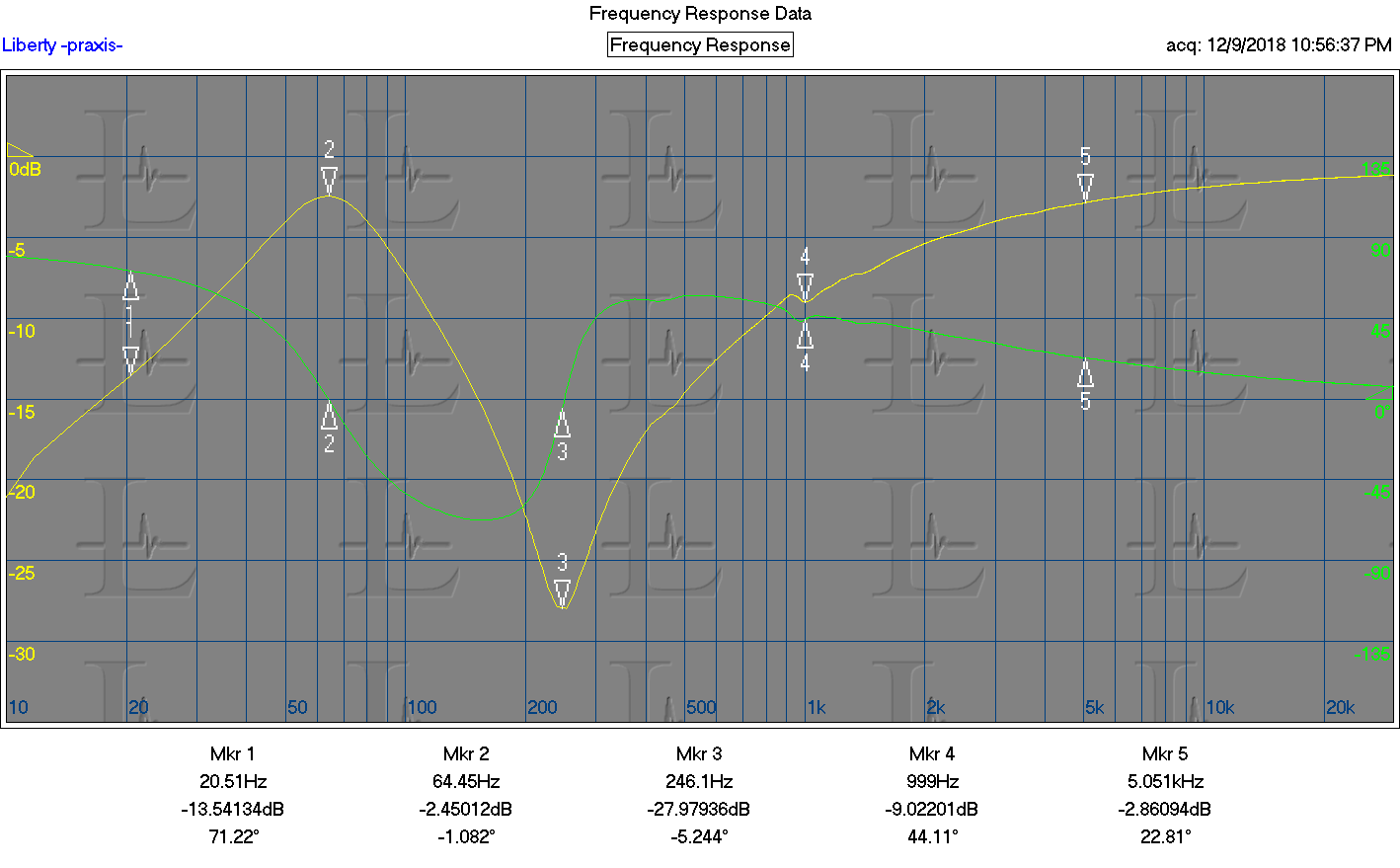

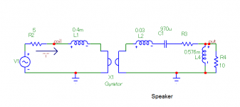

Dual Coil Driver Measurement
Here is the first measurement of a dual coil 6 1/2" driver sitting on the bench. Its the coupling between the coils. Its not just a transformer. I need to know what to measure next.
Impress a current on coil 1 and measure the voltage difference between coils. That voltage should closely track the current even at high freq., and it should be distortion free... even with the driver overdriven big time (hopefully it's a good design that doesn't bottom out).I need to know what to measure next.
If you don't have a current drive amp, use voltage drive and monitor current with a small shunt, and again measure the diff voltage of the coils. Then divide the transfer functions to see how close they relate, and also look at the distortion profiles, they should be identical. You'll probably need an audio measurement suite for this which can do log-sweeps and transfer function math,smth like REW/HolmImpulse/Acourate etc. Don't know if that Liberty SW is capable of handling and manipulating the *full* log-sweep data (that is, *with* distortion components) without majot effort.

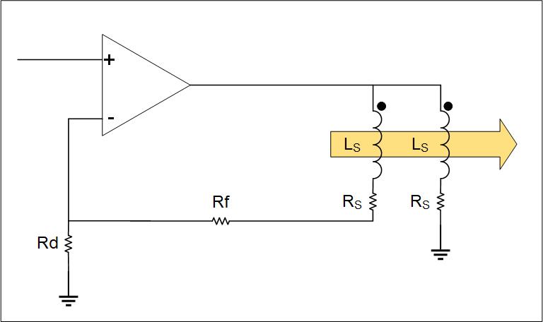

Direct control loop on the coil 2 voltage has been tried by many people and they all ran into the problem of coupling at high freq. Some have build a compensator that cancels most of the coupling and could achieve about an octave more upper bandwidth limit.

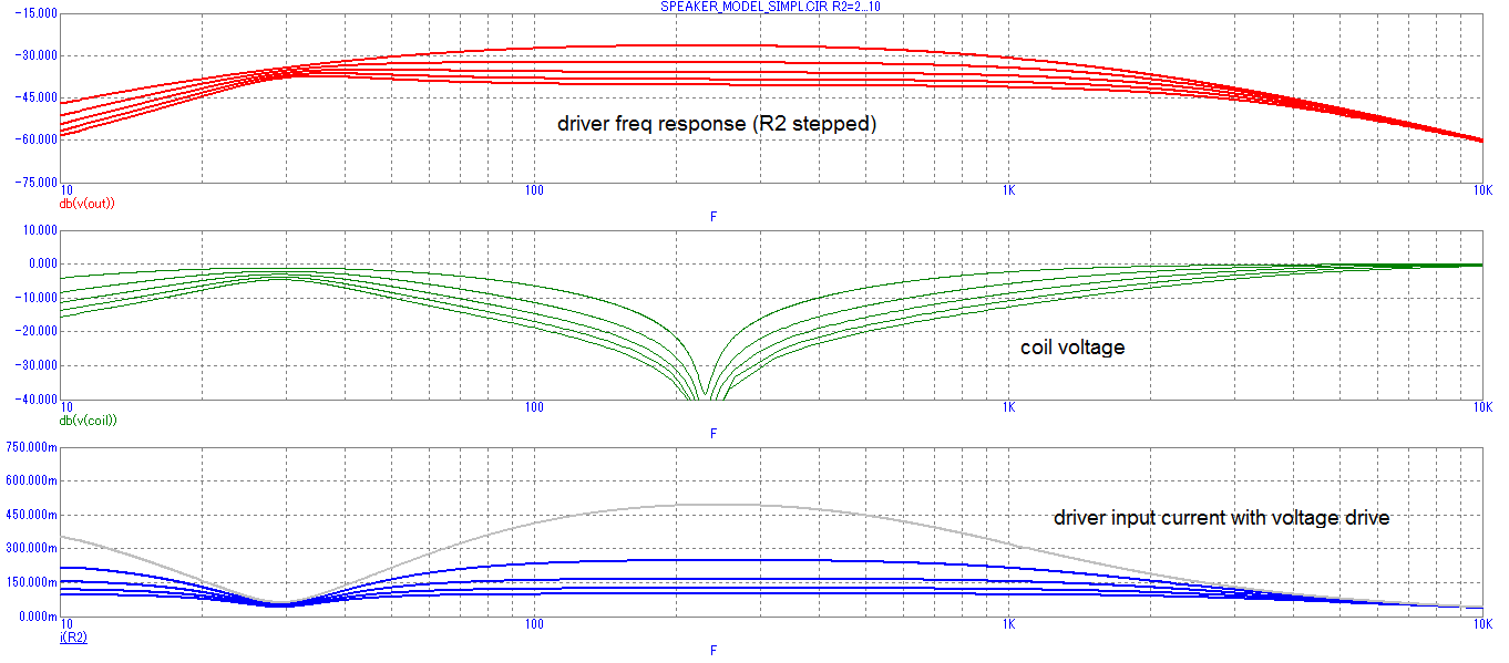

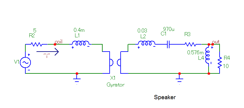

When the coil is blocked (glued in) we'll see the pure electrical part of the transformer action (likely quite position dependant). With moving coil the velocity pickup adds in and it is difficult to seperate both.I think it is a transformer. If you imagine a lumped scheme of the driver, only voltage that would appear on Le is transformed to a coupled coil. Voltage across Re and resonant circuit is ignored. I will try in Microcap.
The MicroCap simulation result for driver frequency response (acoustical) and driver current and coil (+ gyrator) voltage.

Connect it exactly as per the schematic. Connect the coils at the "top". Drive the primary coil, and look at the difference between coils.
The plot should show the losses.

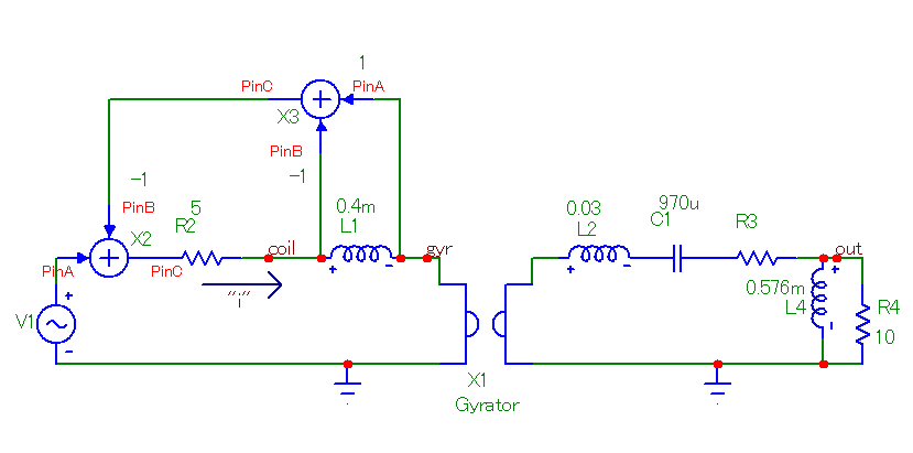

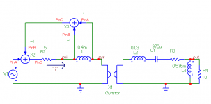

Are you suggesting a compensation like this?
I had to look up a gyrator. The last time I used microcap was about 22 years ago, I do not recall if it had one at the time, I know I never used it.
The non reciprocal nature is interesting, it does seem to accurately portray energy dissipated.
So, it does look consistent with what I am thinking.

In electric-mechanical lumped speaker circuit, the gyrator is used, as a standard, to allow electric-mechanical transformation, force = voltage, velocity = current, mass = inductance, compliance = capacitance, resistance = resistance. Serial = parallel. Bl is the gyrator constant.
