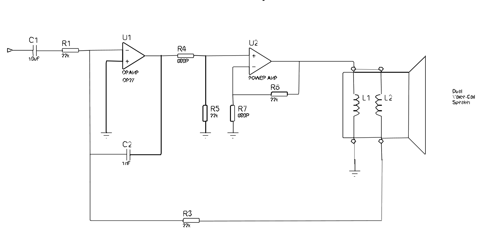

More like this :Like this?
Is the name still correct? It seems it feedbacks more/else than the location/motion?
Exactly like that. And yes, the name was not accurate.Like this?

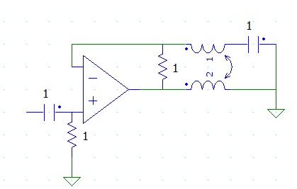

DVC drivers with bifilar VC wire have a nice use case in a balanced Birt bridge to extract the microphonic voltage ("back-EMF") which is a velocitity signal (in order to build a control loop with it). The Birt brigde uses a servo to adjust one leg of the bridge to servo out "DC" resistance changes of the VC (thermally induced). With a DVC driver the input voltage to this servo is already pretty much free of AC components, no need to filter the signal big time, a real advantage especially when long time constants would be needed otherwise. Output of the control loop amp should be current in order to revert to current drive once loop gain drops below 0dB.
Of course, like any bridge it lives of off the perfect matching of the bridge which is the hard/impossible part when the static VC impedance isn't constant (vs. excursion). Using the VC as its own velocity sensor also is compromised as soon as BL(x) isn't constant anymore, or anything that affects induced motional voltage for that matter. Overload behaviour must be well checked, the might be a lot of cone movement overshoot. Underhung VC works best, low eddy currents as well (slotted pole-piece etc), and avoid excursion overload. @Soundbloke told us, before....
This is not being used to extract the velocity signal. Because, inductive non linearities will distort the velocity signal being measured.
Rather, this is subtracting all reactance components directly at the transducer geometrically, leaving only the real component. It's better than trying to use a DSP to get the real part, as calculations would require knowing the history of motion to calculate the non linearities. Using the second vc, the calculations are already done for you in real time as is the subtraction.
I suspect this setup will flatten the speaker response as well as flatten the phase, in addition to lowering distortion.
Worth a try, no?
jn
ps. In essence, it it trying to make the real component of the speaker an accurate duplicate of the input signal. It really is a current drive signal, but it ignores the non linearities of the vc transfer function. In a pure current drive, there is no accounting for the non linearities, the assumption is that all the current is being used to push the vc by BLI. When the vc inductance is changing, that inductance has to be charged so will steal some of the energy as inductance rises, and gets it back when the inductance drops...you know, the second part of E = LdI/dt + I dL/dt. It is that varying inductance that modulates the vc force, and the second coil actually reads that changing inductance because it is coupled intimately to the time varying flux component responsible for that portion.
On the plus side, you can look at exactly what the amplifier needs to drive the speaker. It should be distorted while the acoustic output is not.
(well, that's the theory anyway..). This setup is my version of KISS...keep it simple stupid. If you can do this without dsp or fancy circuits like those mechanical engineer guys did, but get even better results, it is a success.
