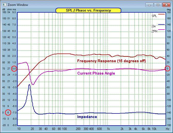

So I thought, what if we actually find out what the current is doing in loudspeakers and then I found something out that goes back five decades and something Neville Thiele did - he used constant current (not exactly the same as current drive) to derive the impedance plot of the driver.
The voltage under those circumstances becomes proportional to the impedance. But the impedance is actually not about the voltage at all, an impedance is about how current is impeded and that the voltage here is proportional to the current. So an impedance graph of a driver that we have all seen, is not about the voltage at all. It is about how it impedes current, that is why we call it an impedance. There is no mention of voltage in an impedance graph.
Then it also dawned on me, the impedance above the Re DC resistance of the voice coil, this is the so-called reactive part of the impedance, produces a zero degree current phase angle when the source impedance is high enough.
BINGO!
It just hit me...
Make the amplifier produce the same current at all frequencies!
You just cancelled out the output impedance.
Try it. It keeps the current phase angle the same throughout - and you no longer rely on the output impedance to control the box alignment and the crossover.
If they want examples, I would love to! Talk about how it works and about how this is about thinking current rather than voltage? Again I would love to. I do it offline all the time, but online is verboten. That is crazy!
Here is how I did it, just look below, they can study how it was done:
Voltage source:
Current source:
Overlay comparison, Green is voltage and Red is current:
Below is a crossover that suppresses the back-EMF impedance of the individual drivers and how then the current is EQ'd as seen directly by the amplifier output terminals.
The heart of it and how it was done - FULLY PUBLISHED:

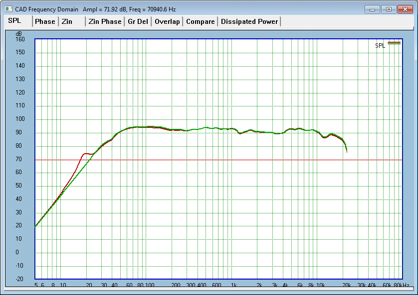

So this is a big advertising campaign for your Elisnore speaker and the fuzz is about a 13 Hz band centered around 18 Hz for 2 dB, 30 dB down?
So, this is a simulation only. And it is single frequency simulation. What happens with actual music?
While the graphs say spl, is that simulated spl?
I notice the sim has 5 db dips, is that good?
What is the distortion like? Your point was distortion stuff, right?
Also, what about transient response?
Jn

Do the wiring diagram incl. notes in the 4th picture describe a physicalrealisation that measures as in picture 1-3?

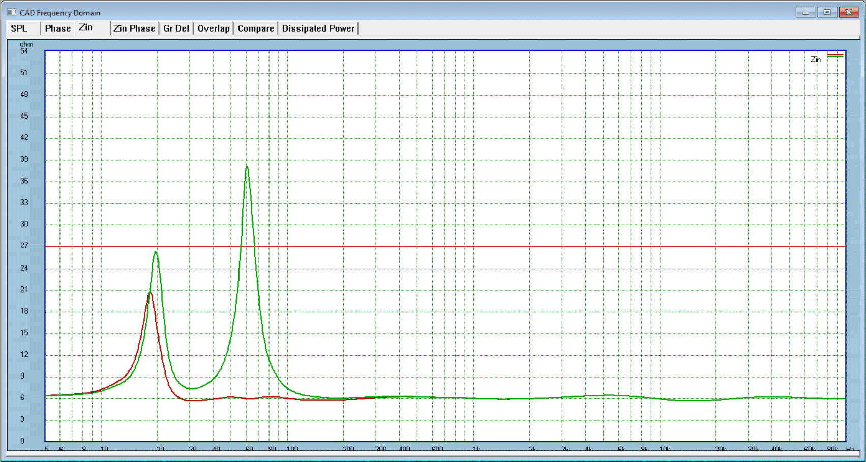

Re the 18 Hertz deviation under current drive versus voltage drive, may I respectfully ask if we could have a respectful interchange about that.
I would very much appreciate it. The blip only occurs when the box is vented. It does not exist when sealed or aperiodic alignments are used. But could it be eliminated in vented as well. It could, but it has been closely examined and not considered practical and the gain not significant. No matter how hard it was tried to trigger it into errant behaviour, it works as is.
Besides, a high number of people building Elsinores use tube amps with typically 3 Ohm or higher output impedances. I don't know of anybody using a transconductance amplifier, but I have one and can demonstrate it at any time and with low frequency content music. The alignment is very solid indeed. So any amplifier can be used.

Edit: See attachments, it helps explain above.
