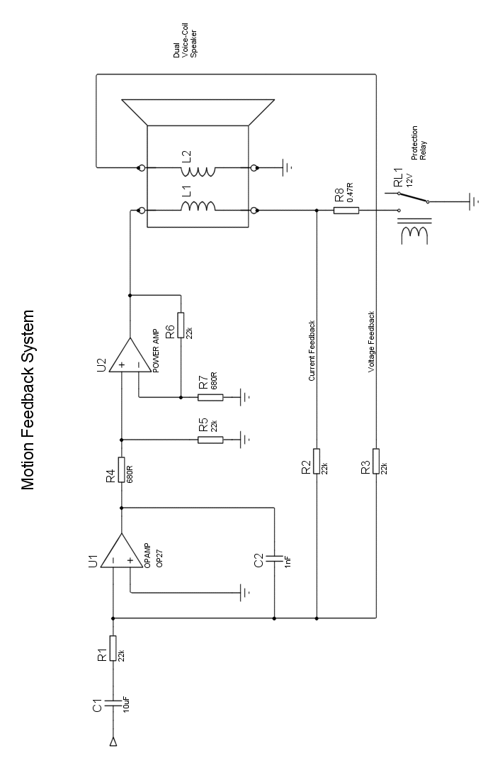

The Kii3 has current drive, but not as anyone knows it. They use the resistor as feedback sensing driving a wad of DSP. They also have std voltage sensing, and for the woofers motional feedback. So with voltage AND current AND position AND look ahead monitoring of the signal they can make the most of it.

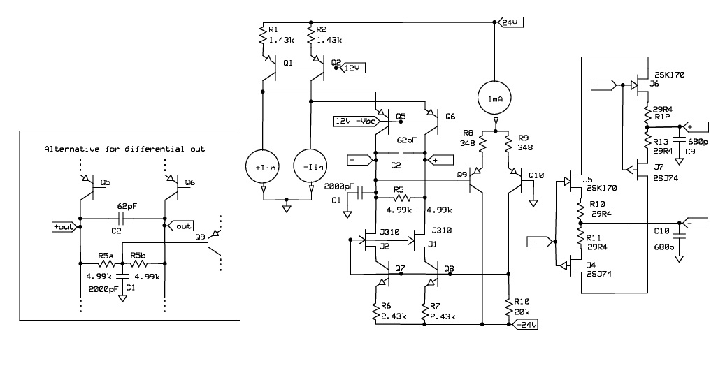

The first IC instrumentation amplifiers were based on open-loop current transfer. I realized that I could get almost all the same functionality out of same simple folded cascode with common mode feedback discrete circuit that I used for my RIAA.
In-amps using open-loop current transfer have some nice features like fairly constant BW vs. closed-loop gain and nearly complete common mode rejection at the input. Typically the IC versions were based on a 100K trans-resistance which made them too noisy for audio (they were never intended for audio anyway). To this day they have been replaced by continually improving versions of the Demrow data amplifier (1968). There are versions of this circuit designed specifically for audio like the SSM2219 and THAT1512. The main issue here is getting low enough noise at low gains since a line stage typically would be at 20dB or so max.
The in-amp consists of a differential input V to I converter with transconductance set by a resistor and an output differential I to V converter. The input stage lends itself to variants which could be discussed later, but here is the output I to V. The little trick (inset) is that by simple jumper the output becomes differential or single ended depending on where you connect the comp cap and the base of Q9. You could also use the base of Q10 as a remote ground sense just as in a typical IA (I think ��). If you look carefully and you don’t load the outputs of the I to V converter you will see that the common mode loop does virtually no work in either connection, so it has little or no effect on the signal path (IMO). If you want, you could substitute a PFET pair with no degeneration. WARNING use of some PFET’s might require attention to breakdown issues or use of additional supply rails. As usual I would make the appropriate current sources trimmable for RTI and RTO offset and forgo device matching except at the grossest level.
Using 10K as transresistance I was surprised how close in noise performance to the IC’s I got. The output is capable of 7V rms and even with a simple degenerated (1k Ohm = ~20dB gain) JFET pair at the input the distortion at this output level is ~-76dB and much less at 2V rms line level (all sims). The output resistance is 10K, so you need to buffer it. Since the input is FET based, you can move the source follower buffers of your choice to this stage. The JFET cascodes are a precaution against possible thermals that you might get especially using discretes in SOIC.
I’ve done some sims using Bob Cordell’s models of common inexpensive bi-polars and have not found big problems. Please remember this is for entertainment, “Muntzing” if you will, and seeing how well simple circuits can be made to perform. More later.

Scott,
If it is for Vin and Vout, would a Blowtorch like topology not does the same thing but simpler ? (One can of course replace the 4 resistors of the folded cascode with CCS's.)
And for the full differential version, have you try leaving out C1 (in simulations) ? You might find that single phase outputs have lower even harmonics. Afterall you did not use C1 in your phono pre.
Unless of course you want to use it with current input, then ignore what I just said.
Patrick
