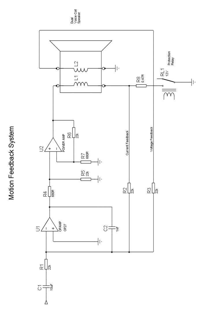

Has this been simulated?
Seems clean. I'll take a better look at it tomorrow, when I can turn the schematic 90 degrees. Now, I have a crick in my neck....
I was thinking voltage drive, and using the difference between the 2 vc's in some fashion taking advantage of the direct measurement of the real component of dissipation.
I was thinking of integrating the output voltage in the normal servo manner for dc offset, but using the second coil for the fb.

Oh, now I see.
You already have my Spice files.
How else can I help ? PCBs ?
Your suggestions for changes are enough. I need to get back in my own lab to make any circuits and measure some results.

No, I just realized what to do.
Remove the current feedback of the .47 R. Tie the coil 1 bottom to ground. Tie the coil 2 top to the coil 1 top. Use the bottom of coil 2 as the feedback.
Coil 2 is picking up all the reactance of the speaker and none of the IR drop. tied as I just said, the coil 2 bottom will present only the real component of the speaker voltage back to the amplifier. Any variation in coil inductance will affect both coils exactly the same, so the difference will not have any consequences due to system inductance or system reactive non linearities. In fact, if you drive this arrangement with a crossover inductor between the amp and the speaker terminal, this feedback system will ignore the inductance and compensate for it, rending the crossover inductor useless until the amp runs out of voltage compliance. Needless to say it completely compensates for vc inductance changes due to position within the gap, totally eliminating the need for a shorting ring. The only cost is a slight increased need for amplifier voltage..so what.
The transfer function will now be entirely dependent on the resistive component of the speaker, the summation of the coil resistance and the effective resistance of the real part of the energy transferred to the air. The coil resistance will be fairly stable, so in essence, this feedback looks at the delivered acoustic energy signal. If you wanted, you could add some DSP to look at the dc resistance of the driven coil and compensate for compression.
Attempting to measure the amplifier output node in this setup for distortion will be entirely useless. The output node will be compensating for any non linearities in the magnetics.
The only way to measure this system for distortion is to use a microphone...
To make the voice coil, do not use the same gauge wire for the drive coil and the feedback coil. Use a smaller gauge wire for the feedback coil. Use a sufficiently small gauge that the feedback coil will nest in the interstitial voids of the drive coil. (yes, this only works with round conductors). This will minimize the added mass of the pickup coil, provides an automatic nesting and exact same turns ratio, and does not increase the voice coil thickness. It will however, see the exact same magnetic system that the drive coil sees. If you use a dual vc speaker that is front to back coils, each coil will see different non linearities and the method I describe will be useless.
There will be some inter-coil capacitive pickup, but because most of the voltage derived will be inductive, the two wires will almost have the same voltage, especially if the conversion efficiency of the driver is in the 1 to 2 percent range. That reduces the effect of capacitive coupling.
This method is not bandwidth limited per se, it would be fun if someone would put it together for a spin.

yes, I believe there are dual VC drivers which are also double layer and bifilar wound. Those can be tried first to see how well it works on a first cut.
