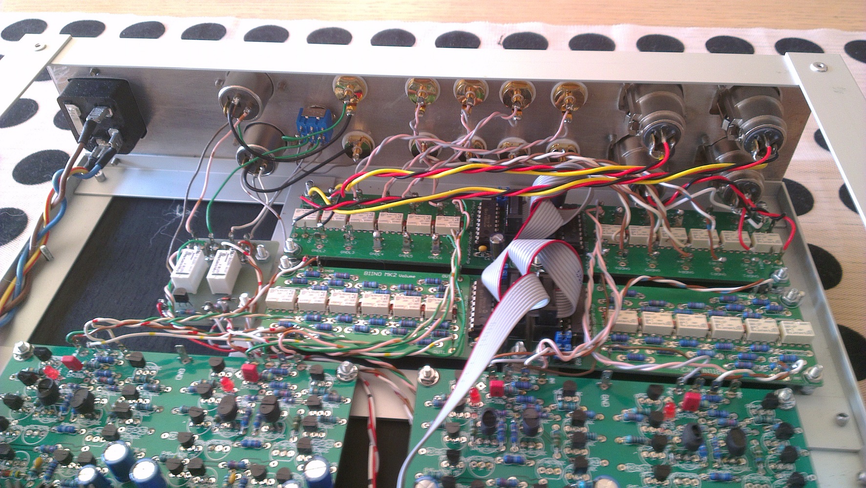

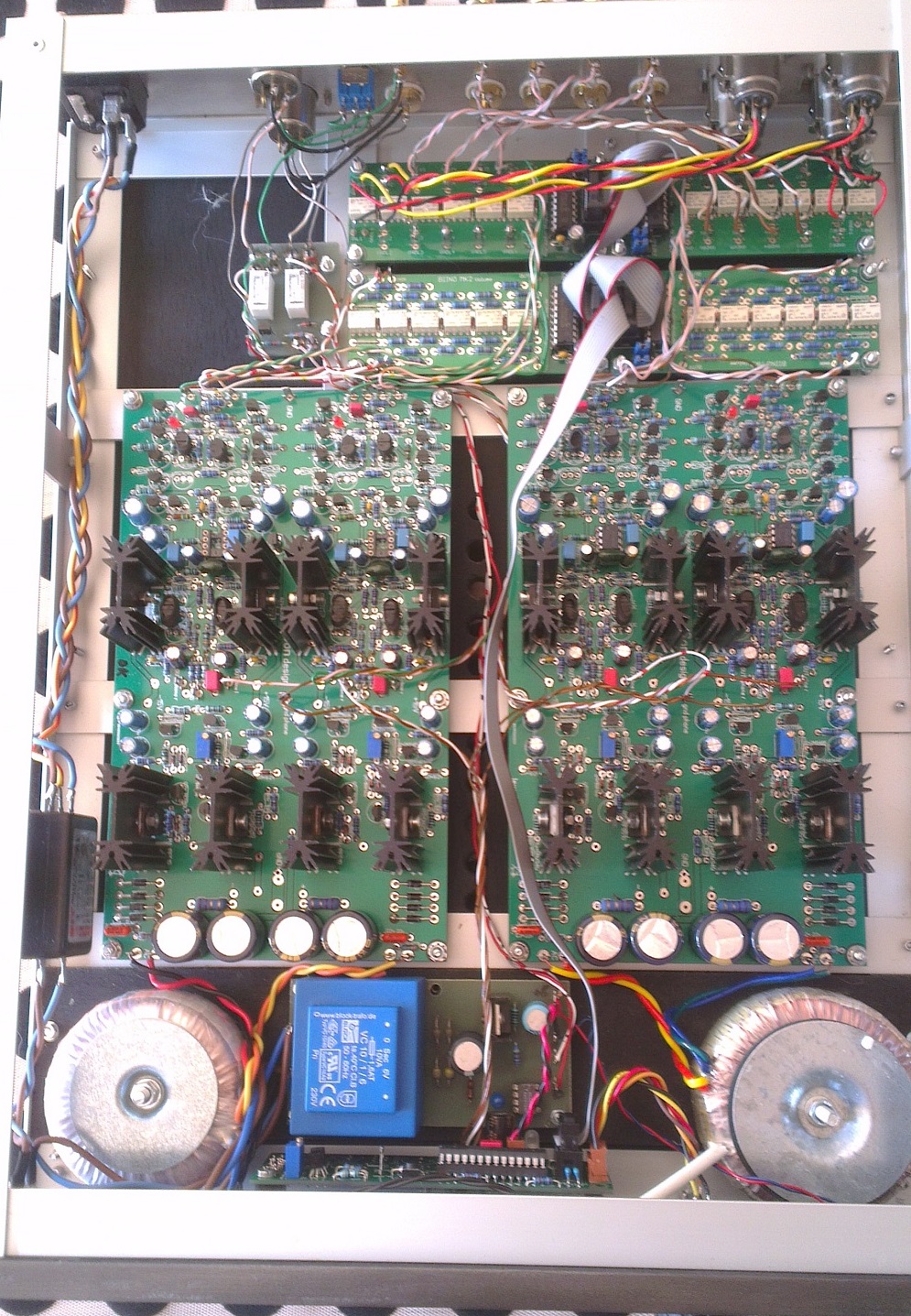

Thank you Howie, not much documentation has been left. I found one photo of the inside.
Power supply was in a separate Al box, in fact 2 power supplies one for each channel. Input BNC's were connected directly to the metal case to minimize RFI input.
Nice layout, I am a sucker for symmetry, but if the right and left channel PCBs are not mirror images, won't that invert one channel? (JK)

Your designs should be in production, I was really impressed by the preamp cards I got from you! I do note your unbalanced output have the shell isolated from the chassis...
Howie
Thank you Howie, this would be a full-time job then and audio has always rather been my hobby than a job to make a living. It is really difficult to start real and successful production.

Wow, that's a lot of good work, Damir! I have to admit that I do not prefer unshielded signal wires inside the box, for the reason of measurable pick-up of RFI/HF induced voltages.
Thank you Pavel, I could change some wiring for shielded in the future, for now I don't have problem with RFI/HF pickup. Input impedance is fixed 10k and output impedance is very low.
Damir, give it a try with a fast scope (>100MHz) at high sensitivity, like 2mV/div, or a HF spectrum analyzer. IME it is impossible not to see the difference when changing from unshielded wires to well shielded coax. cables, like RG-179. Not only outside-box fields are a source of HF pollution, but also power supplies inside the box, or digital circuits of any kind, if used. I have not understood, by now, why audio designers use unshielded, bare wires.
