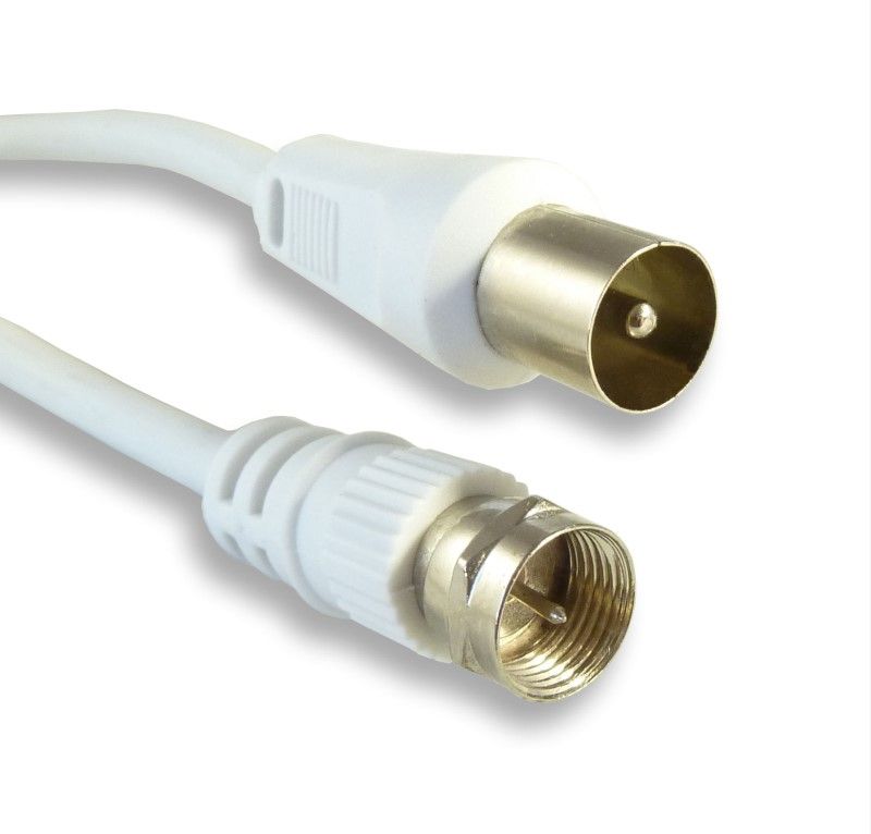

Actually, you make an interesting point, 20to20. I have always been confused with the 'smooth' F connector and an RCA. I guess it is just the 'male' that is really similar, but it is confusing. I would have to look carefully as to how they achieve 75 ohms, where no NORMAL RCA connector will.

That was my point, a 75 ohm F connector for typical VHF coax antenna input isn't called an RCA jack. In your earlier post you seem to be confusing UHF impedance matching with VHF impedance matching with RCA connector impedance matching. Your reference to UHF tuner output via RCA plug connectors as being 75R, doesn't take into consideration that the tuner has done the demodulation and is outputing composite signal that can be carried OK with standard cable with an RCA plug and jack. The connector itself is not the determinant of the impedance rating of the circuit, the input to the following amps is. You can put an RCA connector on a 75R coax cable but its not the connector that makes it 75R. So there really is no 75R RCA to ponder.

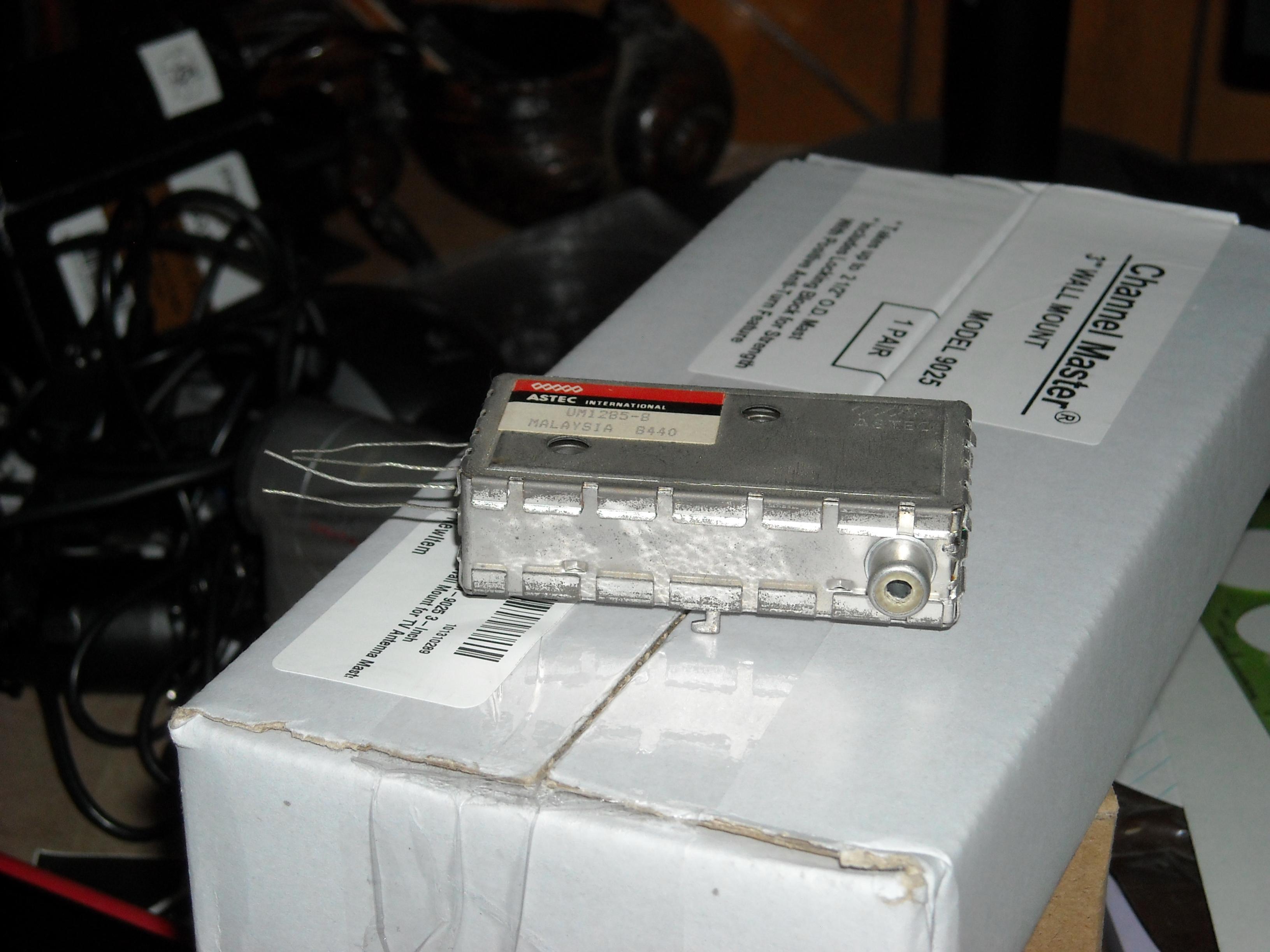

They originated in RCA TVs connecting the UHV/VHF tuners in vacuum tube TVs to take the output of the tuner to the main RF amp and IF stages.
Here is a more recent example of an RF modulator from ASTEC using the RCA for RF out.
Yes, with that modulator in a device generating the video the other end of that RCA plug on a 75R cable would likely have a female F-connector on the other end for an output connection for a coax to TV channel 3-4 VHF input. And everyone's happy. The technician doesn't have to solder/unsolder the cable to swap out a failed unit.
