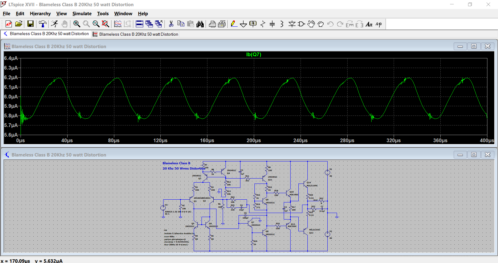

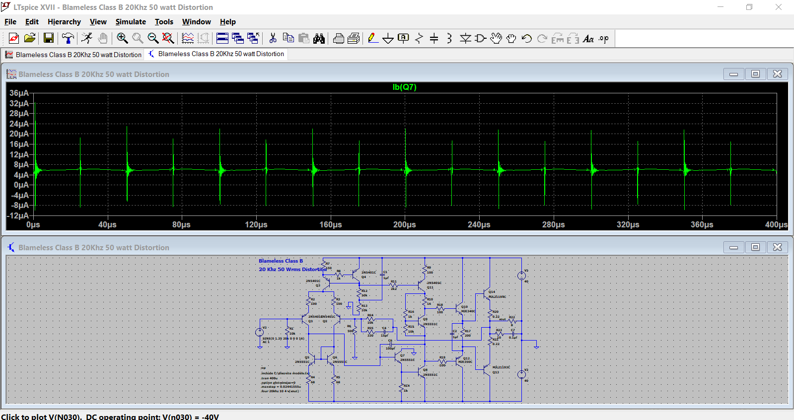

Why do we see this kind of behaviour on so many respected designs ? Is it real or is it just an artefact of the simulation. Even Doug Selfs 'Blameless' does this and this effect happens across a whole range of designs. These images show the base current to the VAS stage.
Any ideas anyone ?
If the quiescent current is reduced the effect becomes very pronounced and yet the main amplifier output remains unaffected by all this. What is the mechanism for this.
Any ideas anyone ?
