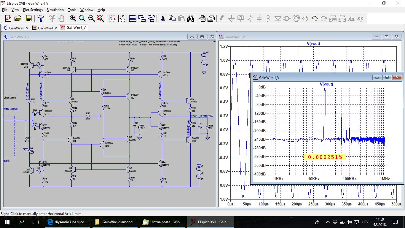

If one wants to use jfets in preamps or I/V converters it means for sure that is going to be expensive exoteric equipment. Unobtainable complementary jfets and need for meticulous matching it's main obstacle to get cheap (moneywise) equipment.
Why not to use bjts only and the matching problem solve by using low noise matched quads as THAT340 .
Here is one example of the current to voltage converter suitable for a DAC outputs. It’s non balanced configuration but easily upgraded to balanced one.
The main source of noise are those current to voltage resistors, in this case R19 and R1. Lower the resistor value les nose, but increase in distortion.
And yes, this is non GNFB circuit.
Damir
Damir
