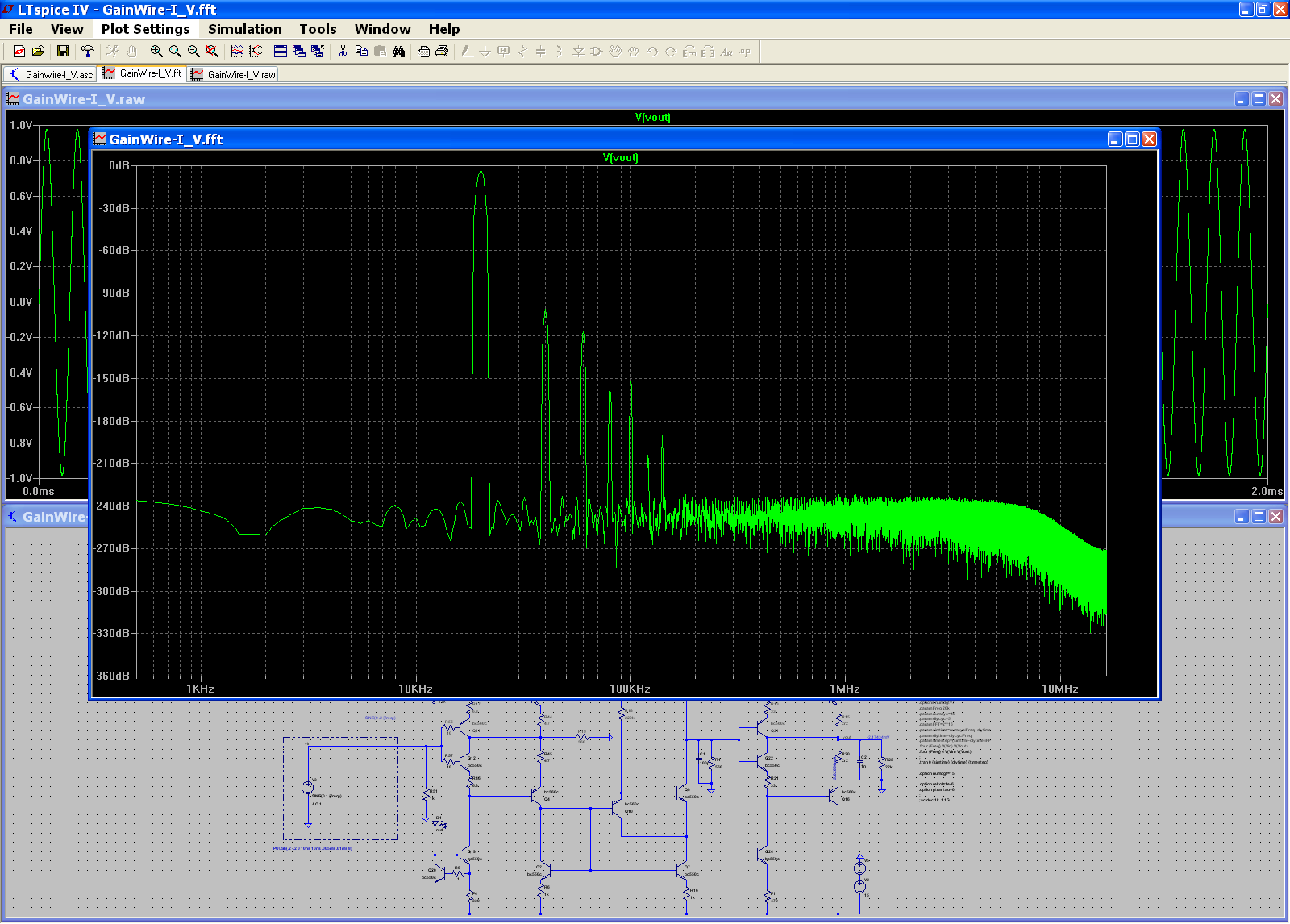

Here is one example of the current to voltage converter suitable for a DAC outputs. It’s non balanced configuration but easily upgraded to balanced one.
The main source of noise are those current to voltage resistors, in this case R19 and R1. Lower the resistor value les nose, but increase in distortion.
And yes, this is non GNFB circuit.

Here is LTspice file if someone wants to plays with it.
Damir

Hi Damir, I know why it goes so, but would have to be "politically incorrect" if I explained that in open English.
Okay, at least I was the one who opened your file. Just let me know if the result is the same as you get.
