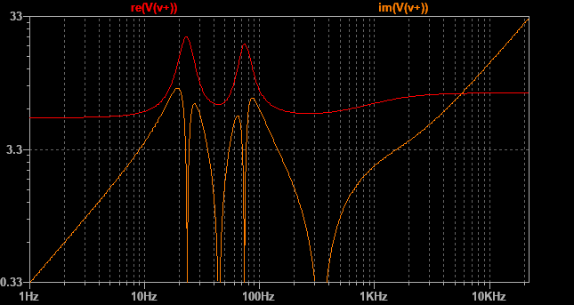

Let's separate the speaker impedance into cartesian reactance and resistance rather than polar magnitude and phase.
Red line is resistance, orange is reactance.
Joe, are you saying the signal through the cartesian resistance is related to SPL, or do you mean only the signal through the wire resistance of the voicecoil?

I'm sorry but you seem to confuse a thing here.Look at the double-graph, take any frequency and note that any part of the impedance above Re 6 Ohm is caused by some kind of back-EMF, motional, inductive and microphonice - all the deviations of the impedance impugning the current is above the Re value of the driver.
The only deviation from flat in the impedance plot that is caused by back-emf (microphonic voltage) is at/around the peak at the resonance frequency. For constant SPL (= acceleration) velocity falls with 1/f so higher frequencies produce little back-emf. The rise at HF in the plot is from static voice coil inductance. The caption in the graph is plain wrong.
It remains true that high impedance drive gives an SPL increase over low impedance drive at the frequencies where the total impedance, static + dynamic (back-emf-induced), is high because the voltage rises (SPL increase is as proportional to terminal voltage as it is to current). This is sort of trivial, though, it's true for any network not only speakers.
As for listening comparisons, I found them useless when the small signal frequency response isn't carefully EQ'd to be the same (+-0.1dB) when changing drive impedance. With tools like Acourate or LSPcad this is done easily (maybe even REW+RePhase, didn't check that). Then you can find changes in the sonic fine-print quite easily, both by listening and by measuring.
