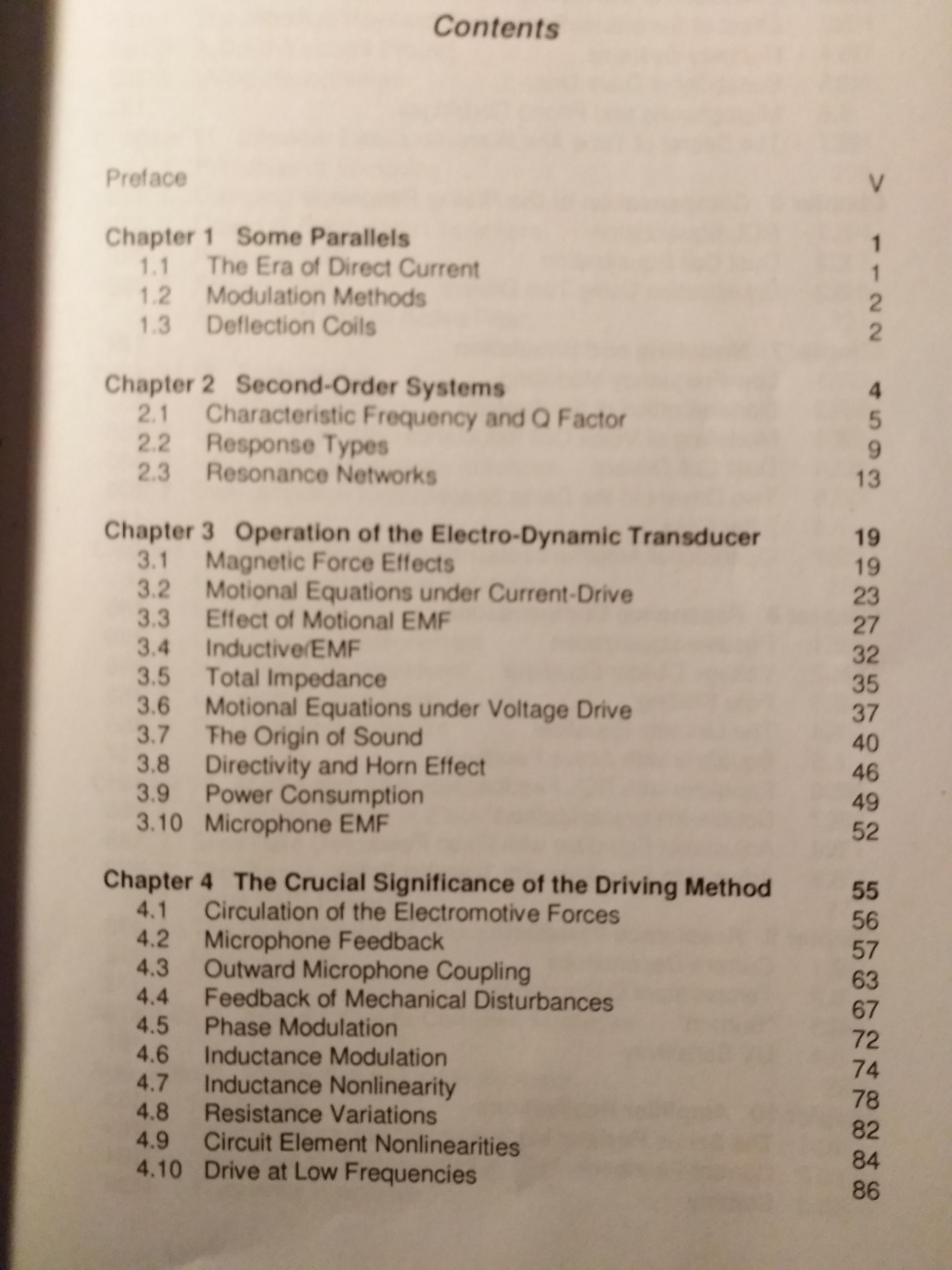

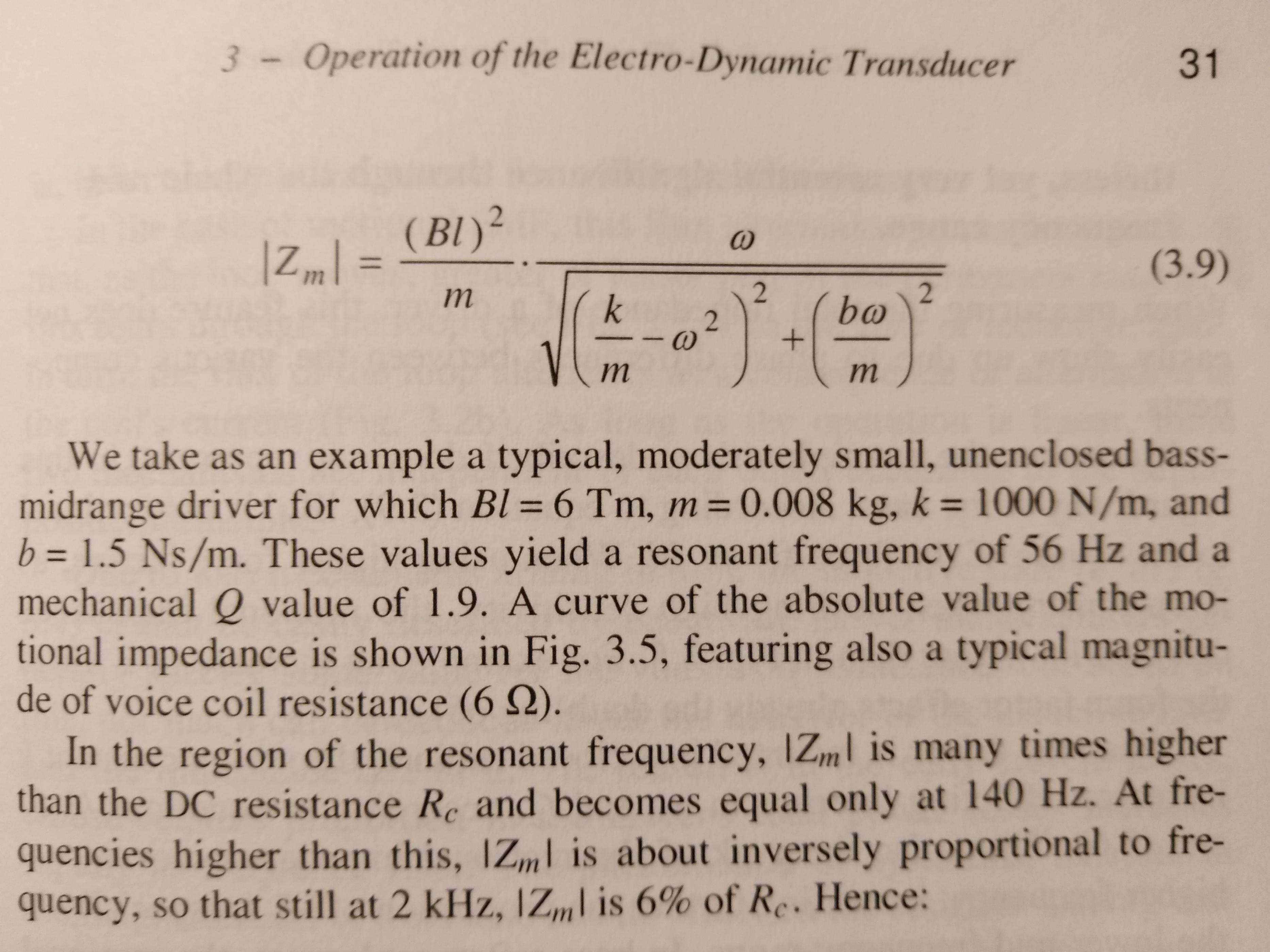

I have Merilainen's Current-Driving of Loudspeakers and although he's pro I, he does give some good summaries that would help get people on the same page:
I could post some summaries and equation/graph screenshots.
