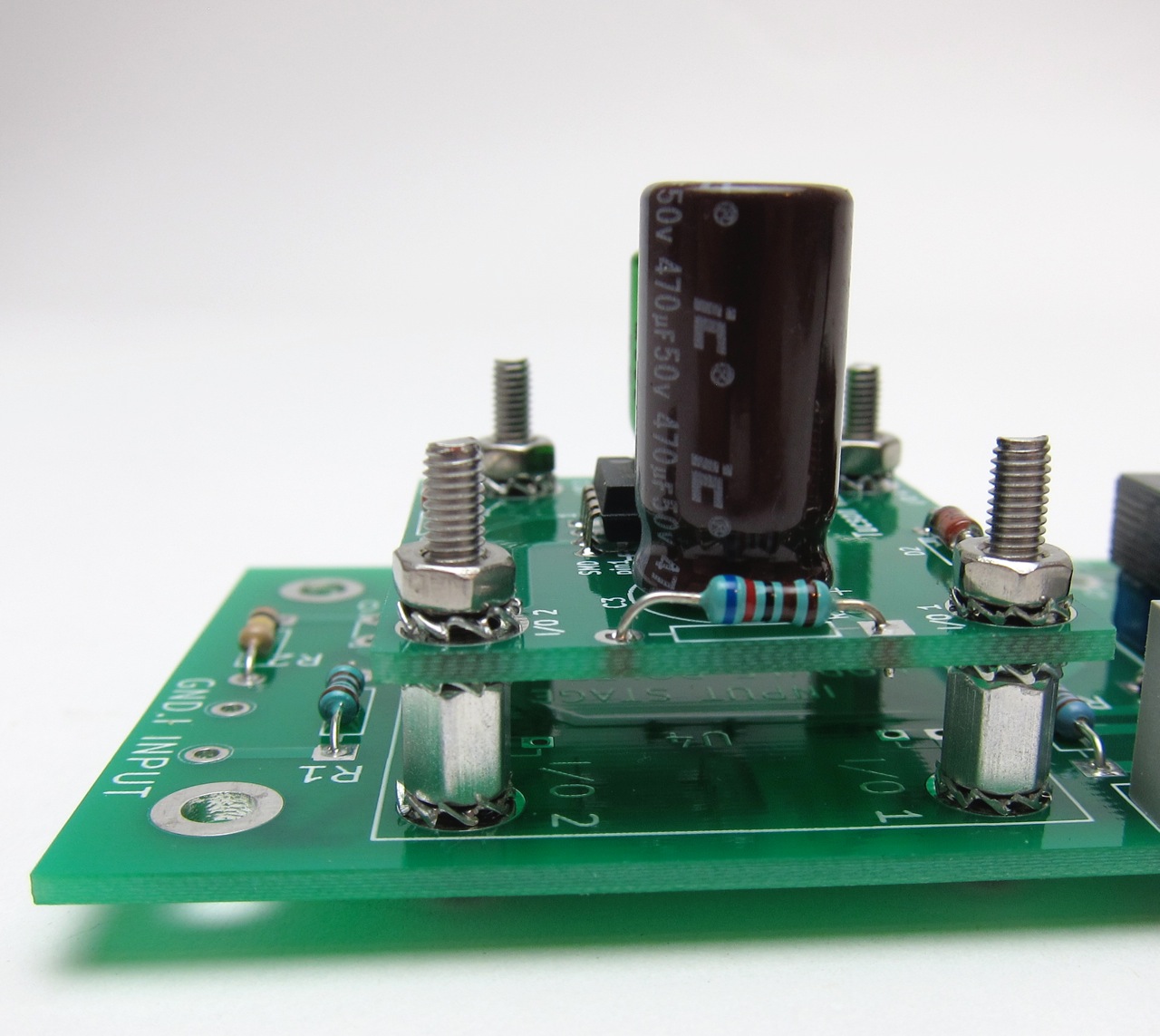

I'm using metric M3 bolts and nuts and star washers for audio. 4 bolts and 4 electrical nodes --> input, output, posrail, negrail. It makes sense, at least to me. (link)
_

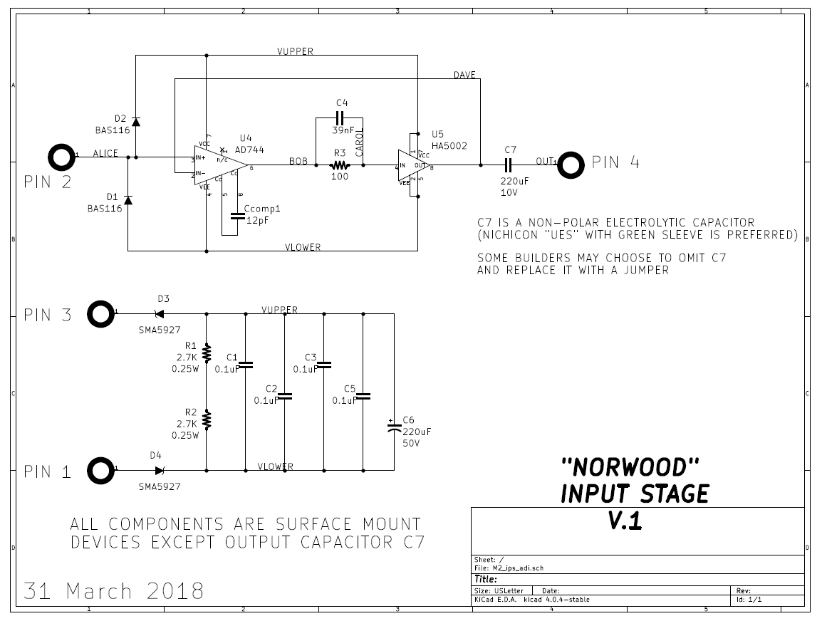

You should see his first attempt at the all-SMD board that includes a Scott Wurcer-designed SOIC_8 chip: Oy vey!
Here's the amplifier (designed by Nelson Pass: look Ma, no feedback!) and also the Scott-Wurcer-IC-input-stage (designed by me: muchas feedback). It is the latter schematic which is implemented on a daughterboard that uses M3 bolts to make electrical connection to the motherboard. The bolts are actual "components" on the motherboard schematic, complete with "symbols" and everything. Shazam!

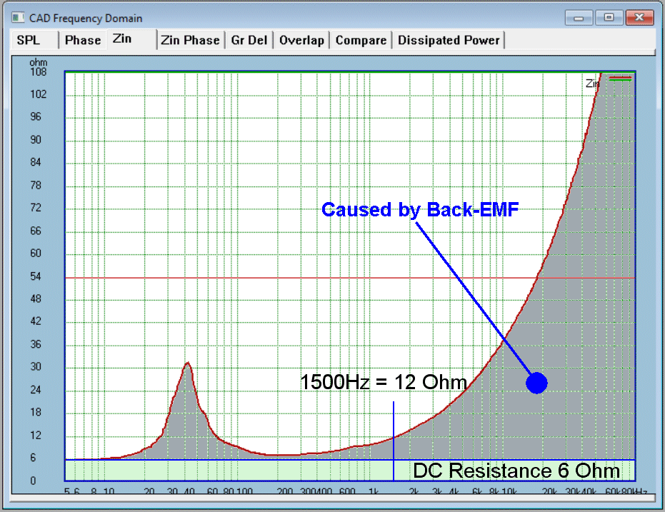

My take is Joe calls any temporary energy storage in a reactive component "back-emf" when it is given back to the system. With deference to George's comment I could get past these eccentricities if there was a consistent story that did not violate first principles.
He is also not entirely wrong. The voltage developed across an inductor when the current through it changes is sometimes referred to as "back EMF", though usually as "induced EMF". However he wants to lump everything except voice coil resistance together and call it "back EMF", which just confuses people and obscures his meaning. "Reactance" isn't that difficult a concept and is mathematically well defined.

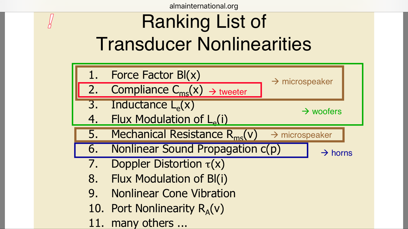

This seems relevant:http://www.daytonaudio.com/media/resources/290-226-dayton-audio-nd91-8-klippel-test-results.pdf
Still not sure about the Bl(i) linearity of an air coil motor though... I thought Jneutron said something about that in the past?
Those were great links, thank you.
It is good to see klipple agreed with me on the inductance changes as the coil extended forward vs reverse. I think that is excellent work (despite the fact that it is in total agreement with me (as non biased as that could be😀)).
I would like to see that chart extended to detail how eddy losses come in as real components disguised as vc pure resistance, and they should look at flux dragging as well.
What do you mean about the Bl(i) non linearity of an air coil motor? Are you thinking about the issue of magnetic permeability vs flux?
Is klipple a person? I would love to discuss this stuff with him/her/them if it were possible.

I can understand how Bl(anything) isn't completely cured by current drive, but I'm trying to figure out if i changes Bl in a way that wouldn't also apply to an air coil motor. Or maybe it does apply to an air coil motor. In which case we appear to be screwed. 😕
Even if Bl changes linearly with i, it is still distorting because of the i*i term Klippel mentions. So there is no need for modulated permeability to show that this is nonlinear. I don't see how this would not apply if the magnet were an air coil.
If I am correct, the only solution is to short out the flux modulation through the magnet with a shorting ring. Or... Perhaps a hall sensor. But that scares me.
