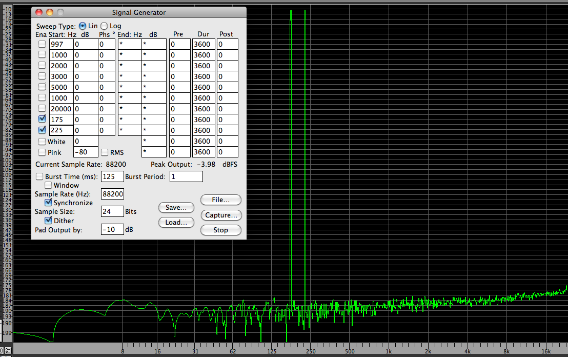

Nope. Nothing's there. (175Hz and 225Hz mixed).
You do realize there is a time domain, no?
Jn
Again, just because something looks like what might be loosely referred to as a 20kHz waveform does not mean that there is strictly a frequency there. Likewise, seeing a spiritual figure in grilled cheese sandwich does not mean there is an actual figure of any type there. Both it and your 20kHz signal are products of human visual perception.
Nice. From Nyquist denier, to Fourier denier, quite an evolution in two weeks.
Hint: the Fourier transform is a bijective transformation between two function spaces L(R^p,q), easy to prove the injectiveness and surjectiveness of the direct and reverse Fourier transforms. Therefore, for each signal there is a unique spectrum, and the other way around. No exceptions, even for time/bandwidth limitations.
Again, just because something looks like what might be loosely called a 20kHz waveform, does not mean that there is strictly a frequency there. Just as seeing a spiritual figure in grilled cheese sandwich does not mean there is an actual figure of any type there. Both it and your 20kHz signal are products of human visual perception.
The use of continuous sines and large windows guarantees the results he is showing.
That will not be what happens with short bursts. Just go back and look at my PSP analysis. Han's started with 20khz, ended up with 17.5 kHz.
Throwing up simulations which are entirely different is strawmanish.
Jn
